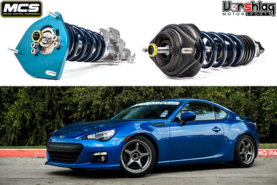

We also sell MCS coilovers for the S197 Mustang, and in fact we have the first TT1 set in stock that we had built to our specs. All we lack is a tester to buy this set, then let us photograph, install and measure all of the parameters we like to check on a brand new suspension option like this. We've done installs on MCS RR2 doubles with remotes and TT1 singles on other cars, just have get a Mustang buyer to let us install a set for the S197 chassis.

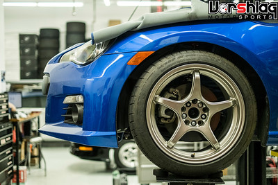

Fitting the custom built set of MCS TT1 shocks to a tester's BRZ, sans springs, for bump/rebound measurements
We need someone local with an S197 that street drives + tracks or autocrosses their Mustang to sign up as a Vorshlag Tester for this first MCS TT1 set we had built. This would include a discounted install at our shop, a free corner-balance, and hands-on set-up help at a local autocross or track event(s). Go to the recently updated Vorshlag Tester Page, read the Tester Expectations, and if it sounds like a fit, sign up to be a tester via the method shown on that page. Don't call, or shoot me a PM, or send a fax, or wire us a telegram, but instead follow the instructions on that page to sign up. :) If your criteria line up with ours, we can get the MCS TT1 installation pictures for the S197 chassis. This would be another great monotube offering we can provide for this chassis (to go along with the offerings we have from Bilstein, Moton and AST). The MCS units are a bit unique in that they only have a 2 to 3 week lead time, are modular and can be upgraded to doubles or with remotes, and the have very beefy internals, shafts and housings.

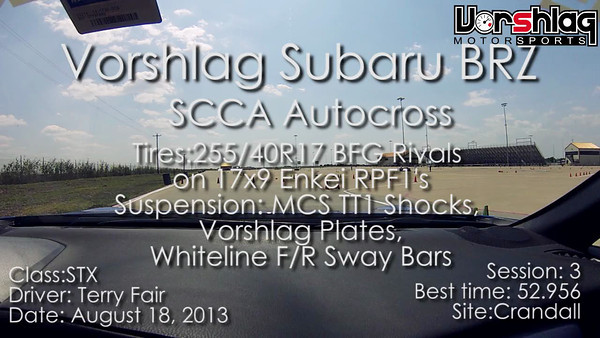

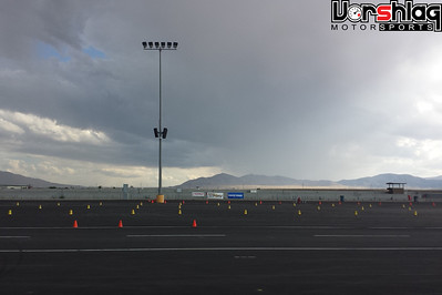

SCCA Autox at Crandall, August 18, 2013 - STX vs STU?
So we decided to enter this autocross after we installed the MCS TT1 coilovers on Matt's 2013 Subaru BRZ. This car has been waiting on proper coilovers for almost a year, and after a few fits and starts we finally got a high end, adjustable monotube coilover on the car that was made to the specs we wanted. Working with MCS has been easy and we've installed and sold a good number of their singles (TT1), internal doubles (TT2) and doubles with remotes (RR2) onto our various customer cars.
You can read more about the BRZ project here, but the plan quickly became to drive this car in its Street Touring class (STX) at the same event as two S197s we brought and ran in STU. Amy drove our 2013 GT (which is still for sale - hello, is this thing on??) and Mark C drove again his 2012 GT in STU class, so we could compare times against each other and against the other STU and STX cars in attendance. There were a number of strong regular competitors in STX cars at this event who ran in other classes for various reasons (mostly time of day choices). Still, it was worth comparing to the top ST cars there, so we will, at the bottom of this post section.

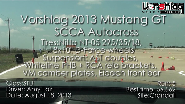

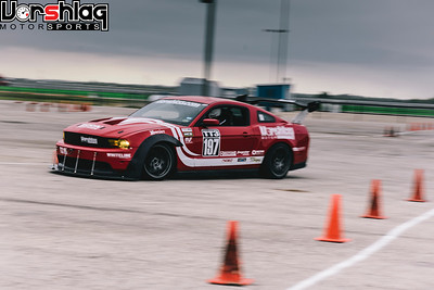

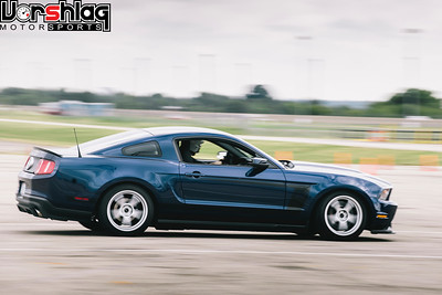

So Amy Fair, my wife, is a 3 time National Champion autocrosser (STU-L twice and ESP-L last year) was running our 2013 Mustang GT in STU. This car is far from under-prepped, and in fact had a couple of "illegal for STU" mods, but this was a good venue to test those things because they were both items we've been asking the STAC/SEB to include for solid axle STU cars. The main suspension items were a $5000 set of AST remote reservoir double adjustable shocks with 400F/200R coilover spring rates.
The 2013 also has a big adjustable Eibach front swaybar, plenty of front camber (VM plates), upgraded and ducted 14" Brembo brakes, and 295/35/18 (10mm wider than allowed in STU - for now) Nitto NT-05s (200 treadwear) on our Vorshlag/D-Force 18x10" wheels. It also has Whiteline rear control arm Relocation brackets (also not yet allowed) plus a Whiteline Adjustable Panhard bar, to center the axle since it is lowered approx. 2 inches. This car had zero power mods, as it already made 377 whp with the bone stock 5.0L Coyote motor - which is too much for 295mm street tires to deal with on TRACK (see above), much less use in thae "knife fight in a phone booth" which is autocross.
Have I mentioned that this car is for sale? Oh, there, I did it again. Somebody is going to come by and drive this car, realize what an amazing deal this is, and buy it. And then rub it in other peoples' faces. :D

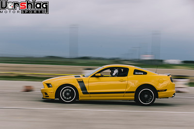

Mark C is a bit newer to autocross (couple of years) but has a solidly prepped car as well, and was running on fresh RS-3 Hankooks in 285/35/18. These felt like they had a good bit more stick than the year-old 295 Nittos on our car, so the extra 10mm was probably a wash, if that. Mark's Mustang was on AST 4150 coilovers, 550F/250R springs, BMR adjustable panhard bar, the same 18x10" wheels with the aforementioned "200" treadwear RS-3s (they used to be 140 treadwear but Hankook asked the Pope to sprinkle holy water on them and viola! they are now 200). It also has a Torsen T-2R aftermarket diff, 14" Brembos, and some other goodies, but also stock power.
SCCA Event Results: http://texasscca.org/2013_solo_resul..._final.htm#STU

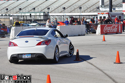

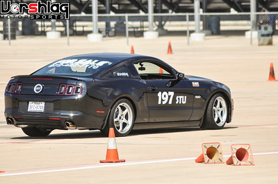

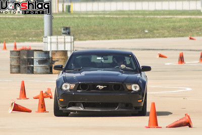

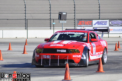

I guess the BRZ was fairly well prepped for STX, too. I figured beforehand that we might give the two STU Mustangs a run for the money, and was hoping just to keep within a second of the fast STX guys that I watch in our region, like Brad Maxcy's BMW 328is and Mark Sipe's RX8.

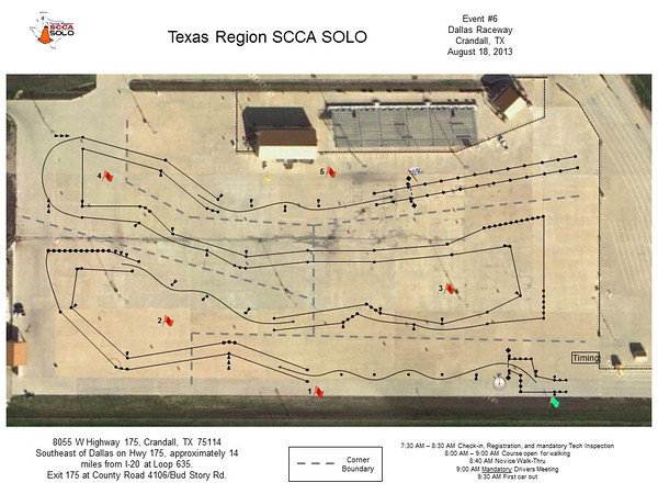

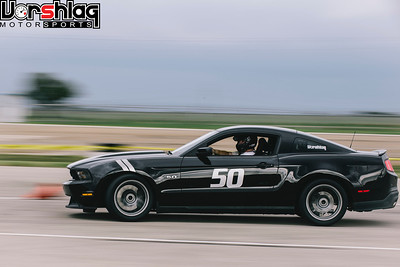

Mark C (STU 150) and Amy (STU 197) ran their 5.0 Mustangs in the first heat of four for the day - which was both good and bad. It was good because the surface temperatures on this concrete lot were lower, as were ambient temps in the morning runs. This meant the tires wouldn't get overheated as quickly - but we still had to spray tires on both cars after runs 2-4. At least the didn't have co-drivers to add to the tire heat. But it was bad because the course surface for first heat wasn't as clean as it gets later. Texas Region SCCA does a phenomenal job in prepping the course, with multiple backpack air blowers and brooms, but nothing replaces car tires scrubbing the surface clean. And the course was a bit tricky. It was long, with a LOT of slaloms and near-offsets, perfect for narrow cars - more of what I call a "Miata-centric" course, which we see a lot since the course designer drives a Miata (love ya JJ!). It also had three increasingly tight 180° turn-arounds that joined long-ish acceleration zones. This was AWD heaven.
Walking it I could see the two STU Mustangs probably having trouble with corner exit traction compared to the AWD cars in their class, as the exits from each major "slow down element" (the three turn-arounds) were pinched off (aka: decreasing) and not what these cars need to "excel". The tightness of the 180s were also going to be tough to navigate in these big cars, as were the slaloms. But the BRZ on 17x9" wheels and brand new 255/40/18 BFG Rivals was almost as wide, at a measured 71" outer track width. So it might struggle through the slaloms, too.
It turned out to NOT be the case for the BRZ. This car was eating up the slaloms! In the video linked above (which has horrible audio, thanks to a previous gen GoPro HD camera) is my best run in the BRZ. It was a GRIP BUGGY, and at 2700 pounds with 255 Rivals, excellent shocks and great camber, I guess it should be. My first run in the BRZ absolutely obliterated both STU Mustangs. Now I did run in heat 4, so the course surface was cleaner. But it was also 90°F, so it was hotter when a ran, too. And I was co-driving in a 2-driver car with Matt, and we had to do fast driver changes - we barely had time to spray the tires, switch numbers and reset the seat/wheel between runs, and we had help (thanks, Olof and Mark).
So it looked like Matt's BRZ was pretty quick for having zero testing, at its first ever autocross. We basically threw a bunch of parts at this car, took some guesses at set-up, and went out there and drove it. Of course the parts didn't suck... custom spec'd MCS TT1 coilovers, 450#/in springs, Vorshlag plates, Whiteline bars, Enkei 17x9" RPF-1 wheels (15.8 pounds) and brand new 255/40/17 BFG Rivals. It needs a test day to get the bars, spring rates and other adjustments sorted, but we tweaked shock settings and tire pressures during the event and it felt pretty damned good.
This car was hooked UP on this course. At 2700 pounds the BRZ has a huge weight advantage on the 3600 pound S197s in STU, but with 166 whp it lacks a bit in the "go" department. I beat on that car like a rented mule, launching from the Start at 5500 rpms and taking it to redline several times on course; even using 3rd gear on most of my runs. These cars have relatively low power levels, but it just didn't matter. This is autocross, where WEIGHT WINS. In the end the BRZ was 3.6 seconds faster than Mark or Amy in STU and 1.5 sec faster than the winner in STU. That was shocking, and more than a little depressing. I mean, sure, I knew the BRZ could be faster but not THAT much faster than two well prepped STU S197 5.0 cars.
Matt, the car's owner and a 5 year veteran here at Vorshlag, is still a novice autocrosser yet beat the 30 car Novice class handily in the same BRZ. So I guess we had the car set-up well enough from the start. Co-driving the car with him in the last heat of the day made it tight on driver switchover timing, and the car slowed down on my last 2 runs - we think from both tire and brake pad heat (he had on the OEM pads and I was turning them to goo with my hectic Left Foot Braking). We just could not get the tires cooled down on our last 2 runs.

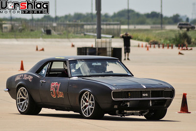

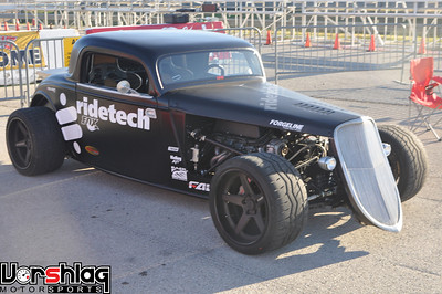

Left: Twin turbo LSx powered 68 Camaro on street tires! Right: 2 liters of naturally aspirated fury pumping out 166 whp. Its no Coyote 5.0.
PAX Results: http://texasscca.org/2013_solo_results/tr13_6_pax.htm
I will be the first to admit that I'm no "momentum" car driver, yet the times still PAX'd 13th out of 121, and won STX class by a 2.5 sec margin. My best run in the BRZ was run #3, still with with a passenger on board (took passengers on runs 1-3, then took runs 4-5 solo), so I know the car had more left in it. I feel that the tires were just a tick too hot, and word is the Rivals do not take extreme heat well - but what does well in Texas summer heat with 2-drivers running back to back? Not a whole lot. Normally you don't want to have a 2-driver car in any class in this kind of heat.
Amy driving the 2013 (at left) in the same 180° corner as Mark in his 2012 (at right).

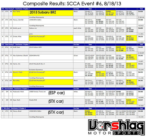

Looking at the results, the two STU Mustangs were bringing up the tail end of their class. It seems that the Mustangs were very close to each other, and in the end Mark beat Amy by .009 sec, which is no small feat. Sure, Amy was coning runs left and right (3 of 5 runs) but her fastest run was clean and on her 5th and final attempt. Maybe her car's tires were past their due date (NT-05s were never that grippy), but she was hustling around that course and stepping on cone bases, cutting good lines. She's been racing since 1993 and often matches or beats my times, but she's a bit rusty in Solo this year. And in case you are wondering, I might guess that.... I might have put a second on her that day in that car, maybe. I almost never beat her by more than that, and we are often in the same tenth (or she beats me) when we co-drive together.
The image above (click or any other it for larger version, as always) is a "composite results" listing I put together of all of the STX & STU cars. I even dragged in some StreetMod and X class entries, that were really STX or ESP cars (but not the entire X or SM classes). Sometimes the online results disappear over time, so I like to make my own copy. This grouping shows all of the cars that matter to the STU Mustang. As you can see there was a good variety of cars in the STU class, including a 2.5L WRX, an EVO X, an E46 M3 (Gaith's car, which we have worked on several times), and the two Mustangs bringing up the rear. STU should be faster than STX, of course, but it doesn't always work out this way.

It looks like my STX winning time was also good enough to top STU and all of the STX cars at the event but one, as Mark Sipe cleaned up some cone trouble with a hero 5th run (running in Street Mod during heat 3) that put almost 9 tenths on the BRZ. He's a damn fast driver and has been racing that RX8 since about 2006, and it is set up well. Maxcy was fast in his well prepped BMW 328is (running in X class) but also had cone trouble and sat on his 1st run. Since he was in X class and they automatically DSQ the 4th and 5th runs (that class only), and he was a bit closer on his 5th run. Madarash's ESP car was smoking fast, and even with the harder SMod factor he just out-placed me in PAX results. After watching all of my runs on video, there was clearly more time in the BRZ than we saw in this first event, with better driving and a developed set-up. As usual I complained more about power than anything, and there are some proven power mods on these cars out now, too.
In the end I think this event was a better test point for the "S197 in STU" idea than the last autocross where Mark and I drove his 2012 GT in two different heats on differing courses (mid-event course change, ugh). The times we see in these results show another piece of data supporting the request allowing more tire on the Mustangs in STU. Even with 295s and $100 worth of "cheater" rear suspension upgrades, it was still lacking. Both Mustangs would have gotten killed in the old STX class, especially running on the skinnier 265mm tires, so I think STU is still the right move for these cars. Of course everyone can always drive better and Mark will only get faster as he gets more seat time and mods on the car, but Amy isn't new to this sport and neither of them brought an un-prepped STU car.

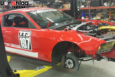

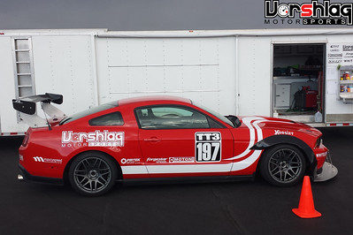

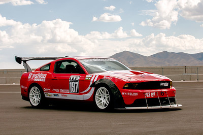

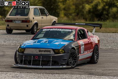

More Aero Prep on TT3 Mustang

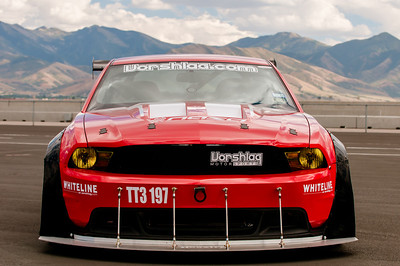

Now for the stuff most of you have been waiting for - if you even bothered to read the autocross bits above, I thank you. Many of you have been watching the progress of our front aero work from the past two weeks on the Vorshlag Facebook page. But for the rest of you, let's catch up from where we left off in the last update, where we were just starting to get the new aero development underway. Don't forget that almost every picture I post can be clicked for a larger rez version.

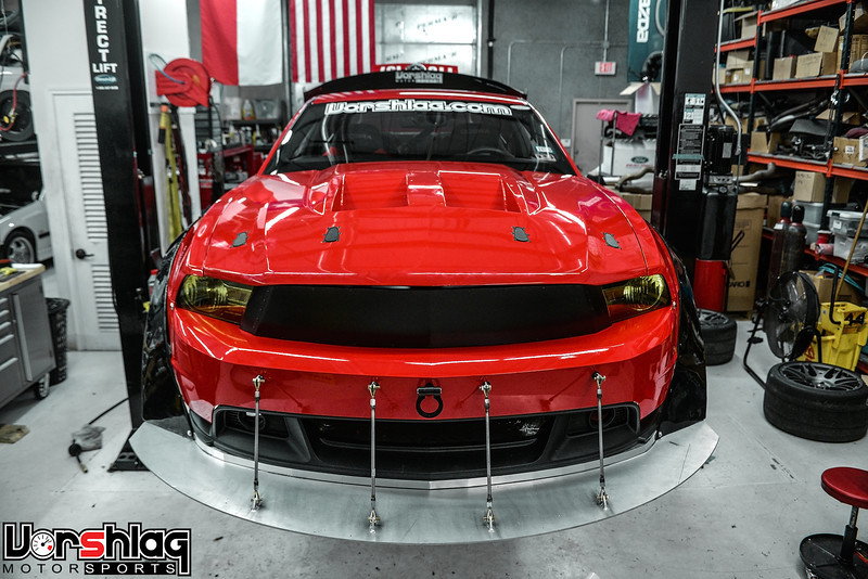

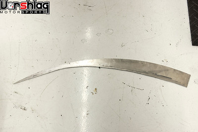

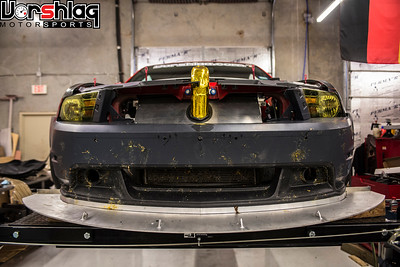

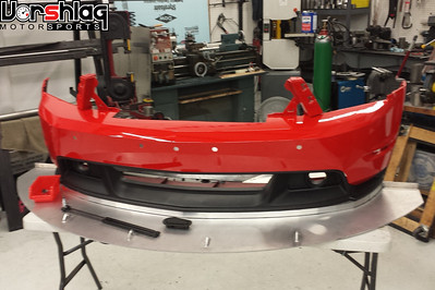

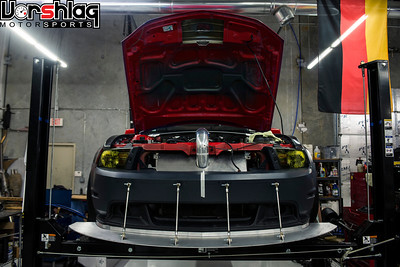

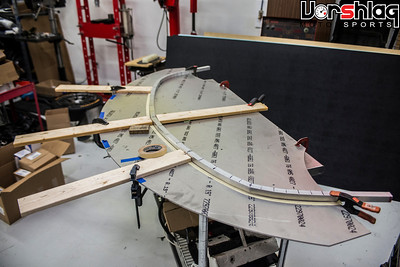

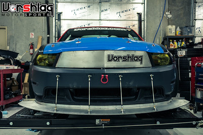

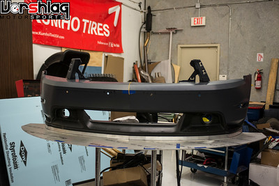

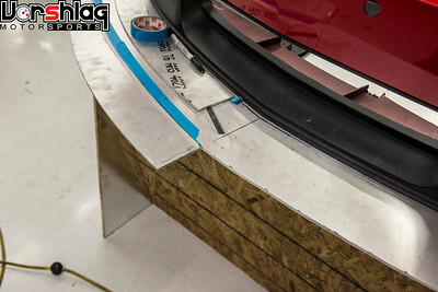

One big slab of 6061-T6 x .190 sheet makes up the new splitter, and yes, we probably went too thick and this thing has a sizable amount of heft. Its hard to tell in the small picture above (left) how much bigger the new unit really is. The black one is the Leguna Seca ABS splitter sitting on top of our aluminum BMF splitter. The Leguna piece sticks out past the lower fascia by 5.5". The new unit sticks out front by 10.25", almost double the forward length. It also goes back a couple of feet and is wider by nearly 4" per side, and is mounted 1" lower as well. The extra width is there to better line up with the upcoming tire spats/flares that will cover the front of the 18x12" front wheels. Spinning tires sticking out in the air stream are a big contribution to drag, so we planned to cover the leading edges.
The spacer to lower the splitter was built out of is 1" square aluminum tubing, pie cut on the back side and bent to match the curved contour of the lower fascia. This was then TIG welded back together while held in the fixture shown above, ground smooth, drilled for the existing mounting holes, and bolted between the splitter and fascia it becomes a rigid spacer. Ed cut and shaped this thing one night using his portable band saw, then Ryan (who did 90% of all of the work in this aero mod project) welded and ground it smooth, and it came out looking much nicer than any race part should. If we have ground clearance issues we can remove this 1" spacer and adjust the rear mounting eyes upward to match.

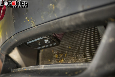

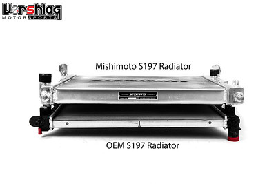

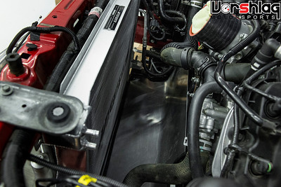

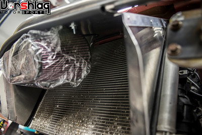

The radiator I talked briefly about in my previous post is shown above. Yes, it is a Mishimoto unit, which is a fabricated, all-aluminum radiator that is much larger than the OEM piece. It bolts in place and has the integral mounts for the A/C condenser, which is still on this car. We were going to buy the Ford Racing Boss-S radiator (M-8005-MGT), but at $750 retail (still $650+ at the lowest shipped price) I just couldn't stomach that. We have had excellent results with Mishimoto radiators in the past on LS1 BMWs (I have one in my new E46 LSx build, one in the Alpha E36 making 490 whp, McCall had one in his Z3 LS1, Matt has one in his E36 LS1, etc). Then we realized... damn, we're a Mishimoto dealer, and they do make an S197 drop-in radiator. We sell this radiator now for $247, which is a steal. I will touch on how it worked in my coverage of the ECR track test, below (excellent).
Above left you can see the "waterfall" air deflector that we built for behind the radiator. There are brackets that hold it in place (not shown in these pics yet) and it has rubber edging and cut-outs near any radiator hose. This deflector seals to the bottom of the radiator but is open on the sides. It directs the airflow up towards the hood ducting, but isn't part of a 100% sealed duct system. We talked to other race engineers and they agreed - the small incremental improvements from making a 100% sealed radiator-to-hood duct system is not worth the added work compared to what we have done here. We could get 90-95% of the benefit for 1/3rd the work. The upper right pic shows the first iteration of the rear splitter mounts. These are custom made pin mounts that go into small spherical eyes that can be adjusted up/down for a better fit. We have 3 on there, and the outer 2 have latching pins.

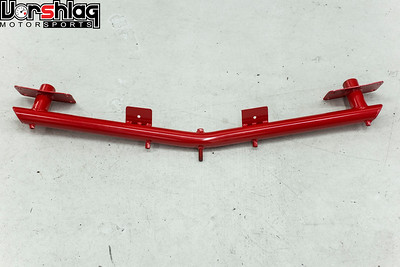

Above left are the fabricated struts that hold the front of the splitter and bolt to the fabricated push bar behind the bumper cover. These are adjustable in length and made from aluminum tubing and steel threaded eye ends. They have been weight tested and also proven on track, don't worry. The above right picture is with the hood ducting cut and some corrugated cardboard stuffed in place, for mock-up. Then Brandon did his photoshop tricks and made the blue hood look red.

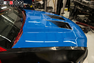

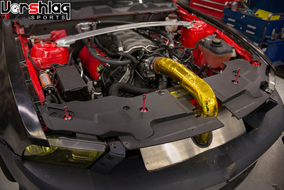

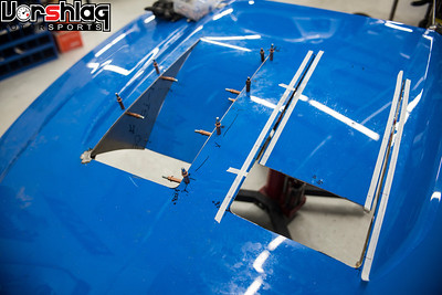

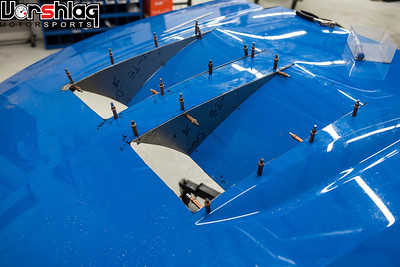

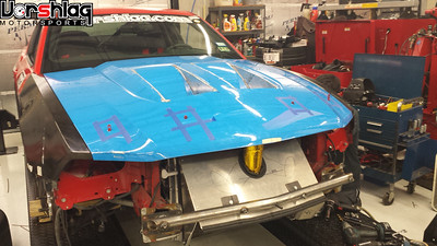

Building the hood ducting was done in the method shown above. We looked at other ways, and even attempted to weld on the aluminum sheet that the OEM hood is made of. welding was a major chore so we went with rivets. The aluminum side panels have small angle pieces riveted to them and to the hood, and he structure is actually stronger than before due to the boxed shape of the two ducts.
How big are the ducts, and why didn't we just "buy a Tiger Racing hood!", like so many people suggested? Well, as you can see, a human head will fit through the duct openings, so they are bigger than anything we've seen out there. The drop on the ducting is also very deep, unlike any off the shelf hood we have found for the S197. This drop was only possible by moving the coolant reservoir and factory routing of the cold-air inlet to the middle and going over the radiator support. THIS was why we did all of that work. The TR hood also has the ducts in less than ideal placement, in my humble opinion, moving from a low presure (forward) to high pressure zone back by near the windshield. It is also $1500+ for a composite hood that is prone to cracking, and a real bear to paint (according to a body shop I talked to that has done a half dozen), whereas this is a $300 used aluminum OEM hood with just "some fab hours" into it. ;) It is still light and yet strong enough to work for years without cracking. Mostly it allowed us to make the ducting as deep as we wanted in where we wanted, instead of being stuck with an aftermarket composite hood's shape and layout.
As you can see above, Ryan added some epoxy seam sealer to the edges of the hood openings where the sheets of aluminum met. Again, welding this OEM material proved problematic, so we went with rivets and panel bonding epoxy on everything. It is air tight and STRONG. The ducts are BIG, placed in the correct low pressure areas (in theory), and they drop WAY down and grab air from the now uncovered back of the radiator, with more flow pushed upwards from the waterfall deflector. This hood ducting combined with the massive splitter we fabricated should produce significantly more front downforce than the LS splitter we used before, even at low speeds. In theory. Neither Jason nor I are aero engineers, but our mechanical engineering backgrounds aren't from another planet, either. We also know some smart aero guys who gave us a lot of tips.

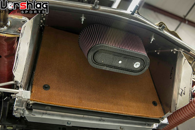

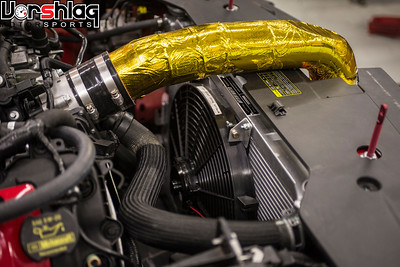

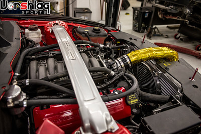

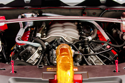

We never got a good picture with the bumper cover off of the new "Corvette style" air cleaner installed onto the end of our fabricated aluminum intake tube, and now that is all buried under the front end and I don't want to pull it all apart for a pic. Above are a couple of pictures with the clear cellophane still on the air cleaner, but mounted in place. Removing the big, bulky factory bumper beam and foam crash structure and replacing it with the fabricated 1.75" x .120" wall DOM tube allowed a lot of extra SPACE for the rather large air cleaner to sit and draw air from. It is up out of the air stream with just the carbon fiber "lid" visible from the grill opening. It might get a tiny bit of extra airflow from some "ram air" effect, but I doubt it will be noticeable (it wasn't on track). That wasn't the intent of the new intake tube routing and air cleaner location - it was all about making room behind the radiator for the new hood ducting's surface area.
In order to leave as much room behind the radiator for more surface area on the hood, to allow more flow through the ducting, we ditched the OEM electric fan and shroud. Why? The stock fan shroud was VERY THICK (4" or more), and it was also sealed to the entire back surface of the radiator. This is a good thing on a 100% street car with stock grill and stock radiator, as it allows the fan to suck air from the full back surface of the radiator and not just the round area that the fan blade covers. We aren't as concerned about stop and go traffic driving as much now, and once you are up to speed (45 mph or so) on track the "free flow" across the radiator makes the electric fan irrelevant - and in fact, the shroud can restrict free flow at speed. So we added a slim aftermarket 16" diameter electric fan without a shroud. This mounts to the Mishimoto's upper and lower flanges with custom aluminum brackets Olof fabbed up. We have it tied into the factory wiring harness and it functions just like the stock fan (computer controlled). When Ed and I ran the car Friday night to burp the new coolant system (filled with distilled water), the engine idled for about 20 minutes and the fan came on 2 times for about 30 seconds. Trust me, it moves some air. You can feel it sucking in on the front of the radiator and also blowing hard up from the waterfall deflector. We had to wait for the track test to see if the ducting work would pay off with adequate cooling, seeing that we blocked off over half of the grill opening area. We were warned by countless Mustang folks watching the pics on FB that it would overheat and melt the block like the core of the earth, too.
Another area we wanted to improve was the oil / air separator system. We have been using the JLT for over 2 years, and had upgraded their normal kit to have a real mounting bracket (we fabbed) and real metal fittings and lines (the JLT kit comes with plastic bits that eventually crack/leak). It was OK but the kit we had only drew crankcase pressure from one cylinder head - the passenger side. I picked up the can from a Moroso kit a while back and used it in a new system we built. This larger Moroso oil / air separator draws from both valve covers, into the separator, with a vacuum source on the other side of the can. We were pressed for time and simply used 5/8" heater hose for the lines with Norma clamps crimped at each end. We set-up the Moroso can using fittings with hose barb ends that we put together and mounted to the firewall with the included mounting bracket. I hoped the heater hose could take suction without collapsing (it doesn't!), but we had the track test to check that out at.

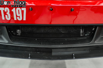

At left above we have the fabricated aluminum grill cover riveted to the factory grill surround. It isn't the final cover I had envisioned (wanted a smoother, more aerodynamic insert), but it was already made and we went with it for the track testing - and might not mess with it for a while. You can also see the tow hook we finally added to the front of the car. Yes, we went 3 years without a tow hook - and luckily never needed one. Whew! Above right I am doing the "200 pound splitter load test". The splitter doesn't bend, instead the front suspension just takes up the extra compression load, as it should.

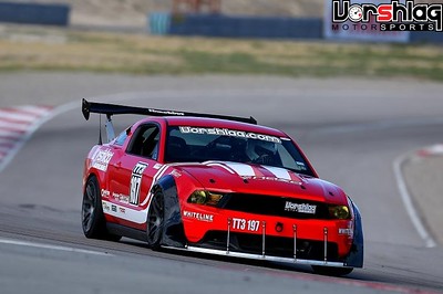

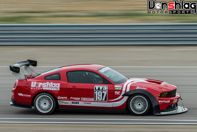

We had a LOT of late nights over the previous 2 weeks to get the car track ready, and finished up Saturday night and loaded the car into the trailer at around 10 pm. As I was installing 4 temporary hood pins Ryan swapped on new front Centric rotors, new Carbotech XP20 pads, and flushed a little Motul 600 through the lines. The track prep went to just about the last minute. The plan was to test at ECR on Sunday morning at 9 am.
Note: we did not have the flares completed when we went to test, we do understand that some bad aero drag occurs when the tire is visible from the front like this, but they were partially done before the test - just not enough to mount them. Due to some business reasons, we are not showing the manufacturing techniques for our flares. Nothing revolutionary, but I've never seen flares done the way we have in mind - and it could completely flop, so I don't want to show my ass if it does, ya know? There are some teaser shots of the flares in progress, below, from after the track test.

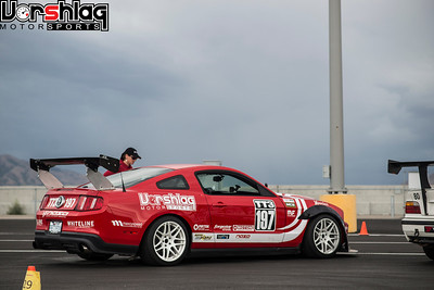

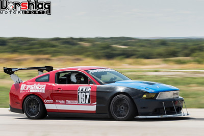

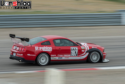

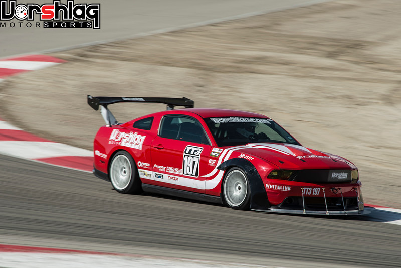

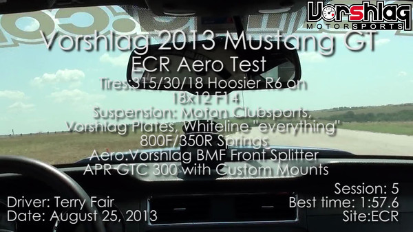

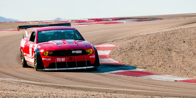

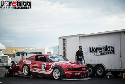

Test Day at ECR, August 26, 2013
Brandon and Ryan from Vorshlag and racing buddy Jason McCall met up with me and Amy at our house Sunday morning for the trek out to Eagles Canyon Raceway, which is located about 70 miles from our shop. This is our home track, and where I've got the most track miles since I did the first NASA event there in 2008. Lately we have been out at ECR at least once a month, sometimes 2 or even 3 times in a 4 week period. Long story short - this is where we could put in the most reliable laps without "driver course learning" coming into play.
Vorshlag Photo and Video Gallery for ECR Track Test: http://vorshlag.smugmug.com/Racing-E...ay-ECR-082613/
Now the 2.5 mile ECR circuit is far from a high speed test track, as most of the corners are fairly tight with long-ish straights in between (125 mph top speeds). It would not normally have been the ideal location for testing the new aero. And honestly, we didn't think we would put in a full day of data logging and aero testing - this was more of a place to take the new set-up and do basic shake down testing, to make sure nothing fell off or burned up. If we noticed any aero imbalance we figured the semi-fast corners in T1/T2, T4, T9, T10 and T11 might show us. It is also much closer to our shop than any other track, and the folks that run it are very cool and accommodating.
After we got there we had even more folks join us, including Olof from our shop, a Boss302 owner and fellow track junkie Jerry Cecco, and Dave B - who brought his GTS3 BMW our to test with us. We set-up the sunshade and put out chairs while the fluids were topped off and the car was checked out.
continued below
Vorshlag-Fair
Official Site Vendor
Official Vendor
Nov 12, 2010
1,592
107
Dallas, TX
continued from above

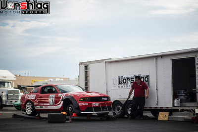

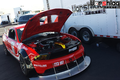

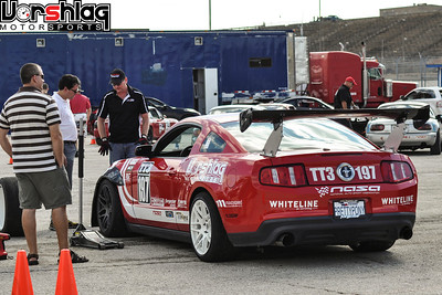

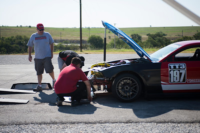

Loading and unloading the car from the trailer requires the front splitter to come off, and we've designed the splitter so that it stays attached to the bumper cover and all comes off as a unit. We quickly found that lining the splitter's rear mounting pins up with the mating holes while sitting on the ground is much harder than when on our 4 post lift, even with 3 people shoving it this way and that. After nearly 45 minutes we got the pins lined up and pinned, the front retaining struts bolted on, and the ends of the bumper cover bolted in place. Whew.
Above you can see me standing on the "ankle cutter" again - which always freaks people out. Honestly when you're trying to work on the front of the car you kinda have to stand there. It has been tested to 300 pounds now, too. At right Ryan is strapping on a helmet to take a ride in the Mustang for the first time on a road course. He has driven the car countless times on the street, and even ridden in it at an autocross, just hasn't had a chance to grab a ride on track yet. At most track days he's usually too busy working on other customers' cars or taking temps and measuring data on our own.

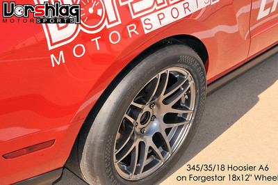

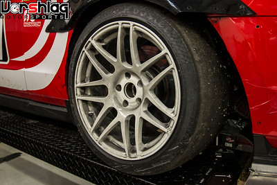

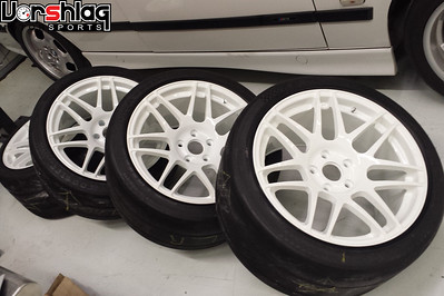

We were testing on the newer set of 18x12 Forgestar F14s ($350/each) at all 4 corners mounted with a used set of 315mm Hoosier R6 tires. These wheels and tires were used at NASA @ Hallett on June 22-23 and all day with 2 drivers at the June 29th Five Star Ford ECR track day. So they had some miles, but more importantly they were the same tires we had run at ECR 6 weeks earlier in nearly the same conditions. Any improvements (or slow downs) could at least be nullified from the tires. In the shake down laps Ryan and I did and the car felt LOOSE, but I wasn't really pushing it hard yet, just running some 2:01 laps, checking the gauges (temps looked great all day), looking for any weird deflections in the hood and listening for the splitter rubbing or scraping.
Some external video of when the car was still feeling "a bit loose"
Brandon was shooting pics and video and the whole crew was standing at the pit wall, looking for anything weird, or laughing when I was drifting out of T11 (not on purpose). The splitter did touch on some curbing at the side on a few corners, but it showed no damage afterwards. This thing is TOUGH. One bump under braking into T6 was causing the splitter to barely touch on the front edge, but the old 5.5" Leguna Splitter touched in the same braking zone, so no surprise there. Ryan was very happy with how the car felt, especially the brakes ("WOW, this car really stops"). After a few gentle laps Ryan hopped out and we brought the car in for a thorough look at all systems.
After that look-see went well, we added some fuel then Olof (above) got in to ride shotgun for the next 2 sessions out. Each run was only 3-5 laps, but we were learning a lot as I pushed the car harder each lap. The car was LOOSE AS HELL, especially in the faster corners. So each time we came in we kept adding more angle of attack (AOA) on the rear wing. For sessions 4 and 5 I went out alone, to push the car at the TT3 race weight we would be running. With the final wing change we managed to get the car a bit more neutral and ran the lap below.
That video has some pretty bad driving from me, as usual, and it was still a bit loose. Even with some ridiculously late braking into T1, which turned into a big SLIDE, plus some bobbles in other corners, the car put down a 1:57.6 lap in 95 degree heat on well worn R6s. The best lap I ever have put in at ECR was a 1:56 back in November of last year, when it was 40 degrees cooler and we were on fresh 315 Kumhos, and didn't have these big driving errors. In June the best Amy or I could get out of the car was a 2:00 min lap, wringing it out all day, so we seemingly found 3 seconds on the same set of tires in the same heat. We could have stuck around for more laps and likely chopped off some more time, but it was getting towards 1:30 pm and everyone wanted to go eat and get out of there. Most of us had not taken a day off in weeks and we were all dead tired, too.
The car did make some funky noises all day, only under decel or idle, which we attributed to the vacuum pulling the hoses shut on the oil / air separator system. We are replacing these with proper suction-rated lines tomorrow.

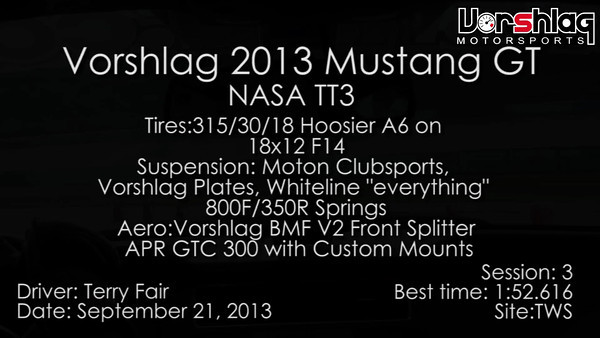

NASA @ TWS, September 20-22nd. We will be competing at this event at Texas World Speedway, the 2nd time this event is run on the NASA schedule this year (different direction). They will have HPDE, Time Trials, Racing, and an Enduro. Here is a link to the event sign-up page.

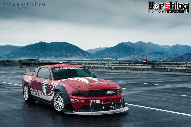

Pre-Nationals Update, Sept 2nd, 2013: It has been a very long week and we have been working hard on our Mustang every day since the test. A lot of things have been finished and cleaned up, and the crew is loading the car into the trailer now, at 10 pm the night before we drive to Miller. I will show a few pictures that are uploaded, but will do a better "catch up " post when we get back from the NASA Nationals...
The picture above shows the Kevlar honeycomb grill guard material and the air cleaner, in front of the radiator. If this honeycomb is damaged it can be quickly removed. It is a sacrificial material. A mesh grill out at the opening (high pressure area) would cause more airflow restriction than this stuff right at the radiator surface.
That's the front end all painted and ready for graphics. The guys at Heritage Collision Center in Sherman, TX did a fantastic job for such a short window, and over a 3-day holiday weekend at that. There is some clean-up work to do, as they ran out of color and couldn't get anyone to open their stores to make more, so don't over-analyze the paint just yet. We will bring the car back after Nationals, sans stripes, and they will re-shoot the hood. For the insane time frame we gave them, however it looks fantastic!
Ryan has been working damn near around the clock getting all of the little fab work done. Jason, Ryan and I worked with the flares and they came out "pretty good" for our first time vacuum forming ABS. We will show more pics of the flares when we get back. We learned a lot with this set, and will apply this knowledge and tweak our forming equipment to get a cleaner looking set of flares soon.
Amy and Jason did the stripes in about an hour, and they look excellent. They look like the old graphics but are indeed all new on the fenders and hood. The stripes dive down into the hood ducts and look slick. Big NASA decals adorn the car front and back.
That's the crew, with me on the left, Amy, then Jason and Ryan (with his eyes closed!). Brandon is on a ladder getting the shot. The rest of our guys are at home, asleep, on this Monday Labor Day holiday. Ed was here earlier helping with the build, as usual, but this time sporting a busted knee. We're loading the trailer and Amy and I leave for our 22 hour tow in about 6 hours. Sleep? Not part of the plan.

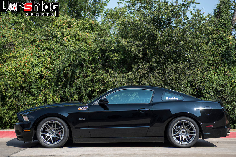

Project Update for Sept 17, 2013: Lots to cover in this update - the final pre-Nationals aero prep, paint, new wheels, coverage of NASA Nationals, the trip up and back, and plans for 2014. So much to cover that I'm going to break it up over several days. Otherwise it will be a mega update, then the eyes on the Short Attention Span kids will just glaze over and they will skip ahead just to see the pretty pictures. And believe me, there will be a lot of pretty pictures. Brandon went with us to Miller and shot hundreds of pics of dozens of cars, and Ryan worked on the car and helped me find 6 seconds of improvement over the 4 days we were racing at Miller.

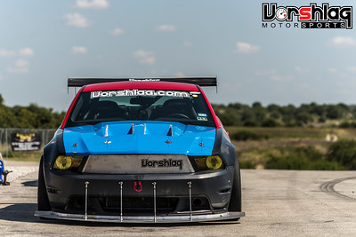

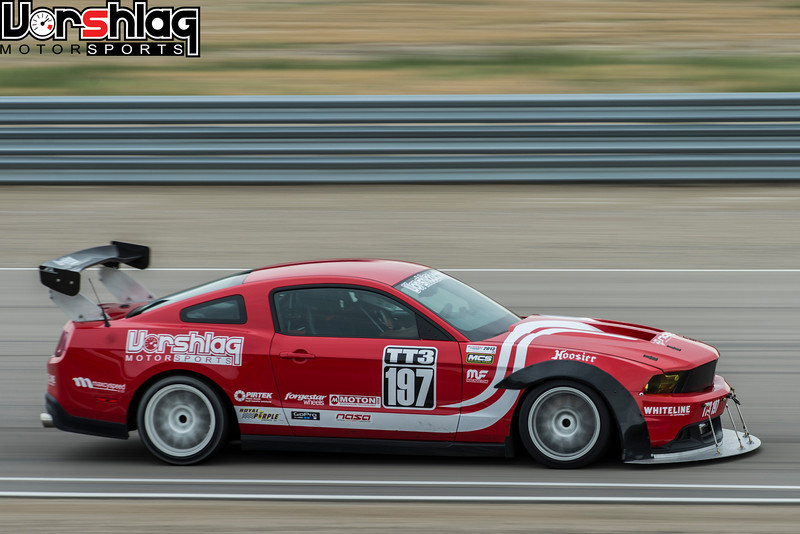

So over the past three years of owning, racing and developing this 2011 Mustang GT we have learned one thing that has held true on every wheel and tire iteration: BIGGER IS BETTER. This big, heavy car has a lot of power and a lot of mass, and each time we went to a wider tire the car got faster, without exception. We have not found any limit to this rule yet, and even 345/35/18 Hoosier A6 tires were still easy to spin at autocross speeds, as seen below.

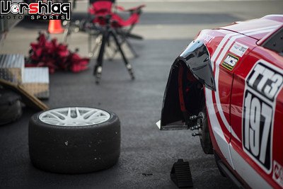

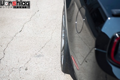

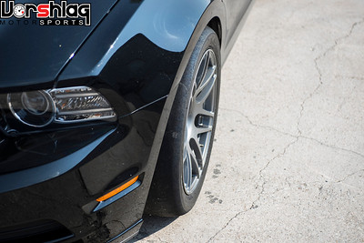

And while it looks like those 345mm tires fit the Mustang under stock fenders, they DON'T. They rubbed everywhere inboard, like mad, and wouldn't even bolt on the car without major changes to the rear swaybar (Whiteline style), a Watts Link, and more. It would still take a large amount of chassis fab work to make these fit - cutting the fenders and adding big flares would do it. Unfortunately Amy never allowed this, and even in the final months of ownership (more on this below) she is sticking to this limitation. Without flares the widest we can fit under the stock S197 fenders at the front or back is 315mm - anything wider rubs inboard or sticks past the fenders (and rubs under cornering if you run the ride height low enough). 315mm tires are not very big when you are talking about a 3500+ pound car making close to 500 hp. I looked at a lot of ST1/ST2/SIX cars at the recent NASA Nationals and all too many were on 345mm rears.
In my Sept 20th, 2012 thread update I mentioned that that we were working on solving this tire width limitation by making some bolt-on flares, inspired partly by the AIX Mustang shown above (the flares shown above are not for sale). We had planed on doing this to our 2013 GT, which I bought with the intent of cutting up and building a dedicated ESP classed autocross car. After the SCCA rules SNAFU we changed our plans, so we didn't get to do the chassis cutting needed to develop the S197 rear flares. There aren't any proper flares out there for this chassis (and yes, we know all about the RTR and Shelby versions, and all the rest); by proper I mean flares that can fit REALLY big tires, with a decent aero signature, and that don't cost $6000+. When we bought some extra front fenders, Amy gave us the green light to cut and flare the front. Which we did a week before Nationals...
What we had in mind was something a bit more modern and sleeker than the "cover the top of the tire" flares shown on the black AIX Mustang. Leaving the leading edge of a spinning tire in the airstream creates lots of drag; for lower drag and better evacuation from the fenderwell/undercar areas you want the back side of the flare OPEN, and even curve the trailing edge of the fender opening in if you can. We took some aero cues from several existing race cars and melded that with a little styling from the hard parking ("rough") crowd's flares and made these.
Now I will be the first to admit that these flares are far from perfect; these are very functional prototypes, with which we learned many lessons. I'd say they are a 6 out of 10 cosmetically, but we will make prettier versions. We have learned a lot and have more yet to learn with thermal formed plastic flares - making the bucks/molds, tweaking our heater, improving our vacuum table, and experimenting with more materials. We made all of our own vacuum forming equipment (which I'm not showing on purpose - sorry) and this is about version 1.2 of the flares. We still have several more iterations and technique improvements in store before we make something worth selling. And honestly, most people will want the "more looks/less aero" version with a little more styling (something more akin to this), which we plan to do. And we will make the rear flares, just not going to cut on this car's chassis due to Amy's restrictions on her car. Someone will bring us an S197 we can cut on a little, and we will make the rears around a 345mm wide tire at that time. The fronts clear 335mm wide tires.

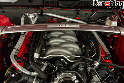

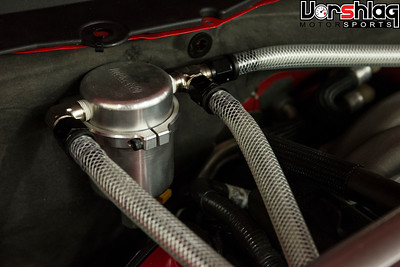

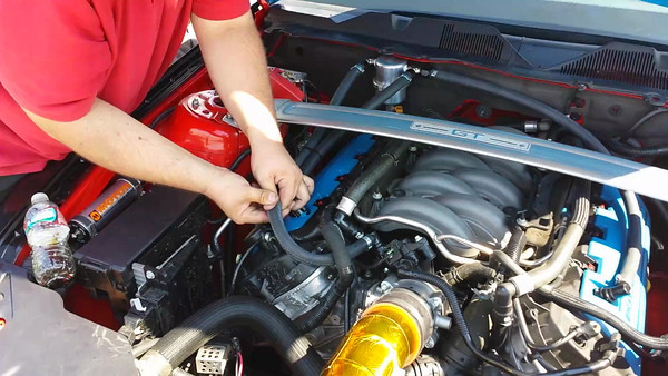

The honking oil catch can system
The oil catch can and hoses were upgraded from the old JLT kit we had added (then heavily modified). I talked about this before the ECR test, but in short the new system has a larger catch can (from Moroso) and mounts to the firewall. We thought we routed it the same way as the Boss 302-S race cars, but not quite. Instead of the JLT system that was pulling from just one cylinder head, we pulled air from both, with the lines T-'d together on the right side of the catch can. On the left of the can is a line that pulls from a vacuum source in the intake manifold. So theoretically the engine vacuum from the intake manifold pulls through the catch can, and grabs oil/vapor/air from the top of the motor from both valve covers, and the oil separates out into droplets inside the metal mesh filter inside the can. Once it falls out of suspension it pools in the bottom of the catch can, which can be drained between race weekends. In theory only air goes back into the intake manifold, not "oily air". Burning oil can cause detonation, of course.
So we showed a version of this system before the ECR test and the heater hose we used there was collapsing badly under deceleration/high vacuum - so much so that it made this loud "honking" noise that sounded like a dying goose (see video linked above), even at idle. Pinching off the vacuum source made the noise go away. So we replaced the heater hoses used at the ECR test with suction rated hoses. And it still collapsed on one side. Bruce from Ford Racing looked at the routing and immediately saw the issue - we sill have the PCV valve in the passenger side valve cover. Duh. So that valve closes under load, which puts that hose under extreme vacuum on that side. The fix is to get a driver's side valve for both sides - which deletes the PCV valve, suitable for a race car. We will try this before the next event (NASA @ TWS) and see how it does.

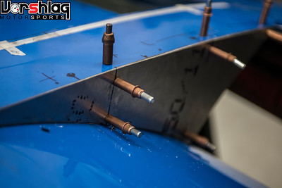

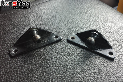

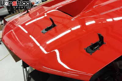

The hood latches/pins were a bit of a bear to install. I bought some "flush under mount" Aerolatches (but I meant to get the top mount) and was hoping to install them before the ECR test. Well we ran out of time and instead temporarily installed some simpler Sparco style hood pins for that track test. That took a couple of hours, whereas the Aerolatches took another 4+ hours to do correctly before we went to Nationals. Total PITA, but well worth it in the long run.
As you can see, they are much more aerodynamic, with considerably less drag when installed than the old school hood pin "posts" that protrude above the hood and have a separate securing pin that hooks through the hole in the post. The latches come with templates to use for marking and cutting the tapered oval openings and drilled holes for securing bolts. A very fiddly installation, so take your time and don't rush this. Aerolatches are not something you want to do the night before a race, trust me. It might take you an entire day to do 4 of them, if it is your first time.
The up/down alignment of the posts is critical, as is the angle of the post through the hood/into the latch, as is the latch alignment to the post. But once you have them installed and adjusted correctly (don't be afraid to use a light touch with a sledge hammer to persuade them during alignment) they mount flush, and when open the latches are very visibly so. Some folks paint the top of the latch a bright and contrasting color, so they are even more visible when open. But the black plastic stands out well against the red hood, so we left them unpainted. We used 4 across the hood to hold them down - some folks use only 2, but on an S197 there are 4 rubber "hood bumpers" that make for great spots to mount the pins/latches.

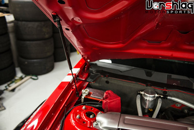

The hood struts we added to this car are nice, but everything has limits. As some of you may remember, one of these struts popped loose last May in some 30+ mph wind gusts, and the hood went crashing into the windshield. This was when the car was parked in the grid, facing into the wind, during an SCCA National Tour event in Nebraska. We had to finish the weekend with a destroyed windshield, and the hood was damaged every so slightly at the rear corners. It broke one hood hinge, too, which we replaced. So we don't trust the hood struts completely, and have been using these + the OEM hood prop to hold the hood from opening completely whenever there is even the slightest breeze in grid or paddock.
But having these self-raising hood struts is convenient, and now that the 3" diameter intake tubing is passing right over the top of the radiator, the hood prop no longer fits with the hood down. With the new hood we had just been using a broom handle to hold the hood up in paddock and the shop after we added the hood ducting and intake tube - but after the stick was bumped, it fell off and the hood bonked into my noggin, I went ahead and grabbed the hood-side mounts off of the old hood and reinstalled the hood struts. Two holes to drill on the hood and everything transferred over. Well except the bottom end of one hood strut was smashed in the previous "paddock incident" (the plastic end cup is broken), so I spent half an hour looking through all of the OEM replacement hood struts at the local parts store, found one that kind of fit, and it worked enough for careful use at Nationals. With some zip ties holding it together. Just use some common sense when pointed into the wind, or you could face the same consequences we did (new windshield + new hood hinge + damaged hood). Called RedlineTuning and they are sending us the plastic replacement end for the strut, free of charge - thanks.

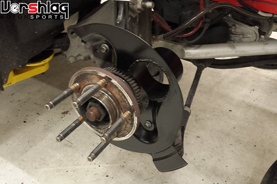

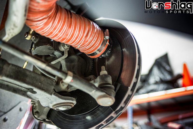

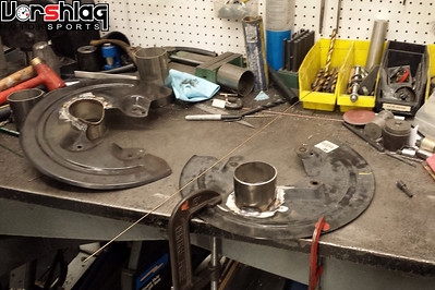

On Saturday before we were to leave Ryan had the calipers off to make new brake ducting backing plates for our car. We've been making these for customers in small batches, and will add them to our website in the next week or so, as front brake ducting kits for the 14" Brembo cars. During the reinstall of the calipers one of the M12 bolts stripped out the threaded hole in the aluminum caliper - which figures, because Ryan asked for new calipers 2 months ago, and I had said "Nah, these are fine..." We figured these holes have been screwed and unscrewed close to 150 times, so it was time to replace them. We couldn't get a replacement caliper on the 3-day Labor Day weekend and were set to leave early Tuesday morning, so I picked up a heli-coil kit at a local NAPA and Ryan fixed that on Monday.
Our previous set of backing plates (our first set we made about 2 years ago) were as bad as most out there, having had the cooling hose pointed mostly at the rotor face. The new ducts our guys built have the inlet moved inboard, to blow air inside the rotor's friction ring and at the hub. This lets the vanes of the rotor pull the air through the inside of the rotor and out, and also cools the front hubs. Our plates have the correct tubing size to fit inside a 3" brake duct hose without having to remove the reinforcing metal ring winding in the brake duct hose, unlike all of the other brake cooling kits we have installed before (including the Ford Racing kit). It isn't that hard to do it right, but nobody else seems to. Our plates are made from new OEM backing plates, trimmed down with a piece left in place to shield the tie rod from rotor heat, yet leaving the rotor face open. We bead blast them to raw metal, cut to fit the round tubing, TIG weld it all together, then have them powder coated black. More on these as soon as we get a batch back from the powder coater and added to our website.
Since we didn't want to get any grief from NASA's "50/50" rule (the car has to look good from 50 feet at 50 mph), we had to pull the car apart for paint before heading to Nationals. We sent the fenders on Wednesday night, and we got them the hood and bumper cover by Friday on the Labor Day weekend. They had it all painted by Sunday, and it came out great. We rushed the heck out of them and the hood wasn't cut and buffed, but we were out of time and picked it up anyway.

Once the fenders and front bumper cover were on we could finally install the flares, which we built while the fenders were being painted. The flares turned out pretty well for a first effort, but we will definitely make some improvements. We added a cut at the bumper cover to fender parting line, so we can pull the front bumper cover and splitter off to make it easier to roll the car into the trailer.

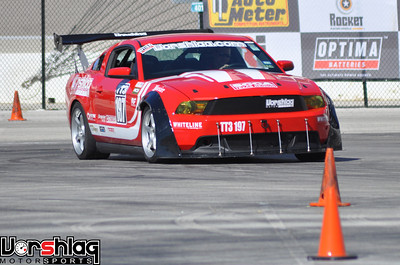

The white wheels had some scrub A6 tires mounted, as the sticker set we had ordered a week before was delayed by UPS. I was freaking out, but luckily our friends from Maxcyspeed were able to swing by and grab the 4 new tires as well as two new front calipers after we had left, then trucked them 25 hours across country and brought them to us in Salt Lake City. Whew!
You can see the hood stripes in many pictures from the event, which are similar to the previous version. These go down into hood duct openings so they are a bit wider in some areas, and we capped the front with a big NASA decal we made. There are also new decals for Whiteline, Maxcyspeed, MagnaFlow, Hoosier and others that were on the front half of the car. We added more contingency decals at the NASA Miller event for GoPro, MCS, Royal Purple and the required NASA Nationals event decals.
These two pictures above, from the Miller event, show how the entire splitter, bumper cover and grill come off as a unit. This makes it easy to load and unload the car from the trailer. It takes about six minutes to remove and 15 minutes to install the front of the car, with various bolted fasteners and the splitter support struts.
Other than some new rear pads we installed after ECR (the same rear Carbotechs have been on there for many months of abuse - since before NOLA in May) that is the extent of the pre-Nationals prep on the Mustang. We finished up working on the car and loading it and all of our spares and tools and tires into the trailer at about 11:30 pm Labor Day, we were home by midnight and packing our gear for the trip, and we rolled out the next morning at about 7:30 am...

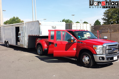

The tow from Dallas to Salt Lake City was brutal, no way to sugar coat it. Longest tow we've done, and matched the mileage, windshield time and brutality of the tow to Buttonwillow in California in 2008. Google says 1440 miles, and we added about 3400 miles to the truck with the round trip + trips into SLC during the 4 days we were there. At least this time I wasn't using a gas powered 3/4 ton truck and an open trailer to go over the Rocky Mountains (never again). Amy and I made the trip to SLC by ourselves, and she chose the longer "all Interstate" route that went North out of Dallas on I-35, through Oklahoma to Salina, Kansas, then west to Denver on I-70. That leg is about 15 hours. North out of Denver on I-25 to Cheyene, Wyoming, then west on I-80 a-l-l-l-l-l the way across Wyoming and into Salt Lake City, Utah. The 2nd leg is about 10 hours, and has some mountainous climbs. This "around the bend" route is almost 150 miles farther than the shortest route (through New Mexico), but... we go around the worst climbs and descents of the Rocky Mountains and it is all Interstate. Highest elevation we saw was 8500 feet, and the steepest grade was 8%.
The trip up started Tuesday and ended on Wednesday afternoon, with very little sleep on Tuesday night in Denver. The 2013 F-350 (aka: Clifford the Big Red Truck) pulled up and down mountains like a boss, and was 100% worry free. But our trip wasn't without some adventure - our first trailer tire blowout happened just an hour from home, as we crossed the line into Oklahoma. Thanks Oklahoma! Amy was cruising at 75 mph in nearly 100 degree heat when that first one went, so apparently the BFG load range E tires didn't like that speed and temp. Because we blew another one on the way back, in similar ambient temps in Kansas, but this time I was driving and only going 70 mph.
After that first blowout I dropped our max speed to 70 mph, and re-checked the tire pressures; all 4 were at or near 80 psi, as per the load rating. These tires were only 15 months old, the trailer was loaded properly, and I was frustrated beyond belief that we had two nearly new, perfect looking tires go "BOOM!" Luckily we had two mounted spares, but after the 2nd one went on us during the return trip we stopped at a Firestone and bought one more tire. Now we're going to carry a 3rd spare tire, unmounted. Both tires that blew came apart violently and damaged the fender flares, knocked the side mounted sunshade loose, and slapped rubber all over the side of the trailer. Both blowouts were from the same side. I've lost confidence in this tire and will be replacing all 4 with a different brand.

New 18x11" S197 Wheel Set-up From Vorshlag
Gotta take care of of this first, since a lot of you guys have been asking us for this 11" wide wheel set-up. Vorshlag has been working on various wheel packages for the S197 chassis ever since we bought one back in 2010. We now have a good set-up for using 18x11" wheels at all four corners that we've measured, tested, and perfected. This took a few iterations to get right, with various sets of wheels purchased and used on our TT3 Mustang. There is no magic formula for stuffing maximum wheel widths under any given car - it takes patient measurements, some testing, and carries a risk of buying wheels that might not fit. Like with our 18x10 wheels we made 2.5 years ago (with D-Force) - we had to buck up, spend the money, and just do it.
After a few "well, that almost worked perfectly" iterations we nailed it and have made this product entry for the four wheel 18x11" Forgestar F14 set-up located here. These wheels cannot be rotated front to rear, as they have vastly different offsets on each axle. That's just the way it works out on an S197 once you go past 10" wheel widths.

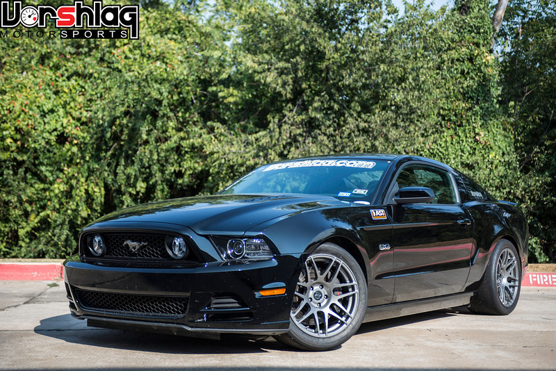

Last week we tested and verified the fit of the final iteration of 18x11s on our 2013 GT (which is still for sale if that page says so) with a set of Kumho V710 R-compound tires in 315/35/18, purchased for use by one of our S197 testers, Mark Council. These Kumho 315s are some big muthas! Our black '13 shown here is lowered 2.5" on AST coilovers, has an adjustable WL panhard rod to re-center the axle housing, plus some additional negative camber up front using our camber plates. To go any wider in the rear you need a reverse mounted swaybar (Whiteline) and probably a Watts Link to be safe (we stuffed an 18x12" on the back of our TT3 car this way, very carefully; we have perfected this 18x12" rear wheel set-up for racers as well, after several iterations on our car). To go any wider than an 11" up front you will need a Sawzall. The 18x12" fronts on our TT3 car have had the fenders cut and flared to fit, but the 18x11" works if you get the offset right.
As you can see in these pictures, the 18x11 wheels are close to the edges of the fenders at both ends, but these do fit, even with fat 315mm tires. This set-up has adequate inboard clearance up front and plenty of inboard room out back. It would also work with 295s, 305s or even 285s. We now offer these in our online store.
These are built to order and take from 4-6 weeks, and are perfect for autocross and track use, and maybe even street use if you are so inclined. We have made these in the mesh 14-spoke F14 versions but they would likely also work in their CF5 5-spoke version as well (just a tick heavier). Give us a shout if you are interested.

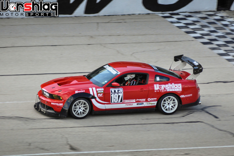

My favorite picture of the Mustang taken at Miller. Brandon did his magic on this one, right after it rained...

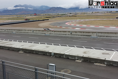

First, I have to talk about the track: Miller Motorsports Park is the most amazing facility I've ever raced at (not counting COTA, where we only "hooned around in Cadillacs"). Sorry, NOLA, you guys have an amazing track and grounds, too, but this one has mountains. Literally, every direction you look is filled with picturesque views.
You couldn't TAKE a bad picture here if you tried. Did you see that "wet paddock" picture above? Click it for a super-sized version - Brandon shot some amazing stuff all week. Like the owners at NOLA, the folks at Miller didn't just build a great track, they have amazing buildings and garages, a massive clubhouse, cafes and shops, plus they house and run the Ford Racing school here. There is a kart track, zip line, 900 acre off road park with 90 miles of course, a rock climbing course, a motocross and stadium truck course, and a museum. In one word: Epic

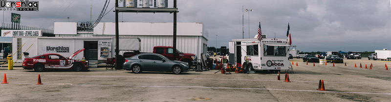

We parked at the far end of the West Paddock. This facility is huge and sits on over 500 acres!
We arrived at the track on Wednesday afternoon at around 4 pm and headed straight to the front office (outside of the gates) to check in. Many folks got there on Monday or even Tuesday to do some testing - we just couldn't afford the extra time away, but probably should have been there to learn this track. Signed a bunch of waivers, got our event shirt and hat, checked in, bought paddock passes for the extra crew we were flying in, and they then promptly sent us on a wild goose chase to the "South Gate" entrance, which was chained and locked. All week. Then I backed the trailer and truck up a very narrow 1/4 mile long entrance road, 3-pointed the rig, then headed to the North gate, which every sane person was entering into the facility.
Vorshlag NASA Nationals Photo and Video Gallery: http://vorshlag.smugmug.com/Racing-E...als-at-Miller/
Once inside (everyone was super nice, btw) we drove the entire length of Miller's paddock looking for an open spot to park... apparently you could reserve a closer parking space or garage for a fee, which we had neglected to do. And the place was packed already, anyway. The small amount of unreserved parking was at the far end of the paddock, where we found a space right next to the grid but still a good distance from all of the buildings, bathrooms and garages. Good thing we brought our bikes - we learned that from going to many SCCA Solo Nationals, where you walk a mile going here and a mile going there, many times a day.
As we pulled up I was in a bit of a panic, as my NASA TT3 classing sheets were a mess and I needed a fresh blank copy to re-calculate and finish my classing, and we needed to download and print our dyno certification sheet that we had True Street fill out for us. Amy went to find a printer and I went to Tech to see what I needed to do. See I am still used to the SCCA way, where they insist on Teching the car at every single event, so I figured I needed to do the same here. Once at the Tech garage and scales I met Alan Blaine of Blaine Fabrication face to face for the first time (we've purchased his products and cage kits before), as he works tech at many NASA events on the west coast. He said the scales were open until 5 pm, so I sprinted back to the trailer 47 miles away to unload the car and try to get the front end and splitter installed by myself, while Amy was looking for that printer. I didn't ask him if I needed to tech the car... he assumed I knew, which I should have. ;)
Left: My TT classing sheet was all jacked up when we arrived (but I fixed it). Right: These guys were doing it right - garage, air jacks, GT3
Got the car out of the trailer (without side mirrors and a dead battery - ever try to push a car out of a trailer with one hand, while sitting in the seat and steering backwards, blind, then bump starting the motor in reverse, coming down the 12 feet of ramps??) and started by myself, somehow. Left it running to charge the battery (it sat for 2 days in the trailer with something left on), then I crawled up to the forward part of the trailer and made a hole to get to the front bumper cover/splitter assembly. Once I dragged it back to the "cliff" of the front of the trailer, I tried... but it was just too heavy lift up over the generator, compressor and other junk on the floor that were in the way. There was nobody at my end of the paddock - it was a ghost town. I had the front end perched on my back like a donkey and tried to drag it out, but there was no way to get to the side door on my own without dropping it. Nothing replaces an extra set of hands. Time ticked away and some expletives may have snuck out. Right when I'm about to wrench my back doing some stupid contortions to get this massive splitter assembly out, Amy rolls up and we together we got the front end out of the trailer without scratching the fresh paint, and started the front end installation and alignment.
This should only take 15 minutes, but that's assuming everything goes smoothly. My side bolted together fine but Amy ran into problems from the beginning. She stripped not one but two bolts during the bolt-up assembly, and that blew our 5 pm "tech deadline". Once I finally got the front end bolted together properly I finally drove the car to tech at 5:20 pm, and it was all locked up. Crap! How did we plan this - to drive 25 hours across the country and miss Tech closing by 20 minutes??
Then I found out from Facebook NASA TT friends, who were more familiar with NASA Nationals, that we didn't need to go to Tech at all. Our NASA Annual tech + logbook was good enough. Tech was only there for people with new cars and/or no annual tech. Sweet! I cracked a beer and calmed down considerably, talked to a few friends we ran into at the far end of the paddock, then we both rode the 21 miles across the paddock and got to the 6 pm welcome dinner that NASA held in the Clubhouse. Decent meal, cash bar, lots of event specific chatter from the higher ups, and there were hundreds of people there. There was a moment of silence for the recently departed Roger Miller, who was part owner of the track and the NASA Utah region director. Tragic loss, with a family and 9 kids. The dinner broke up after the opening talks and we met with our race group leaders, where TT was told simply to "be at the 8:30 am meeting Thursday morning". Good enough for me.
As we left the dinner the rain started rolling in. WTF - I thought this was the desert?! We buttoned up the car as best we could (it wasn't going back into the trailer until we left on Sunday, because doing so would require the front end to come off - and we weren't about to start wrestling with it!) and put a big plastic trash bag under the hood ducting and over the motor, then headed to our hotel in nearby Toele, Utah. Amy and I stayed at a little Hampton Inn in Tooele, less than 10 minutes from the track, for the first 2 nights - which was a big mistake. See, the folks in Tooele know when there's a race at Miller and they jack the hotel rates WAY up. Also, this town has very few restaurants, with Applebee's being the number one rated place to eat. Great...

During the week we ended up doing a good bit of set-up work and even a few small repairs to the car. Ryan and Brandon were set to fly in EARLY on Friday morning and Amy would go get them in SLC, and be back in time for the first TT1/2/3 session on Friday. Well, that didn't work out, as they missed their 6:40 am flight out of DFW airport. Here's a tip: don't EVER fly Frontier airlines. They close the boarding counter a full hour before the flight leaves, and the same personnel help load luggage and stuff onto the airplane. Less people, less service - that is the Frontier motto. They got there 1.5 hours early but were held up in security and then got stuck in the line at Frontier for a long time, as they only had one counter person and all of their self-serve check-in kiosk terminals were broken. Then, when they were 2 people back from getting to the lone counter lady, she says "That's all, folks - you will have to take the next flight!". Total BS, and this was the first and list time we will use this crappy airline. Anyway...
Since Amy and I were the only crew there for all day Thursday and Friday, we ended up doing some tire changes and tweaks on our own. And since some dingleberry forgot the key to the generator, we had no electrical or air power all week. And without a cordless impact (who needs it when you have a big air compressor and air tools?!) that meant doing tire changes with hand tools, with extremely long wheel studs. As prepared as we were, this small thing hung us up.
Left: The "keyless" generator made me less than happy. Right: Only thing I managed to break in 9 sessions on track was this bleeder
After my 1st Thursday session I noticed a brake bleeder that was leaking fluid, so I cleaned it off and kept an eye on it. We had calipers delivered Thursday morning by the folks at Maxcyspeed, who wanted to come watch the races for a couple of days, and swung by Vorshlag to grab everything we forgot on the way. Thanks again, Stuart and Doug! We're working with these guys on some new shock development work, too. By Friday morning I couldn't ignore the bleeder any more - the bleeder or the whole caliper needed to be replaced. Well, damned if I cold find the 1/8" punch needed to swap over the pads (forgot it), and I didn't want to fight the new helicoil repair on that caliper (same one!), so I just swapped in an extra bleeder we had in our extensive and well marked spares boxes. We also brought a spare splitter, driveshaft, radiator, hoses, belts, pads, rotors, calipers (eventually), fluids, wheels, tires, lug nuts, and a lot of nut and bolt hardware.

Left: Grey wheels = R6. We ran these from Thursday thru Friday mid-day. Photo from Head-On photos. Right: White wheels = A6 tires (which we ran Friday afternoon-Sunday)
By Friday afternoon my times were not getting any better running on these R6s, and they were hammered, so we switched to the used A6 "scrubs" we had brought mounted to the white 18x12" set. These tires had also seen use at NOLA, two autocrosses, and another track day, but had what looked to be good rubber. Tedious tire changeover with a mistake made on the rear (forgot that this original set of 18x12" rears needed a spacer), but with some help from Jack Hidley of Maximum Motorsports we got the rear wheels fitted just in time for my last TT session on Friday. The car was a TOTAL MESS on these tires, and I put 2 wheels off of the exit of T1, after braking from 150+ mph. Loose, scary loose, and no faster.

The weather we saw at Miller over those 5 days is hard to describe, other than tho say it was psychotic. It would be calm and beautiful one minute, with white puffy clouds and amazing blue skies... then some storm cell would roll in over the mountains and all hell would break loose. It rained on no less than 3 of the 5 days we were there, which shot my "Tire Strategy" plans full of holes. We saw some HOT sessions (96°F), some very WINDY sessions (40 mph wind gusts, which blew apart all manner of EZ-up tents and we ALMOST lost our roll out sunshade), then some sessions where it was 70° and calm, and some that were raining. Going to the airport Friday afternoon to pick up Ryan and Brandon we drove through a sand storm. Like, a bad one - I was "looking for the Worms on planet Dune" bad. We saw it all that week, I tell ya.

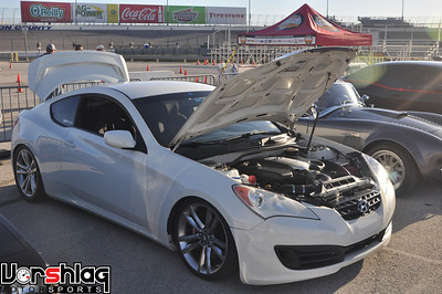

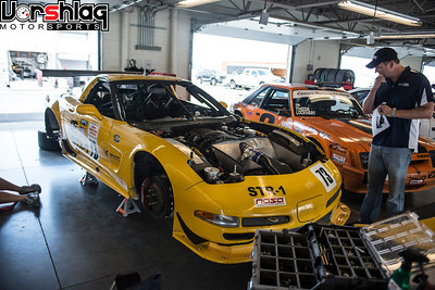

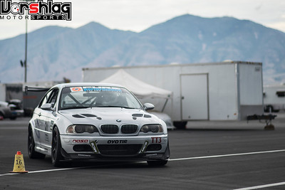

BMW E46 M3s are becoming increasingly popular in TT3/ST3/GTS3 classes
So this isn't the official racing procedure verbatim, but what I observed on how this worked in the Time Trial group. First, we had to be on grid in your assigned spot before the first car went out on track. Late to grid? Too bad, you lost that session. Why? They didn't want people popping out of the hot pits into the fastest part of the track and messing up other people's laps. NASA Texas has started to do this, too, and it is a welcomed change. Next, if you came off track before the end of the session, you went to Impound. Period. No tweaking the car on the hot pits, no going back out to finish the session, nope. Same reasons as above - coming back out on track during a hot session was dangerous and interrupted the flow of the racers, who are gridded in the order of their lap times (fastest to slowest). Also, they split the large TT contingent into two race groups that never shared the track at the same time: The "Letter Classes" (TTB-TTE) ran in Race Group C and The "Numbered Classes" (TTU/1/2/3) ran in Race Group H. It was nice for the faster TT guys to not have to worry about catching the E cars on lap 2, which can happen when all of the TT classes run at once.
Once TT racers came off track we were held in Impound until a TT Director released us, usually not until the session was over and everyone was in. We couldn't jack with the cars in Impound AT ALL. The driver could stay in his car and have ONE helper CHECK tire pressures and tire temps -or- he could exit the vehicle and do it himself. That was it. No dropping tire pressures, fiddling under the hood, or any funny business. And if you wanted to check tire pressures you had to ask a NASA official first, and they observed. Why? We were told because some folks have gamed the system in the past and dumped tire pressures in Impound down to 10 psi or less, then if they were dyno'd... yep, the numbers would be much lower than normal. So if you were caught dropping tire pressures in Impound then they gave you a dyno chit, aired your drive tires up to 40 psi, and off to the dyno you go. Automatic dyno check. Another sensible measure and fewer chances for shenanigans.

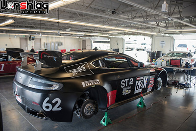

"A dozen ways to skin a cat" - here are two very different approaches to a TT2/ST2 build
Over the week my car was weighed 5 times, which was about average, but never was quick enough to warrant a dyno check. I was sweating it all week, as was everyone. Many of the faster TT guys' cars saw the dyno 1, 2 or even 3 times that week. How they dyno'd TT cars was simple. First, a TT director called down to Impound with a list of cars to by dyno'd and/or weighed ("If you drop a lot of time and move up to the front of the pack, prepare to be dyno'd"). If you were called out to be Dyno'd you got a "chit". Every car getting dyno'd was weighed first, which was recorded, and if it was not greater than your stated weight you got a session DQ. Same for anyone just getting a weight check. The closest to minimum I got was 21 pounds (3791 lbs with driver on a 3770 lb stated minimum) but I was often 50-60 pounds over, depending on fuel load. I saw some competitors get within 1-2 pounds, and several go under. We all were issued a decal that had to be posted on the side of the car with our declared minimum weight, max torque and max hp numbers, as shown below. Many of us made changes to this after we talked with TT officials, too.

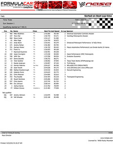

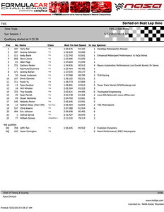

Print-outs showing results from Day 1's 3 TT sessions: The TT Warm up, TT Session 1 and TT session 2
In that Thursday Warm-Up session I ran so many consecutive hot laps that I saw some warmer than anticipated engine temps on lap 6, even with the lowest ambient temps of the day (high 70s). On Lap 6 the temp gauge shot up to maybe 3/4 of the range from "C" to "H", which is warmer than we ever see in this car. It was not that warm outside yet, so I chalked it up to the thin air here at 4500 feet of altitude and maybe still having an air bubble passing through the newly set-up cooling system (I added some distilled water in the pits after this). Talking to other drivers they were seeing the occasional warm temp readings, too, and I was told by many "high altitude racers" to be on the watch for this at Miller. I took a cool down lap and stayed well out of people's way while coming in, and with a 3 mile course the cool down laps can take a while. Within 30 seconds the engine temps came back to the "middle" of the range. This happened two more times during the week, saw a warm temp after too many hot laps that was corrected in the first cool down lap..
Navigating the "Attitudes", 3 S-curves right in a row with some wide, tall and nasty curbing
continued below
Vorshlag-Fair
Official Vendor
Nov 12, 2010
1,592
107
Dallas, TX
So, as with all NASA TT events, the times from this first "Warm Up" session on the first day only count towards our grid positions for the first "official" TT session, session 1. We checked air pressures hot and they were WAY higher than I thought they'd get up to, so we bled off 8-10 psi from each tire, from hot. We had an 11:10 am TT meeting where we did roll calls and listened to Greg give us the latest session DQs for spins, offs, weights or dyno (which were not printed on the individual session time sheets, strangely enough). Someone in the group also asked "what is a 4 off here", as there are some rather WIDE curbs at Miller - in some places more than 25 feet of paved but painted curbing. The biggest section of track in question was the "Attitudes", Turns 8/9/10, which are S-curves in rapid succession that also fall down a hill. Apparently this section was a bit controversial, and some race groups were seeing a handful of drivers really pounding over the curbs, some catching 4 wheels in the air and short cutting Turn 9 altogether (just going straight over the curbs/gravel and leaving the track). After some discussion it was ruled that the white painted line was to be considered the edge of the track and as long as 2 wheels were still "touching the paint", that was allowed. Tons of latitude but no more "cutting a corner". If we were 4 wheels over the paint it would be a "4 off" and a session DQ.

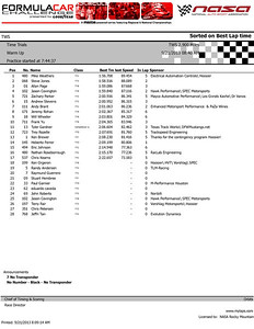

Just watched my TT session 1 video, which began on Thursday at 2 pm, and it was 20 degrees hotter than the TT Warm Up. At least this time we were gridded better, but I still had to deal with several passes, and the car was SUPER loose in the first 2 laps. I was finally figuring out where to shift, what gear to be in for each corner, pushing some still-early braking points, and just beginning to get a feel for where I was and where the apexes should be. I took a good number of laps in this session and dropped down to a 2:09.039, with my fastest lap on Lap 1. I spent the rest of the session trying different lines, braking points, etc. In Session 1 Ken Smith really picked up the pace and moved into the lead with a 2:05.099, with Mayfield right on his tail at a 2:05.753 time. Steve Nagel found a lot of time and dropped to a 2:07.284 and 3rd place in his white E36 M3 with aero and a claimed 310 whp, nearly 2 seconds quicker than my times.
The third and final TT session for Thrusday was TT session 2, we started at about 5:30 pm (about 30 minutes behind schedule) and ambient temps were up to 94 °F when we started. It was so delayed and so hot that attendance was pretty sparse by the time we finally got released from grid. After 2 false starts for this session we finally heard the reason for problem - Mark Baer had a pretty bad crash in his GTS BMW going into The Tooele Turn, T11, and they had to air flight him to the hospital for observation, tow the car in, and do some quick repairs to the armco.

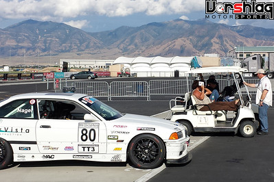

Smith (left) and Mayfield (right) traded the TT3 lead all week, but nobody else could seem to catch them
As I recalled after watching my video of this session, I was still pretty lost on 2nd half of the track after Turn 7, where I was confusing Turn 11 with Turn 13, and I still couldn't get the entry speeds up into Turn 7 (Witchcraft) or my line right into Turns 8/9/10. Really struggling to grasp this track layout, and there was a lot of gravel on the track from people going off and on at various corners. In my video I noted that the car was using about 5 gallons per session, and I was seeing "155 mph" on the speedo (probably more like 150mph) as I was braking into Turn 1. The car was still a loose mess at speed, and Amy and I were running out of things to change (tire pressures, wing angle, and some other things). I nearly looped the car going into Turn 3 on my 2nd hot lap, so took a cool-down lap and then another hot lap on the now well worn R6s. Just touching one of these monster curbs was setting the car into bump-steer convulsions. My best lap was again my 1st lap out, and nearly matched my previous session at a 2:09.054. Mayfield slowed down to a 2:05.574 and Ken Smith was in the 2:05.927 range, with Nagel slowing down to a 2:10.5. The higher ambient temps were hurting everyone and I was 4.5 seconds back from the class leader, not making up any ground.
My outlook was pretty bleak that night, but we had our lone good meal in Tooele (The Brewhouse) with Doug and Stuart Maxcy of Maxcyspeed. I drank away my sorrows and dreamed all night about turns like Witchcraft and the Attitudes, that were straight up kicking my ass.

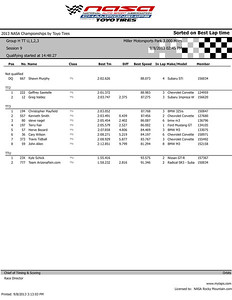

TT session 3, Session 4 and session 5 time sheets from Friday
For the Friday's final TT session (TT session 5) we we removed the Grey Forgestar 18x12's with the well worn R6s and slapped on the white Forgestar set with the the used set of Hoosier A6 tires. Clouds were rolling in, temperatures were dropping, and at the beginning of this late afternoon session it was down to 88°F. Amy and I had to swap wheels without any power tools, so it took a while and we barely made it to grid in time. Then we had another long delay on grid, as had been the case several times previously.
During this grid delay Brian Smyer shot the pictures above, as well as several others that he put into his blog post. "I fell in love with this mustang from Vorshlag so thought I would share a few images from Miller Motorsports Park" Brian also got some great images out on track, which I have scattered through this post (anything without the Vorshlag watermark was taken by him). Good stuff. After he took the above two pics the clouds rolled in and it started to look like rain again. Winds picked up, and many of the cars went out on sticker tires in this session, thinking it might be one of our last dry times for a bit (storms were predicted to roll in hard for Friday night/Saturday).
I left a gap to the rest of the field on the out lap, because I had been catching several cars gridded higher than me on the 1st and 2nd laps out, time and again. This session looked like the best conditions we had seen all week, and I had what I thought would be faster tires and some clear track ahead. I got a good run out of the last turn and pushed the revs in 5th gear down the front straight. With the higher AoA on the wing I only saw an indicated 150 mph into the braking zone (down from 155), but it seemed to stop fine. As I'm rolling into the throttle exiting Turn 1... the rear tires washed out, lots of counter steer, no help. I put 2 wheels off on the exit of T1 at 100+ mph and blew the lap. Took a cool down lap and tried to set up to try again.
After my 2 off I had let about 6 cars that were behind me go by, after I had gathered it up. So my next hot laps involved getting held up by virtually all of these cars as I re-passed them. The tires quickly felt greasy and the car was oversteering more than it had all week. My 2nd lap was only a 2:09.031, on the A6 tires. I knew I was in trouble and took another cool down lap, where I let a few of the same cars back around me, trying not to impede their laps. Started another hot lap, it was looking better on predictive timing, then exiting Turn 6 and I got blocked by two of the SAME cars that I had pointed by on my cool down, including one of the same cars that had blocked me on my previous hot lap. Very frustrating, my session was blown, the A6 tires were now overheated, so I threw in the towel and came into the pits. In that session Mayfield was 1.5 seconds quicker than his previous best, down to a blistering 2:04.170. Nagel ran a 2:07.808 as well, so it was a good session to get a fast lap in. My 2 off and subsequent blocked laps blew the session for me, but the tires never felt very good anyways.

My best lap was my first hot lap, once again, with a 2:05.579 - or 17 thousandths of a second back from Nagel! I stayed out and ran 3 hot laps in a row, which you can see bits and pieces of in the Speedcast video or in my in-car video, above. Nagel gave me the point right before the start-finish and I got a mostly clear track ahead of me for my first lap. I caught the TT2 Subaru again in Turn 4, T5 and was maybe held up a tick braking into T6, but he started pulling away from me after Turn 7. Watching my lap I was talking to myself and yelling at the car the whole time, might have left a few tenths out there, but I was on the ragged edge and tracking out to the curbing on most corners. When my lap timer said 2:05.59 after my first hot lap it was too close to call. So I went out in lap 2 looking for a tenth. I keep saying that on the video, "I just need a tenth... I just need a tenth!"
Exiting Witchcraft I pushed it a bit too hard and took the S-curves (attitudes) with a bit more curb than the car could handle and got it very crossed up. Kept it on track, barely, then cooled down for a couple of corners and went straight into hot lap 3. Tires were getting greasy and loose at the high speed corners in T2/T3/T4. Predictive timing was only showing low 2:06s and I was getting very, very frustrated. I needed to push it hard to find that tenth but could not afford to have an off. After 3 hot laps, where I noticed lap times slowing on each successive attempt, I packed it in, assuming I was probably only hundreds of a second slower than 3rd place.

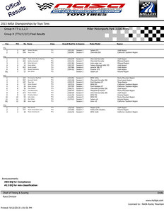

Left: The Official TT Final Results. Right: Nagels car sitting in Impound awaiting a ruling, after blowing the dyno. Twice.

  • When it comes to numbered TT classes (TTU/1/2/3), don't skimp on the aero. EVERY SINGLE top TT3 car had excellent wings, splitters, and low drag tricks. Nobody in TT3 used the "better" 9:1 optional ratio for using stock aero... every fast car took the weight hit to use aftermarket aero.
  • Too much front downforce can be a bad thing (we've since made a 2nd splitter that is 4" shorter - see my next event write-up on how that worked).
  • Don't do your aero set-up testing at a track that only has low speed corners (duh).
  • High speed tracks require SERIOUS braking systems. Don't skimp, and "bigger is better" applies.
  • Don't bring a street car to run in the top TT classes at Nationals and expect to win. It might work at a Region level, and it might have worked at Nationals in the past, but the top guys show up to Nationals in serious race cars.

Unfortunately we still need to sell the 2013 GT, and it has taken so long now that I'm forced to put the 2011 GT up for sale now, too. I know, that sucks - trust me, I don't want to do this. We had planned on selling the 2011 at the end of this year or in the Spring of 2014, to make room for the all new 2015 Mustang we want to buy, prep and race in 2014. That is still happening, but with so much $$$ tied up in both Mustangs, I need to move them sooner rather than later. We had hoped we could keep the red car for a while longer, but expanding the business needs cash right now and both of our S197 projects are going on the auction block. Look for an updated ad for the 2013 GT and a new for sale ad for the 2011 GT soon.
Since nobody made a serious offer on it, our black 2013 GT is getting taken back to stock very soon and will likely be sold on CraigsList to some random schmuck, as the "track ready" set-up didn't get me any legit buyers (just a couple of fast talking con men and a few low ball pranksters). Our red 2011 GT will be posted up as it sits in TT3 trim now, with the aero front end and one set of 18x12" wheels and tires. If that is a bust we'll put it back to nearly stock and sell it that way, too. Don't PM me about parts off of either car just yet, as I will ignore those straight off. When/if these cars have parts pulled off they will go for sale all at once and I'll post an ad here.

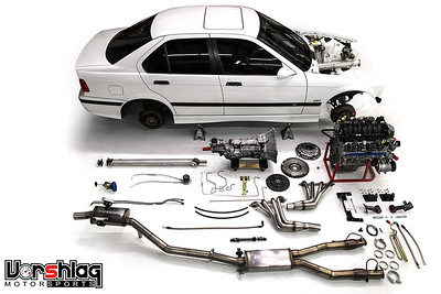

Vorshlag TT2/ST2 E36 Build Thread: http://www.vorshlag.com/forums/showthread.php?t=8254

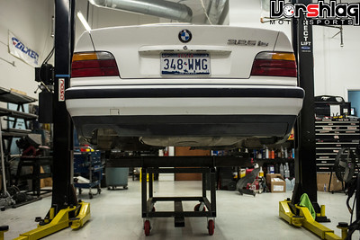

Over the winter we will be building a TT2/ST2 BMW E36 LS1. The chassis is a white 1992 325is "E36 Coupe", with a tired motor and interior. This will be stripped down, caged, flared, painted and built into a W2W race car. We might briefly run it in TT2 before we sell it, too - that's my goal if we do end up selling the red 2011 GT before the new 2015 GT arrives.
Above: Our TT2/ST2 build is already underway with the BMW E36 chassis being stripped and readied for a cage
I know, its not a Mustang, but it will allow us to at least get in the class with something while we await the S550's introduction. We will also be building our E46 LS1 Alpha car with a 5.7L motor around TT1 class rules, also over the winter, which we plan to race and develop that kit with as well. The Alpha LS1 Miata that is moving forward (customer car), among other builds in our shop.

There was less than 2 weeks between our return from Miller (Sept 10th) to the next NASA event (Sept 21st), and I wasn't about to go back to another track with high speed corners with this aero imbalance. So we made a list of changes to make and got to work on them quickly, between customer service and race prep jobs. And the shop was BUSY for those 2 weeks, and the work came down to the wire.
We started by leaving the Mustang in the trailer from the return trip from Miller and taking it straight to the painter. The guys at Heritage Collision wanted a little more time to finish the detail work, as we rushed them picking up the car before they had a chance to wet sand and buff the hood. They removed the vinyl stripes and decals and got to work. When we picked it up on Thursday the hood looked as perfect as the painted front bumper cover and fenders, but we never got around to re-striping the hood before the NASA event (ran out of time). Never rush your painter with an insane deadline, BTW.
After we got the trailer back to Vorshlag's shop we played musical chairs, moving cars back and forth from my home shop to Vorshlag. Mustang came out and stayed, our white Alpha E46 LS1 BMW went to my house for a few weeks while the "ST2/TT2 Build" E36 LS1 BMW came to the shop for its turn at some race prep work (it is now stripped down to the bare chassis and squeaky clean). Then another car was picked up at Heritage and delivered for one of my employees. Man, we need a bigger shop, and a bigger trailer. Growth problems.
When the car was back from the painter the custom made front bumper beam (which I personally weighed at almost exactly 10 pounds) was removed, the ends were capped and welded, and a few more stitch welds were added to the ducting tabs. Then it was scuffed, cleaned and painted. We spray bombed it the same Race Red as the exterior... just because. I hate leaving anything unpainted in bare steel, even on a "race car". And I knew we might be selling this car soon, so it was a loose end to wrap up.

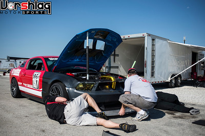

First, we drive the rear wheels up on some wood blocks or ramps, so we can then slide a long floor jack way under the axle pumpkin. Next we can jack up the rear of the car (to put the rear suspension loaded in bump direction), then we can remove the wheels, THEN we can allow the car to be raised on the lift and the rear suspension can go to full droop without letting the inner barrels of the rear wheels hang up on this useless bracket. Whew... it is a lot of words to describe, and it is an even bigger hassle to do each time the car goes on the lift. This is one of those special restrictions that go along with a 12" wide rear wheel (but not 10" or even 11" wheels - they are well clear of this bracket). You can work around the brackets with 12s, like we have for 2 seasons... or you can remove the damned things and no longer worry about the wheel hanging up on the bracket at max droop. This never once is an issue in any sort of driving, on the street or on the track track, but only comes int play at EXTREME droop (aka: only when the car is going on a 2-post body lift or being jacked up at the rear NOT by the axle).
It is even more fun to put the car up in the air for inspections or work track-side, as you have to either put jackstands under the axle tubes (as shown above) or yank the wheels first before it goes up onto jackstands. Nine spot welds later, the brackets fall off. If you use a spot weld cutter properly you only cut through the bracket itself (and not the tub). Then clean and paint the part of the inner fender area behind the bracket (otherwise it will be that green-grey primer) in a matching color you will never be able to tell it was ever there. Olof painted this area but we didn't get a picture of it all matching and pretty this time, oh well.
What idiot suggested making a set of race wheels and having them powder coated in white?! Oh, yea... that was me. Err... Oops. Looked cool in the very first pictures, but they were stained worse in each successive session at Miller. We tried cleaning them between sessions but it was hopeless. I showed my powder coater what they looked like after we got back and he suggested some polish. We tried that, and it worked OK in some small spots, but it just wouldn't cut the brake dust everywhere. We broke out the Mothers Power Ball and all kinds of waxes, cleaner wax, paint polish, aluminum polish... burned an hour... no help. They sort of almost tried to clean up, but these will have to be stripped (glass bead blasted) and recoated in grey or black if we use them in the future. They look bad.
I guess these big, powerful, heavy cars can just get the brakes too dang hot and the harsh XP20 Carbotech pad material we are using is embedding itself into the top layer of the clear coat on these wheels. Wouldn't be a problem on a street car or with most street compound brake pads, but this is the reason why so many race cars use grey, black or silver wheels. Live and learn... race wheels need to be some shade of "brake dust color", just to be safe. The other "flat grey" set of 18x12's we have looks excellent and has seen much more track time, of course.
So the lower grill opening got yet another screen, this time back in the stainless 1/4" spacing mesh we used before. Ryan and I talked about the Kevlar radiator screen and the few hotter than normal sessions we saw at Miller (and once at ECR) with that installed, so he fabricated another mesh screen surround frame & insert for the CS Lower Fascia. It was something to test again, we verified to be better at TWS, but there were other restrictions that happen when you "mow the grass" off track. I'll talk about that in my TWS race write-up, heh. We would have put the old screen back in but a customer with a 2012 Boss really wanted to buy that first screen from us, so it was sold off about a month ago. This now "screens" all incoming air to the radiator and air filter, since the upper grill is blocked off.

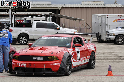

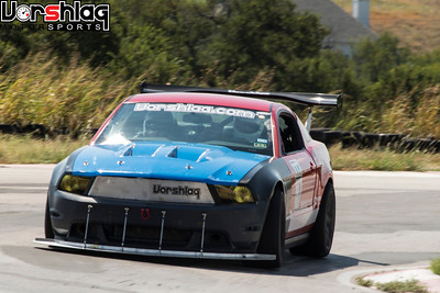

We made a new splitter for testing and use TWS (at left) that was approx. 4" shorter than the splitter we used at Miller (at right)
The big job I asked our fab crew to tackle before TWS was MAKE ME A NEW SPLITTER! Yes, it seems like a lot of work, and it was, but it paid off with a balanced car at speed (more on that below). The 10.25" splitter we used at Miller was a big too aggressive, and too much of a good thing (front downforce) turned into a loose car at speed. I'm really more surprised than anything that this worked... because "all of the textbooks" say that a splitter stalls past 6" in length. Well, this one sure didn't, and the 10.25" length unit just kept on pushing down on the front wheels. Maybe it has to do with the fact that we ducted the hood, added the waterfall deflector, and blocked the upper grill, but the "long" splitter was overpowering the rear downforce. Ideally I would have liked to keep the long version and tried a wider 2D wing element with a longer chord (and possibly a more efficient design with more downforce at a lower AoA) on the rear, but the budget for a new wing just wasn't there, either in time or money.
Luckily we had made 2 identical water jet aluminum splitter elements before we went to Nationals, so Ryan and the crew cut down the "spare" unit by 4" in length and made a 2nd full splitter. Still the same width, and still much larger than the surface area of the '12 Leguna splitter, and much stiffer. Since we might want to test this original 10 incher again later (on this car or another S197), I had them keep the old splitter intact and make a completely new unit from the spare piece. The new 6" unit has a new 1" square tube lower spacer, new strut mounting tabs welded in place (closer to the leading edge), new pin mounts at the back, everything. And we painted this one black, too.
Of course we learned some lessons from building the last splitter and this version one went a lot faster, and mounts faster/easier/better, too. Subtle tweaks here and there. And even though this 6" long unit is as low as the 10" long splitter before, the shorter front length makes it able to load the car into the trailer with the front end attached again. We still have to use a lot of ramps, but it works without scraping. Much. Huge time and hassle savings, though.
Now that we have a fully functional, remote controlled winch we can pull it in or out of the trailer with ease. And as you can see in the picture above, we have re-installed the OEM side view mirrors. Why? Well it can't really be called a street car without these. We pulled these off for the high speed track at Miller, as we were looking for every way to reduce drag. For that one event, where there wasn't any "leaving/returning" to a hot track, it almost made sense. At any other Time Trial or HPDE, where there is more passing.... not so much. If it was a pure race car we would install a multi-element rearview mirror at the top of the windshield (like a Wink mirror) plus a "school bus" convex side mirror on the driver's side, mounted to a roll cage just inside the car.

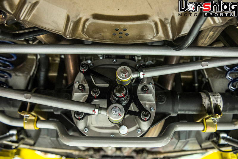

Another upgrade we did to our TT3 Mustang before Miller but finally got around to getting pictures of was an improved set of front brake backing plates for cooling air ducting. These finally match what we've been making for our customers for months and replaced the first versions we made 2 years ago. The original set for this car was a bit compromised and we have since made about a dozen sets for customers using the 14" front Brembos. Now we're finally making a production batch and will have them for sale soon in our Mustang S197 Brakes section of the Vorshlag website.
We did a lot of suspension, safety and other track prep work to another Boss 302 Leguna Seca last week (shown here) and Brandon got some good pics of the improved ducting plates we made for his car, too (check out the ghosted composite image, above). We also added a Whiteline Watts, rear control arms and brackets, Vorshlag/Bilstein StreetPro suspension, 5300-K springs, and more before he heads off to do the Big Bend Open Road high speed event.
These latest Vorshlag backing plates are somewhat unique in that they have the best aspects from several aftermarket designs we've seen - but they are made from OEM backing plates, so they fit tighter to the rotor face than other brands. Instead of starting with a (less costly) flat laser cut sheet, we use the OEM stamped/formed backing plates, which allow for these closer tolerances. We cut away most of the outer ring section that normally covers the rotor face (blocking the rotor from rain but also holding in heat) but we leave the section near the tie rod end (to protect the ball joint from rotor heat). Then we add the properly sized tubing to fit inside a 3" ducting hose (virtually every kit we've seen uses 3" diameter, which is too large to fit inside 3" hose). The tube is then cut to fit and TIG welded in place so that it pushes air inside the rotor face. This way the ducted air can be sucked through the vanes of the rotor, like an air pump. Nothing revolutionary, but just has the best features from all of the best kits we've seen and installed.

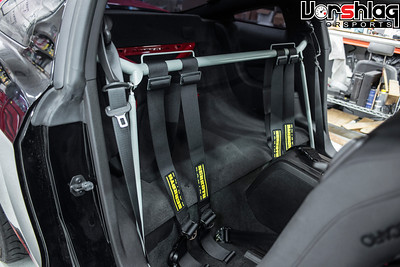

This Leguna also received a Corbeau bolt-in S197 harness bar (we are a Corbeau dealer now - with a demo seat in our lobby) and a set of the 6-point Schroth Profi ii harnesses. Submarine straps were special ordered to work with his Boss Recaro seats, since there is no lower harness hole in the bottom of those OEM seats. You can see these and many more options in the Mustang Seats and Safety section. A lot of people don't know we are dealers for many of the brands we have added in 2013.

These red painted marks are there to see when a bolt has loosened up, on future inspections (this is the Whiteline Watts on David' H's Leguna)

I was also worried about doing damage to the car here more than at any other track on the NASA Texas circuit or Miller. See, this track was built in 1969, in the age before even the RUSH movie was told. And it was made to be a super speedway, first and foremost, with a road course thrown in later for good measure. In 24 years of doing track events I've only ever damaged my cars at this track, and have seen many accidents happen here - the higher speeds, the rougher infield sections, one chicane that isn't needed, and nearby walls were all factors. The harsh impact coming off the banking into Turn 1 is also very jarring and eats RF wheel bearings. So I was more than a a little worried about damaging a car which I might be selling soon, and because of other events leading up to this weekend I was just a little less than cheery when we loaded up and headed down to College Station.

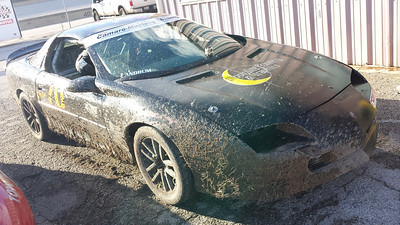

Left: One of the CMC cars that slid off into the muck at TWS on this race weekend. Right: A crashed TT car from April

I was gridded poorly for the 2nd TT session (first official session), due to missing the Warm Up
As you can see in the video below, pretty damned bad, actually. The tires we were using in these early Saturday sessions were some of the 315mm Hoosier R6 scrubs I picked up at Miller from the Hoosier trash pile, and all 4 had a LOT of klag (balled up rubber) glued to the carcasses. So on my warm up "out lap" I was aggressively trying to get the rubber off by slaloming hard on the straights. Most of the time on a TT out lap we're doing about 50 mph, and until we get to the "bunch up" zone (marked on the map) we can swerve and brake and do what we need to get tire heat, brake heat, oil heat, and scrub off klag like on my set of tires. I thought I had done enough... but no.
That's my first hot lap and yes, I had an off at Turn 6. The car was very loose exiting Turn 3 so I should have been ready for anything, but it was calmed down in Turns 4 and 5, so I started turning it up by Corner 6. I did my normal turn in for T6 and the rear washed out VERY QUICKLY. When it did I think the right rear tire caught some of the still damp track surface off line and it REALLY stepped out some more. I like to think I have pretty fast hands, and can usually catch a spin like this fast enough. Nope, not this time. I got into a classic tank slapper and shot straight off the exit of Corner 6 like a bullet. I could have gone of sideways but figured "go off straight" was the wise choice.
The times from Saturday's TT Warm-Up (left, which I skipped) and TT Session 1 (right, where I had an "off" and a subsequent DQ)
The "off" didn't do anything bad to the car, as the stiff aluminum plate splitter just mowed the grass - you could clearly see the path I took in the outfield. I felt like I should go back and do the edging, since I did so much mowing. Luckily I didn't go very far off track and missed any ruts or big bumps while in the dirt. I slowed down, waited for a gap, and got back on track when it was safe. Once back on track (in between a safe gap of cars) I immediately pulled off line (track left) on the straight and waved several more cars behind me by, until I could check the gauges, brakes and tires to see if I could get back up to speed. Once I was up to Turn 7 the car felt and looked fine, so I sped up and started planning for a hot lap on lap 2. I knew that now this TT session 1 was was going to be a DQ (offs or spins = automatic session DQ in Time Trial), but my times should still count towards gridding for TT session 2. And I needed to move up the grid more than I needed to worry about my fastest official TT time at this point. I took 2 more hot laps with lots of traffic (mostly passing cars I let by when I had the "off"), and got down to a 1:55.564 in traffic, then noticed engine temps shooting up so I took a cool down and came in. Turns out the new mesh grill we added to the lower fascia opening was PACKED FULL OF GRASS, so no air was getting to the radiator. But it still took 2 laps to get hot, so I guess the ducted hood was still pulling some air through the rad, somehow. I wiped away the tall grass clippings that I had mowed and got the car ready for TT session 2, after lunch.

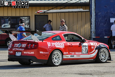

These grey wheels have the R6 tires, and were only used in TT session 1 on Saturday

I switched wheels to run the the A6 tires for Saturday's TT Session 2, with help from Brian Matteucci (striped shirt)
By now my old college racing buddy and former roommate Brian Matteucci had arrived and he helped me and Amy swap the tires over - and because of the swarm of people coming by, we needed the help. With a freakishy good paddock spot and the "hard to miss" changes to the car, we had 100+ people come by on Saturday and ask questions about the hood, splitter and flares, as this was the first NASA Texas event where anyone had seen the front aero mods. But we don't mind talking to folks - that's why we're here. :) Matteucci was here to watch a NASA event, as he is building a top secret TT car that should debut next month at the NASA @ ECR event (Nov 2-3).
Getting gridded up for TT session 2 took some "wheelin and dealin"
My lap time from the DQ'd session should have put me in 5th place on the grid, but the official sheet showed me way back at the back again. After telling the nice grid workers my story about the mistake on the grid sheets, and talking to some competitors gridded ahead of my, I begged my way into 10th place on the grid (most of the folks didn't want "the big red Mustang that just drove off track" right behind them, heh) and I was ready for Session 2.
So in that session I started in 10th and got some passes done in the first few laps and finally got in a quick, mostly traffic free run on hot lap 4. The best time I ran on this 4th hot lap was a 1:54.369, which was the 3rd quickest time in the session. Vorshlag customer Allen Page was on fire in this session and cut a 1:53.893 in his TTB car, the quickest car out there this time! Mike Weather's was 2nd quickest in his TT1 car, still clearly in the TT1 lead but he wasn't even running his good tires yet (didn't until Sunday).
Allan Page (left) was the quickest in TT session 2 in his TTB E46 M3, while Mike Weathers was fastest of the day, running a 1:50.480 in TT Session 1
My lap time was still way slower than I wanted to see, but was good enough to move me up to P3 on the grid for the final TT session , TT Session 3. Mike was clearly in the TT1 lead and didn't want to bother with the added heat of the last session of the day, as was Allan in TTB, so I ended up leading the pack out for the last TT session. More importantly, I finally had the first bit of clear track all day, and what I thought was a full battery on the vidcam and lap timer. So here we go, in the video below...

NASA time sheets for TT Session 2 (left), TT session 3 (middle) and End of Day Saturday Results (right)
I still didn't think the time was where I should have been running in this car, as the American Iron lap record was a 1:52.9 and I was barely beating that. The track was green from the recent rains, and the fastest AI car that day was in the 1:53s (Mike P's 4th gen Camaro), but that was still too close. I was hoping the first session on Sunday would seal the deal and we could push the TT3 record into the 1:49s or 1:50 flat range.

Sunday's TT Session 1 (left) and TT Session 2 (middle) were the only 2 I ran that day. Sunday End of Day times at right
We had beautiful, sunny weather on Sunday, which meant that Session 1 might have been the golden attempt. Ambient temps and track temps were up in TT Session 2, so Mike blew off going out in this one (he knew he had already seen the fastest session of the day). This meant I was gridded in P1, so I set the pace on the out lap at about 50 mph, and we had some stragglers but they finally caught up. I got in a good first lap and dropped a whopping tenth, down to a 1:50.675, for the new TT3 lap record (TT2 is a 1:50.2, but I couldn't get there in the growing heat). The car felt better than that, but the ambient temps were rising and times were slowing down to match. It is common for many TT racers on gumball tires set their fastest runs on the first Sunday TT sessions, once they have learned the track, as this can be the best track and tire temperatures. I tried another hot lap after my first but it slowed down a lot, then I started catching the back of the field. I took a cool down and came in.
Today my times were closer to where they needed to be. This 1:50.675 ended up being the winning time in class and the new TT3 track record, but I wouldn't know that until the end of the day. I felt like total crap so we loaded the car up before the 3rd TT session (after lunch) and headed back to Dallas by 2 pm. With the splitting migraine and other symptoms, I felt like I was coming down with something and didn't want to be out on track with my body nowhere near 100%. Leaving early put us home by 5:30 pm and we took a relaxing evening to eat, rest and catch up on TV shows and the like. We did, however, watch the MyLaps Race Monitor app during the TT session 3 and 4 on our drive back to Dallas, and as the temperatures rose the lap times did indeed slow down, and my time was safe. Whew!
New TT3 racer Jeremy Johnson (E46 M3 shown above) was fast and he is one to watch in 2014 in this class in Texas, as is John Robert's LS1 Miata (he's supposed to have his newest chassis built and ready for ECR). This was Jeremy's first weekend in TT, after his check ride on Saturday, and I'm sure he will get faster once he learns the "TT tricks". He still can add aero, A6s and more. Very clean car, well done cage, Motion Control double adjustable dampers with remotes, etc.
Aero Improvements Worked
The ease at which the car cornered at the handful of higher speed corners (T1, T2, T7 and T12) at TWS means that the aero changes we made after Miller worked. Lopping four inches off the front of the splitter brought the front to rear downforce balance to a perfect feel, once I got the car onto decent tires. The brakes, tires, motor, trans, and everything else worked perfectly. This was the car's 7th TT3 track record for the year, but I could have driven better both days and felt like I left that 1:49 lap out there.

We're still trying to sell the 2013 GT, and have removed the AST 4200RR coilover remote reservoir shocks and the 18x10" wheels. And before you ask, THE SHOCKS ARE ALREADY SOLD. Removing these two "big ticket" parts makes it a more affordable Mustang, but it still has the upgraded 14" front Brembo brakes, the custom front brake ducting, the Whiteline adjustable Panhard Bar, and Whiteline rear relocation brackets. We've re-installed the OEM shocks and top mounts but added Ford Racing 5300-K lowering springs, and installed the OEM 19x9" wheels and Pirelli tires from our red 2011 GT, since the stock 18x8" wheels won't fit over the bigger front brakes. The price dropped from $35K to $29.5K, and the ad is linked below.
FFS, somebody please buy this car. If we can move this one I might be able to keep the red 2011 GT, which we would continue to use to develop more S197 parts. There's still a long list of parts we'd like to tackle, which having a car on hand would help with. I really need your help here, so please spread the word. Beautiful car, low miles, some covert track upgrades, great price. Thanks.

So a local tuning/engine shop we recommend heavily is called True Street Motorsports. They decided to put on a big "Camaro vs Mustang" event at Texas Motorplex and enlisted Vorshlag to run the autocross portion of the event. There was drag racing, there was a car show, and there was an autocross, with 638 entrants signed up beforehand we were ready for a huge event, expecting at least 150 cars at the autocross.
We worked with some folks in the Texas Region SCCA to bring out their trailer, cones, and timing equipment. I had Vorshlag team members plus friends that volunteered to help us set-up and run the event. We had been to the Motorplex weeks before and inspected all of their parking lots, measured them for courses, marked obstacles, and were ready for a killer event!
Amy and I got there at 7 am, as the sun came up, and I was the first vehicle in the gate for the day with Brad driving the SCCA trailer in right behind me. With the help of the Vorshlag crew, we moved a bunch of barrels and "Caution taped" off the confines of the lot we were using. Brad and Gary from the SCCA set-up the trailer and timers while Amy and I laid out a course. I pre-drove the course in the 2013 GT and Brad made some suggestions, which we went with. Lots of helpers marked the cones and I chalked the outsides of the course.
On the day of the event there was nearly a 100% chance of precipitation in the forecast. With mostly drag racers signed up for this event, attendance really suffered due to the rain. Less than 100 people showed up by 10 am, and we had a total of 20 run the autocross event. Oh well, the sponsors all had already paid for the site and such, so we pressed on. It was overcast when we set-up but we managed to get a good course built for the small-ish lot we had available (350 x 375 feet). I still had hopes that more folks would continue to arrive, because autocross events run rain or shine. But the main draw for the event was the drag racing, and those guys don't run in the rain, obviously. We were hoping for a portion of the drag racers to come try autocross for the first time for only $10 more. And for the most part, the folks who did run the autocross were drag racers, except for a handful of Vorshlag customers that came just for this autocross.
"I'd like some Brake Dive with a side of wheelspin, please..."

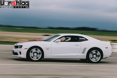

This was the first autocross course I have set-up in ... maybe 15 years? But its like riding a bike - you never forget. Amy and I had set-up probably 80 autocross courses when we were part of the TAMSCC club in college (and after), down in College Station. The course we came up with ended up being pretty fun, and was all 2nd gear in all of the cars that ran (no 1st gear portions, thankyouverymuch!) with about a 26 second bogey time.
All of the Camaros were 5th generation models and all but one of the Mustangs were S197s (with one SN95 thrown in), and the Mustangs out numbered the Camaros by more than 3 to 1. We had some dry runs from 9:30 until about 11:30, then the looming cold front blew in and the course had to be shut down due to excessive winds for a few minutes. It went from humid and 85°F to a very breezy 55°F in a matter of about 15 seconds. The skies darkened and the winds blew over most of the barrels lining the edge of the course area, and blew over a dozen cones. I went scrambling out on course in one of our bikes to chase down runaway barrels before they made it over to some parked cars. We got that cleaned up, the winds calmed down, and we got back to drivers taking runs shortly after.
Officially we gave each car 4 timed runs but due to the low turnout we allowed unlimited fun runs after their 4th, yet still ranked drivers on their first 4 runs. Most of the entrants took between 10-15 runs, with several over 25 and one Boss302 driver (Brian S, shown above) who took 37 runs! The surface was somewhat abrasive and grippy. Even in the misting precipitation that was present for about an hour, the run times didn't slow down all that much. Nobody was running for a short bit so I took our red Mustang out for 5 runs on a set of R6 tires in the wet, then Ryan swapped on the 18x10s and 295 Nitto street tires and I took another 4 runs on those, setting fast times on both set-ups, but I didn't take part in the competition. Kind of silly to enter an event we were setting up and sponsoring. I took riders on every fun run in this car, including in the video below.
Note to self - put the windshield wipers back on! We had them off for Miller but forgot to reinstall them for this event. Ryan managed to dry the windshield before every fun run we took. Our Mustang ran flawlessly and handled exceptionally well, rotating perfectly in these damp conditions. I was testing the old set of NT-05s (that we ran at Optima in June 2012 and on several track events and autocrosses on the 2013 GT since then) which we had to use for the Goodguys autocross the next day (Sunday). I dunno... felt OK, but again, it was wet.
Mark Council had his black 2012 GT at Vorshlag getting worked on the previous day (Friday), where we installed a new Cobra Suzuka GT seat, with a slider, harness bar and 6-point harness, using our new custom S197 seat bracket (I'll show that below). He also picked up his new 18x11" Forgestar wheels, which we had built using our custom offsets. We mounted a set of fat 315/35/18 Kumho V710 race tires to these wheels and he ended up setting the fastest time of the day with a 23.944 second lap, leading "Team Mustang" by a solid 9 tenths. The top time in a Camaro was a 26.337, Matt Coate driving in a 2011 Camaro SS on street tires. The results for the Mustang vs Camaro event are below.
After a short 30 minute break for lunch at noon we started back up at 12:30 and had a steady stream of cars on course. By 1 pm we'd had the last few stragglers arrive, get teched by Vorshlag's Ryan, take their 4 official runs plus several fun runs, and had their picture taken on course by Vorshlag's Brandon. So after a 20 minute heads up we wrapped things up at 2 pm, then took another hour picking up the course, taking down the timers/display, and loading the SCCA trailer. Big thanks to the SCCA folks for joining us in this event, that we thought would bring in some new autocrossers. And even with only 20 entrants we had some good "newbie retention", with several of these first timers showing up at the next SCCA autocross (which I will cover below).

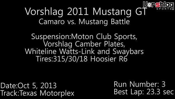

In-car video spliced with some external video of the TT3 Mustang running this course in the wet
Sure, it was a short course (23-26 second times) but it was very easy to see, it was fun and flowed well, we had no DNFs and very few cones were hit - even though we used a LOT of cones for the size of the lot and length of course. We did have a few folks that walked the course early on, but due to the nature of the event (drag racers would come over in waves after they made some 1/4 mile passes, so most did NOT walk the course) we needed an easy to see course. We also had to make the course route around 2 big light poles, a number of dips and bumps on the surface, and a building in the corner of the lot, but it was still super safe and everyone seemed to have a ball. When you get people taking 10-30+ fun runs I think you can say they liked it. :)
One thing that was different about this event, other than the massive number of fun runs, was that competitors did not have to work, which is normally a part of most autocross events. The entrants become volunteers, mostly used to shag cones during run heats they are not racing. But we had it covered, with the two folks from SCCA and the four of us from Vorshlag. We had Amy as the starter, one and sometimes two corner workers (and used a bicycle to get cones too far away), a guy teching cars all day, an announcer, timing operator, and a floater. We had a few friends help with set-up and tear down, but for the most part these 6 people did the bulk of the set-up and run the event. It was a lot of hard work, of course, but I'm glad we didn't have to resort to getting competitors to work corners and all of that. Trying to wrangle corner worker is like trying to herd cats - nobody likes to do it, and these folks had other things going on that day (drag racing + car show stuff). I suspect the next autocross some of these first timers go to after this will be like, "Wait, I have to WORK, too?" :D
We didn't get a chance to take part in the other activities going on at this "Battle" event, as we were working the autocross all day, but the drag racing portion ran for a couple of hours off and on. We would look up and see/hear the cars blasting down the 1/4 mile strip off and on that day, with big breaks during the two small bouts of misting rain. I believe I saw 3 cars in the car show area when we went by at lunch, too. I think this entire event might have a rain date for a total re-do, but I'm not sure when it is yet (mid November, maybe?). We've got enough events going on during the rest of this year where we won't likely be able to sponsor the autocross again, but maybe next year. It would help everyone involved if they had paid pre-registrations (fewer folks will skip the event that way, relative 500+ Facebook invite "yes" acknowledgements that bailed) and boost attendance, and maybe hold it at a facility that has a better autocross lot (Crandall!). If so, maybe we can be a part of this Camaro vs Mustang event again? We'll see how it looks if they do another one in 2014. :)

Left: The LS1 powered Genesis Coupe Blanton Payne ran on Sunday. Right: The Mini that Blanton drove Fri-Sat, and he and 2 other drivers also drove on Sunday

Couple of Ride Tech Pro class cars, including the Factory Five replica 32 Ford monster and a beastly truck bodied racer
But they wouldn't let us in with our truck and enclosed trailer, crap. ALL of our autocross and track gear is loaded in there, and we had a giant cooler full of drinks, tools, chairs, sunscreen, rain gear, etc. We found the remote parking lot we were supposed to park the truck and trailer in, located outside of the track. Then we unloaded the car and tried to stash as much of our gear in the trunk and back seat of the Mustang, then drove in to the autocross lot way in the back of the infield paddock area.
It was being held in a smallish, fenced in parking lot I didn't even know existed at TMS, and I've raced inside there many times. We parked and went to walk the course. It was as I expected - SUPER TIGHT, with concrete barriers less than 10 feet from the edge of the course in several places. Knife fight in a phone booth. The lot and layout would give SCCA Safety Chiefs spasms and fits, but its normal for a Goodguys autocross. You are expected to drive in control, and if you don't, you are responsible for the damage. We had some rain overnight and it was seeping up between cracks in the asphalt, but I expected it to dry. As soon as we walked it Amy said "No way, YOU are driving all of the runs."

My first run was tough, as the width of the splitter barely fit through some sections of the course, and I kicked a cone with the splitter on one of the 1st gear turn-arounds. My second run (video above) still felt pretty rough to me, and was riddled with mistakes, but it was at least clean. The car felt so wide and there was ZERO traction leaving the line, plus the front end was pushing HORRIBLY in the higher speed (35 mph in 2nd gear) super tight right-hander that I had to navigate twice per run. Had to crawl around the course, super conservative, to keep from mowing down the tight bits.
Somehow that 2nd run put me in the lead, with a 71.82 sec time. That made the on rush of people stopping by step up even more, with tons of questions about the racey bits they could see. I kept reiterating that this was a street car, with A/C, interior, emissions, and tags. There were several of the muscle car "Pros" running that had mega prepped engines and even one re-bodied NASCAR chassis, but the Mustang looked more like a race car, even though it really wasn't all that fast on this crazy tight course.

Left: The Mustang drew a fairly large crowd all day. Right: SCCA autocrosser Norm snapped a pic of me and Amy
