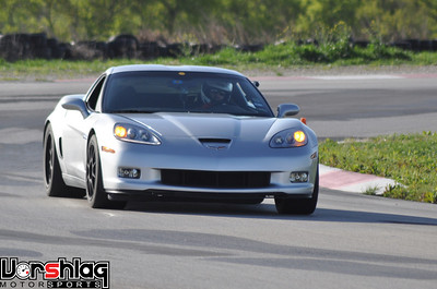

I’m glad you are doing so well. Mustangs have a horrible CD. - Add down force (More aero drag) -The HP per weight ratio goes to SHT. Higher CD cars are at a very large Disadvantage

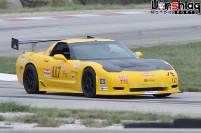

Yes, the S197 Mustang definitely has more drag than say... a C5 or C6 Corvette (which can be in TT3 now) so I will keep the aero as clean as possible to keep up with similarly prepped Corvettes on the higher speed tracks (like TWS). The handling in a C5/C6 is also a damn sight better from the factory, but there are no modifiers for solid axle suspensions yet, so we just have to deal with that disadvantage. We've run against some Corvettes in TT, both this year and last, and it has been a close battle so far.

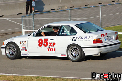

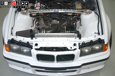

ea, the budgets for Time Trial builds "letter classes" (TTB-TTF) tends to be much more restrained than in the "number classes" (TTU-TT1-TT3), at least from what I've seen. We used to run a TTU car (now TT1) that was a gutted E36 BMW, with a 490 whp 7 liter, weighed 2450 pounds, 315mm Hoosiers on 11" wheels, some aero, etc.
The E36 BMW "Alpha Car" at least had real safety gear, which I sorely miss when I'm on track in the Mustang - especially considering we're going faster now in the 2011 GT than we went in that E36 LS2 car...
At the Nov 2012 NASA event at ECR I was 1 second quicker in the street Mustang than in the 2450 lb E36 LS1 race car in 2008
These days a car prepped like that wouldn't even make the top 3 in TT1 locally, much less at the National level. They've stepped it up in TTU-1-2-3, and there are serious builds running those classes now. We have stepped into the deep end with our move to TT3 and it will likely be difficult to win events in a full weight, daily driven street car shaped like a brick.
Oh well, it will be fun trying. :)

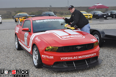

SCCA class decals coming off 2013 Mustang GT - which we bought solely to prepare and race in ESP class.
Leaving the SCCA for 2013 sucks and we're NOT happy about it, but it is a decision we've been discussing since this rule re-write was dumped on us from these committees. Now that the only "legal" Watts Link options we have are to use only a Fays2 or Steeda Watts Link, neither of which I sell (or care to), I opted for Option 2 - leave the class, and leave the sport. By the time this mess is undone, we will have an all new chassis to play with in mid-2014 (see my last section in this post).

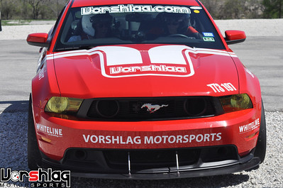

What's Next on our 2011 GT?
We aren't scuttling both of our S197 cars, as our red 2011 GT will continue to be raced and developed until the next round of Pony Cars arrives, so for at least another year. We have a gaggle of new parts here, ready to install and test before our March 16-17th NASA Time Trial event at MSR-Cresson. Whiteline sent us updated parts for the rear sway bar, the prototype transmission mount bushings showed up today, and we're working on more endlink options from them.
We made about a dozen of the black T-shirts above, showing a Mustang on the bottom and a Vorshlag logo up top. We can make these to order, next day turn-around, in a variety of sizes. You can find these shirts for sale on our merchandise page located here. We also picked up two Torsen T-2 differentials for 31-spline Ford 8.8" axles, including a T-2R (4:1 ratio) for the 2011 Mustang, shown above. I can't wait to get that in the car before the next track event! And the winnings from the January NASA TT event arrived - one brand new set of 315/30/18 Hoosier A6 tires. Finally - my first ever track event on a fresh set of A6s! No more old tire excuses for a NASA event (the last two NASA events were run on a sets of tires with over 13 months of autocross and track abuse - excuses, I has 'em!).
There are also several shifter bushings/housings we have accumulated and have now durometer tested (including the squishy soft stock rubber unit) and we will be putting one or more in the 2011 GT before the next track event. And if the Maximum 4-point roll bar arrives in time it will go in as well. There is also a new set of S197 monotubes/springs/Vorshlag plates we've been torture testing on a local guy's 2012 GT for a couple of months that will finally be going on our website to sell, along with several new monotube coilover brands that we will soon be selling.

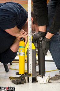

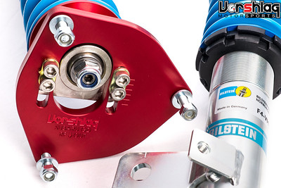

[B]Whiskey11[/B] said:
They are using adjustable spring perches with probably 2.5" springs. I'm not sure of the rates, probably 600F/225R was the last I heard. The rear springs are NOT spring over shock though
Yes, we avoided going to coilover rear shock and spring set-up and instead use 2.25" or 2.5" rear springs on AST ride height adjusters and Vorshlag adapters. This all sits in the stock rear spring location. We have done this on our two S197 cars with AST 4150, AST 4200RR and Moton Motorsport 2-way shocks.
We talk a lot of people out of using coilover rear shocks when the factory shock and spring were divorced. This is because, unless the factory had a coilover rear shock/spring set-up, the upper sheet metal shock mounts probably are NOT designed to see full suspension/spring loads, just damping loads.
Of course many folks do go ahead and slap on coilover rear shocks, and in many cases it works without incident, but not always. On BMW chassis it can punch the shock right through the shock tower unless you tie the cage into this area and add some plate steel to reinforce the shock mount opening. And coilover springs mounted to the rear shocks will almost always eat up inside wheel room. There just isn't almost any performance benefit and LOTS of downsides...

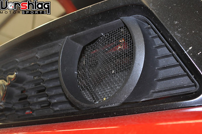

Other Mods - Ballast Bracket and Lower Mesh Grill Guard
I asked Ryan to make another stainless steel mesh "grill guard" to cover the big opening at the bottom of the CS lower fascia (the optional lower grill insert that works with the Leguna Seca splitter on the 2011). Hits from various grasshoppers and tire klag have done a number on the A/C condenser hanging out in front of the radiator. I hoped that another mesh covering could minimize future fin damage. The grills he made for the fog light openings have saved the bits behind them from tire marbles and bug and hits.
The lower mesh grill came out nicely, and once it was painted black and fit snugly in the opening, it looked factory. Next up was a rushed attempt at making a "ballast box". This was a bolted-in bracket made to hold Olympic style weights to use as ballast. At the January NASA event at MSR-H we had to hastily load ballast into the trunk and it was "less than idea". This way it would be properly bolted down and hold the weights securely.
It isn't the prettiest fabrication but it was done at the last minute, right before the car was loaded onto the trailer to go to MSR-C. You can pick the back of the car up by pulling up on the weights, and it bolts in place with many bolts. We over-shot the weight a bit, as the car weighed 3812 with me in it and 3/4 tank of fuel at the NASA event. This way we would be safe with Amy driving and even with a lower fuel load. Before the next NASA event it will be welded up a bit tidier and then cleaned and painted.

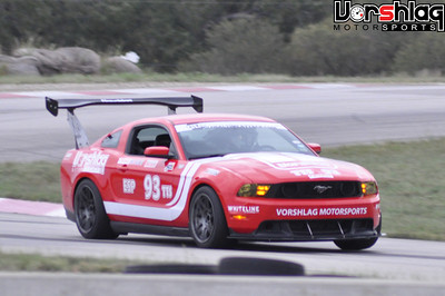

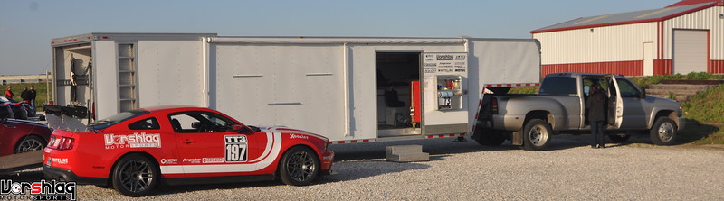

We started the day on a sticker set of 295/40/18 Hoosier R6 tires and planned to switch to the sticker 315/30/18 Hoosier A6 tures if.... 1) we were getting beat or 2) if the 295s felt funky. By TT session 2, our first timed session I was out again on the 295s and Amy had done one HPDE session on the 1.7 course. Neither of us liked the feel of the 295s but I wanted to give them a little more time to show their stuff. I was also instructing a student in HPDE1 so I was running ragged that day, with our paddock spot a long way away from the grid. I was briefly in the TT3 lead on the 295s, but Amy and I agreed that the 295s weren't cutting it. They felt... very slow to react compared to the 315/30/18 Hoosiers and 315/35/18 Kumho V710s we had raced on for much of last year at various track events.
Left: Borrowed truck and trailer were handy, but left us without a lot of our tools. Right: Getting ready to go out on 315s
By 10:30 Olof had arrived at the track and the three of us quickly swapped wheels and tires for the wider Forgestar 18x11/12" wheels and shorter/wider 315/30/18 Hoosier A6 tires. Two sticker sets of Hoosiers in one day - nucking futs! Amy quickly went out for a few laps in another HPDE session to get a feel for the shorter A6s and she really liked it, but still had no idea what line to take on the 3.1 course. She finally took to the 3.1 mile course in TT Session 3, but there was a little "incident" that shortened the session to one lone hot lap (hence her abysmal 2:31 time followed by a 4:09, which was during the red flagged lap). This incident was some inadvertent "car-to-car" contact, which I have never seen in a Time Trial session in our region in the past 6 years. I don't want to get into it any more than to say that one TT driver was completely lost, was driving the wrong course, and turned into another car.
Anyway, during that very brief session another TT3 driver had slipped into the lead ahead of me, just barely. Amy had one hot lap in a timed TT session for the day. I felt bad about it, since she only got one real timed lap in a TT session on Saturday, and offered up session 4 to her... but she agreed to let me go out in TT session 4 on the A6s, to try for the win, as I was a good bit faster than her, on this course which I knew a little better. We just had enough in class (5 cars) to pay out 2 tires to 1st place, if I could get back into the lead.
The TT3 class lead was razor thin - I was less than a tenth back with a 2:26 lap - but I had a feeling that the then 1st placed car, an LS1 powered Miata with big Hoosiers and aero, would pick up time in TT session 4. I had my secret weapon - switching to the 315 A6s would surely drop some major time! What I didn't know was - he was doing the same damn thing!! Oh, the irony. :D We both switched from R6 tires to A6s for TT session 4, and I was lined up right behind him on the formation lap.
Partial hot lap from Saturday (Day 1) TT session 4, before the camera shifted...
You can see part of TT session 4 in the video above, right until the camera shifted and pointed at the ceiling (ruining video for the rest of the weekend). So I go out, try to learn the feel of the very short/sticky A6 tires in this lone session, and quickly realize I'm catching the LS1 Miata hard on many turns of the 1st hot lap, so I back off and build a gap. That's where the video stops.

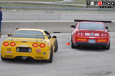

The key to doing well in Time Trial is to not get stuck in traffic. So by hot lap 2 I had backed off enough to build a nice 200 yard gap to John's LS1 Miata ahead and still had plenty of distance to a TT1 Corvette behind me so as to not impede him. Then I put the hammer down and started making up track distance to John. I want after at it for 3 hot laps, catching the V8 Miata little by little on laps 2, 3 and 4. But what I didn't realize was, John had already put in his fastest time on lap 1, when I was bunching up in his mirrors and backed off. In the end we both dropped 2 full seconds, but John came away with the win with a 2:24.643 to my 2:27.787 lap. So the win, 2 tires, and a track record went to John on Day 1, and I congratulated him after.
The LS1 Miata of John Roberts was a tick faster on Day 1 than the Mustang
I cannot emphasize this enough: The differences in the two tires were dramatic - sidewall height, overall height, compound, tread width, and steering feel. My excuse is that the changes were too drastic for me to learn with in a mere 4 laps, and I just couldn't put the right lap together. I wasn't "getting the line" right at all all day, either. I felt like I needed one more lap, but by the 4th hot lap in that last session of the day I noticed my lap times were really slowing down. The Hoosier A6 is fast, but you need to put in your fast lap or two in early, then they need to cool down.
Basically, I drove for crap. I pondered my many mistakes that night at the NASA catered party / St. Paddy's Day celebration, where I was given evil, potent shots of some green alcohol... I was blitzed out of my mind by 7:30 pm and Amy had to take me outta there and go get some food in me, to sober up!
Sunday was a new day, and I vowed was going to put a solid fast lap in on this b!tch of a course, by damn. Amy promised to do the same, if she "could get more than one hot lap all day!". There were 4 full TT sessions to get times in for Day 2, so Amy and I split them 50-50. She went in TT sessions 1 and 3, I took sessions 2 and 4. Did I mention that 2 people driving the same car and getting half the seat time sucks??? She put in a good number of laps in TT session 1 and brought the car in while I sprinted to the grid to instruct with my student.
What she didn't do was add fuel to the car, which we were doing after every other session, to both make weight and make sure the fuel pick-up didn't get starved. When we ran the car on track with street tires it wasn't ever a concern but I noticed some fuel starve in higher speed left handers at MSR-Houston with less than a 1/2 tank of fuel, and didn't want to repeat that.
I barely made it back to the car in time to grid up for TT session 2... and it showed to have just a tick above half a tank. Err... will this work??? No time to leave the grid and get more fuel, so I had to hope it was enough for a few laps. Again, I felt like I had the track figured out in my head, and I just needed one traffic-free lap, early, to get a good time in.
This wasn't enough fuel for ONE hot lap, actually. After we got through the end of the warm-up lap the front of the field was speeding up and I had a perfect gap ahead and behind for some traffic-free laps. I am building speed through turns 14-15-16 of the 1.7 section of the course, which are well into 4th gear, pushing the big car hard through this high-g series of corners right before the green flag... and the motor starts to stall. No... noNoNONONO! It clears up towards the entrance to Turn 1 (Big Bend), I dig in the brakes hard and lay into the throttle before the apex, letting the car push wide.... engine stalls again. NO! This is NOT HAPPENING! The gauge shows half a tank!?! But now, on 315mm A6s, with the wing set at a high AOA, in these high speed corners it is simply fuel starving. I throw up a fist and quickly dive into Pit In, not wanting to suffer through another 3.1 mile lap of fuel starvation and holding up the entire TT field.
At this point I'm pretty mad at Amy for leaving me way less than the 3/4 tank we had agreed on for the start of each session. I guess I wasn't clear enough. Sharing a race car SUCKS, by the way. ;) I dejectedly head to the local gas station, still painfully in view of the lower corners in the 1.3 section. I wave at some of the drivers as the car guzzles 8 more gallons of 93 octane. By the time I'm back into the track they are on their final lap - I'd never get around in time to get in a hot lap, so I put all my hopes on the final 4th TT session, as Amy is driving next. At least I left her plenty of fuel! hehe....
I get back to our paddock spot, switch transponders, and get her helmet in the car. She waltzes back from somewhere... "Where you been? Why aren't you on track?" Oh that was the wrong thing to ask right then, as the TT field takes the checkered flag. ;) Somehow after arguing for a few minutes it ends up being my fault, don't ask me how ... I always lose these fights. :p
So Amy goes out in Session 3 on Sunday and gets a couple of hot laps. and drops a second from Saturday, which put her ahead of a Ferrari 355 Challenge car running in TT3, so she was happy with that. There is a great sequence of pics starting here showing her hounding this F355, then sticking a door inside of him "for a look", backing off, and getting a hast point by. She was all smiles after that small victory. The rest of her session was spent in traffic, moving up through the field, with a best lap of a 2:30.8.
Amy getting a look at then passing a Ferrari F355 Challenge racer
Amy said she never felt like she had the right line on the 3.1, and complained about a lack of seat time - which I agree with. But now it was my turn to go in TT session 4, still with zero timed laps for the day. It was the end of the day, end of the weekend, and there were very few TT racers left. All of the faster TT1 and TT2 cars had bailed, so I was at the head of the grid. John's Miata had blown up a halfshaft in TT session 2 and left him stranded mid-track when I was off getting fuel, so he was out (they had to black flag the session to get him out of the way, so I never would have made it back for a hot lap after fueling, in any case). I still needed to get a good lap in, as John's early 2:27 lap was still leading the TT3 class. I wanted more than the 2:24 I had from Day 1, and knew it was in the car, if only I could get some clear track and put a lap or two together.
Luckily, with being in the number 1 grid spot and setting the pace on the out lap, bunching up the field, I had 100% traffic free session. I only took two hot laps in TT session 4, and both of them were fast enough to win and reset the TT3 track record. I managed a 2:22.753 and a 2:22.798, both laps a solid 2 seconds ahead of my Day 1 times (which shows how poorly I drove on Saturday). After seeing those laps I called it a day, knowing that the A6 tires were likely going to slow down significantly for lap 3. We had only 4 entrants in TT3 on Day 2 so there were no tires for the winner, oh well. Should have put one of these laps together on Day 1 - my own fault for jacking around with 2 very different sets of tires, and sharing a car for the same class, limiting our seat time.

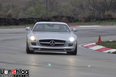

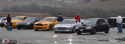

Five Star Ford HPDE at Eagles Canyon Raceway - March 23
Corey White, who has sold us both the 2013 GT and now a custom-ordered 2013 F-350 Dually, is a dealer at a local Ford house. He sells a lot of Roush, SVT, Boss302, GT500 and regular Mustangs and Raptors to folks all over the country. Since he deals with a lot of Mustang folks he convinced the dealership to support both car shows and track events, like this one on March 23rd. We always try to come out and support his events so Amy entered this one in the red '11 Mustang, with Ed and me along for track support. Since my custom ordered F-350 wasn't built yet I borrowed Ed's Duramax dually and his open trailer, too. We could have driven to the track in the Mustang (well, 2 of us), but with the cold weather and rain in the forecast it is always nice to have a truck nearby to store your extra stuff in. And if (when?) something breaks it is handy to have that trailer there to get you home without a call for a flat bed. We have had incredibly good luck with this Mustang for almost 3 years now but eventually something is going to leave is stranded... (foreshadowing!) :D
Photo Gallery: http://vorshlag.smugmug.com/Racing-E...SF-ECR-032313/

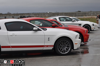

You sharp eyed readers will notice the 18x10" D-Force/Vorshlag wheels on the red car; that's because we kind of knew it might be raining, so we mounted that old set of 295/35/18 Nitto NT-05s (which we cannot seem to kill) onto a set of these 5-spokes for the event. It wasn't a timed event and even just on street tires this car is... well, usually pretty quick at these Mustang-centric events. The Nittos still had visible tread if it was wet, and if it was dry and I wanted to try to kill this cursed set of tires. I left the set of rain-friendly Bridgestone RE-11's on the other set of 18x10's at the shop, foolishly...
This event was like many other HPDE's: made up of a curious mix of sports and sporty cars including lots of Mustangs - from GTs to Boss302s to GT500s to a couple of old Fox AI cars - modern RX8, several Miatas, an STi, and some exotics - a Mercedes SL, a Ferrari 360, a Ford GT. The track was already wet from an early morning rain shower, and it was 45°F and windy (cold for Texas!), so they sent out the Advanced group in these treacherous conditions first to help "dry the track". Just for some slow laps to remove the dampness...

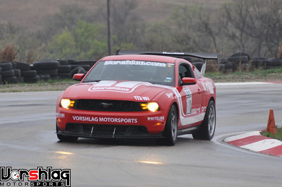

Well it was cold and it was wet and these Nittos excel in neither condition. In the first Red session there were cars slipping off track left and right (I think there were six or seven 4-offs) and even Amy (who prides herself in never having had a 4 off at any track - yet) had a quick 360° spin, but stayed on track, braking into the "canyon" after Turn 9. She said it just zipped around in a quick pirouette, was slick as snot out there, and of course she came in for a look. Never left pavement, nobody was even remotely close to her at the time (they were all going as slow or slower than she was), and no damage done - so no harm, no foul, and I sent her back out.
After that 20 minutes of slipping and sliding around it quit spitting rain, but it was still wet and plenty cold. So after a lengthy delay they sent the Novice group out with instructors, going ultra-slow and "testing the waters" as it were. More spins, offs and not a lot of fun.
Then they put in a 2 hour delay, waiting to see if another storm cell was going to hit, and hoping for sunny weather with some track drying winds. Ed and I had a feeling, and smart phones with radar apps, so we quickly loaded up the Mustang when Amy wasn't looking, before the skies opened up again. Just in case. We told her we could quickly unload it if the sun popped out. While we were all warming up in the clubhouse eating food provided by 5-Star Ford, and cooked by Corey himself at the grill, the skies opened up... rain, thunder, then some light hail. Well, that sent the owners of beautiful Mustangs and Ford GTs scrambling to get the more costly machinery under cover of the ECR garages.
The hail made quite a racket on the metal roof of the clubhouse, and while it was not serious enough to cause any damage to delicate sheet metal, it put an end to the day early. The other big storm cell was coming, so they called the event off (it rained for most of the rest of the day) and gave everyone "a mulligan", with free entry to another ECR track event in 2 weeks...

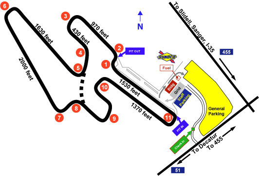

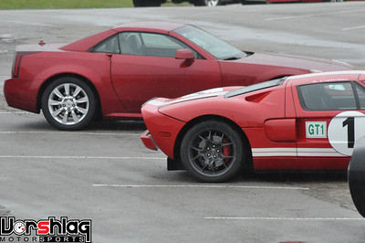

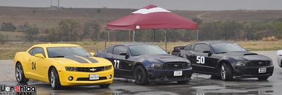

Eagles Canyon Track Experience - April 6th
This HPDE was already scheduled but became the make-up event for everyone that paid for the March 23rd track day. This was another low stress HPDE, put on again by the folks that own the Eagles Canyon Raceway track north of Dallas, with help from some local racers ("The Two Brians") to organize and promote the events. Amy entered and again drove in the Advanced group, but this time I popped in for one of her sessions, too.
We still had full depth brake pads, left over from the previous and much shortened March 23rd event. Since we didn't win any tires at the MSR 3.1 NASA TT event (not enough TT3 entrants on Day 2), we had to save the freshest Hoosier A6s, so we rummaged through the old junk tire pile and found 8 very abused Kumho V710s in my favorite 315/35/18 size. We picked the best 4 and I had Olof mount them "inside out", opposite of how they are marked (not directional but they do have inside and outside marked sidewalls). These tires were long past their prime but had some usable rubber left, if we ran the inside tread mounted out. How bad could it be, right? (hint hint...)
Once again I borrowed Ed's Duarmax diesel crew cab dually, but this time I sprung for a gooseneck hitch (installed by Kurt at Janco Fab, where I store the trailer) in his truck, so it could tow our enclosed race trailer. Ed was all for the idea, as now he can tow my gooseneck trailer with this truck for his own race car, from time to time (like April 28th, when we went drag racing with his car). Having the Mustang stuck on an open trailer in a hail storm two weeks earlier taught us to not skimp on the trailer, even with a borrowed truck - bringing the enclosed trailer brings shelter for the car and people, as well as a LOT more of our tools, gear, spares and food.
Photo Gallery: http://vorshlag.smugmug.com/Racing-Events/ECR-040613/
Left: world famous top fuel drag racer Eddie Hill was racing in an Ariel Atom. Right: Mark Boothe in his Grand Sport C6, a NASA TT1 driver

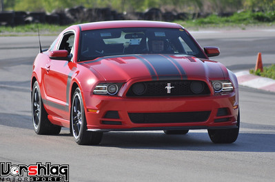

So this day had a LOT better weather, with cool temps and sunny skies. Perfect "Spring in Texas" weather, without the hail storms. There were a lot more cars at this event, both from from the mulligan entries two weeks earlier as well as a few more entrants that heard about the now more regular "ECR run events", with The Two Brians in charge of running the day.
Amy was quick along with a handful of others in Red group this time, putting in some fast-ish ~2 minute flat laps on these godawful tires. She complained bitterly about the twitchiness of the car, wondering "What new parts are on it now?!" And while we rarely give here the same parts set-up twice (always trying new things!) the issues sounded like they were from the "flipped" Kumhos. Well I needed to see how bad they were, so I stole the keys and one of her track sessions...

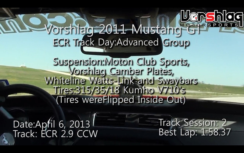

My 1:58 lap was a handful with the tires flipped and HORRIFIC traffic
The video above shows a lot of bad habits in the first few laps, both from a "rolling roadblock" driver in front of a train of faster cars, and from some frustrated drivers held up behind him, myself included. This was in the Advanced group now, so supposedly not full of noobs. There was a GTR driver blocking a line of cars 9 deep for 3+ laps. Poor Eddie Hill was stuck behind him the longest, and I got held up in the train behind Eddie's Arial. Problem was neither the Atom nor our Mustang had enough extra power to pull by this modified GTR on the straights, but OMFG we were both held up badly in the corners. Guy was braking 300-500 feet early, coasting through the corners, then blasting out and blocking us on the straights. At this event we were supposed to wait for a point-by to pass, but this guy's arm was apparently broken, and his mirrors were blocked.
So after a lap and a half of of this nonsense I gave up - I only had one session to run the car that day and I really wanted to push for one lap - to try to see how much the tires were affecting the car's performance, if any. Eventually the guy nearly spun off track into Turn 4, where Eddie pointed me by, and into Turn 6 I passed him in his ridiculously early braking procedure. Apparently he had almost the entire Advanced group ready to kill him by day's end, so I wasn't alone. "Time for the Green group, pal"...
As I say many times in the video, the tires felt terrible beyond words. Flipping these Kumho's inside-out made for super twitchy car under braking, and mid-corner the car would swing wildly from under- to oversteer. So yea, don't ever flip a Kumho V710 inside-out! This isn't always the case on asymmetric marked tires, but Kumho MEANT it. Lesson learned - always try to learn something when we are at the track, even if it is a little thing about a certain tire brand's "mounting limitations".

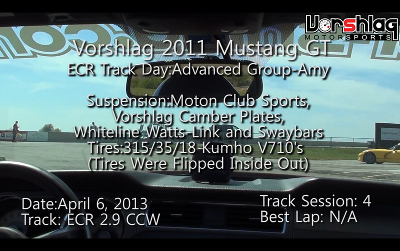

Amy was back in the car for sessions 3 and 4 and having a good time. Her parents and her uncle arrived mid-day and were cheering here on and watching her drive on track. For the 4th session she asked and was allowed to take a passenger, her out-of-town uncle (above), who was all smiles in the right seat. She went out to take some ~8/10ths laps in the final Red session, and somewhere in Turn 2 on her first hot lap something broke...
Click for in-car video of the transmission going "BOOM!"
As you can hear in the video above, Amy knew something broke in the transmission and she even figured out that the other gears still worked and managed to get the car back around to the pits. Once she got back I took it for a quick spin around the paddock and realized that, yep, 3rd gear was GONE. All other gears worked and the transmission functioned silently, just minus one gear. Hmm....
It was the end of the day and we drove it into the trailer for a diagnosis back at Vorshlag. This ECR track day was still a lot of fun, with good cool weather and some quick-ish laps, other than the traffic in my session and the whole "trans go boom" issue.

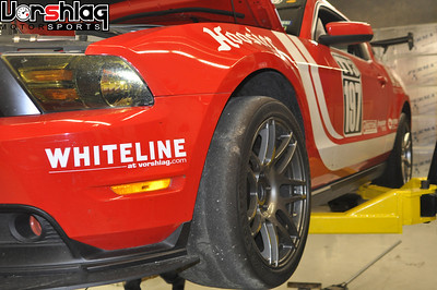

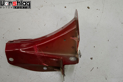

Red Mustang in for a check-up after TWS. Note the impact (tire klag? rock?) that the LF fog light grill took
Sure, we have put a lot of track and autocross miles on this car in the past 3 years and some sort of driveline failure was bound to happen, I guess. We still have a 100% stock engine, cooling system, and clutch. The rear axle has had heat issues already (melted axle seals, burned up stock differentials) as have the brakes (we've quit replacing the caliper dust shields, which I can melt and/or catch on fire in one session... sometimes in one lap). The Tremec TR-6060 has provisions for an internal pump and external cooler, which the World Challenge and other endurance racers utilize, and this is something we are exploring for the Getrag, to prevent this from happening again. We will have to use an external pump, though.

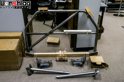

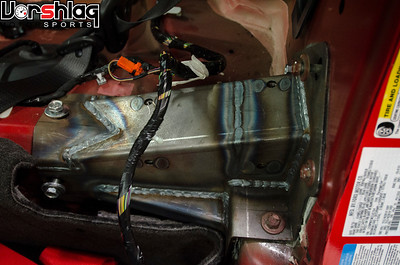

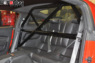

Another nice set of parts made by another company is the Maximum Motorsports 4-point roll bar we ordered and received for the red car. Wow, this is a nicely made piece of kit! Sure, it is 1.75 x .134" wall DOM and not the normal .120" wall tubing you see in most road racing cages, but it is stout and put together with very fine tolerances. The MIG welding is great and the Laser cut, CNC bent, and welded lower platforms are amazingly well done. Just click on the images below, and look at the factory stamped steel bits they replace.
Ryan spent about 5 hours fitting, installing, and tack welding the bar in the car before it came out for final welding. The rear bars are shipped loose, with stubs welded in place for final fitting. This way the entire unit ships flat for big cost savings, and it likely makes for a much better, custom fit to the car this way. I think he said he had it in and out of the car 4 or 5 times but that is normal - patience is your friend, as you don't want to rush a roll bar or roll cage install if you want it to fit well and base safe, or scratch up interior bits. They include great instructions and a "fit-up bar" made of PVC for marking the side panels that have to be trimmed and a hole cut, to fit around the rear downbars.
Due to time conflicts with other customer work and an upcoming race we left the bar in raw steel and hooked up the harnesses and reinstalled the Cobra seats for the TWS event at NASA. This bar mounts right onto the back seat "shelf" so it is behind your head, for 100% safe use in street driving. Having steel tubing near your head (roll cage or a closely mounted B-pillar main hoop) is just asking for major head trauma in a street crash, sans racing helmet. But in the two pictures above (taken in the past 48 hours) you can see that we have since removed the bar, powder coated all 5 pieces (bar + 4 mounting plates) and weighed it all at 63 pounds (which is almost exactly what I predicted it would weigh, and nearly identical to the Kirk Racing 4-point bars we've installed in BMW E30. E36 and E46 cars). The gloss black powder coated roll bar is going back into the car as I write this, with the back seat, rear interior panels, and the Cobra seats are going back in.

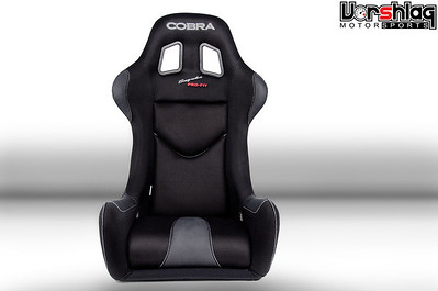

Vorshlag now Authorized Cobra Stocking Dealer
We bit the bullet and made a big WD buy-in for Cobra seats. We have needed to become a dealer for this brand for years, as we have used their seats in too many of our own builds, not to mention installed customers' Cobra seats. That buy-in also gave us access to Puma, Aplinestars, OMP, Sparco, Momo, Schroth, Bell, Arai, Peltor, and much more. We're still sorting through this big shipment of Cobra Suzuka, Sebring, Evolution, and Imola seats and do have plenty of inventory.
Installation of Cobra Suzuka Pro GT Kevlar seats, custom sliders, Schroth harnesses, and Sharkworks harness bars into a C6 ZR1 at Vorshlag
Ryan is going to build some display stands for a few models of Cobra seats that we want to keep on hand, so pretty soon you will be able to stop by and test out various Cobra models in the Vorshlag lobby. We already have two different Cobra Suzuka sizes in the 2011 Mustang GT, which stays up at the shop now almost all of the time, too. Two more will go into the BMW E46 Alpha car, also kept here at Vorshlag. And we are making better chassis bracket solutions for several cars as well, and hopefully can make produciton runs of these soon. I have yet to see an Off The Shelf bracket solution that fits a given car without putting the seat into the roof. Look for more info about these various seating products on our website soon.

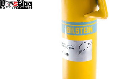

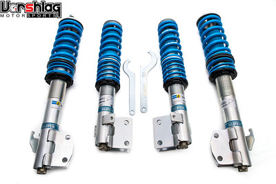

Vorshlag/Bilstein StreetPro Suspension Kit
Word has gotten out about this strut/shock/spring/camber plate set-up we've put together for the S197, and tested for many months. We have been exploring and testing various Bilstein and Bilstein motorsports shocks since we became a dealer last June.
In late December we ordered and received a "Bilstein BTS" shock/spring kit, then tested the spring rates of the matched "BTS" springs these inverted Bilstein B6 non-adjustable monotubes. These struts and shocks have 36 mm pistons (huge compared to any twin tube), and as such, they react to damping forces at much lower shaft velocities. The nicest thing about the B6 strut is that it is shorter than stock, so it is made to work well at lower ride heights...
So after we received the kit we worked with a Vorshlag test pilot Tyler Rogers, and planned to put this set-up on this car in early January of this year. Since a handful of haters have said that the S197 Bilstein monotube rides poorly, I wanted to do some before and after testing with the "BTS" lowering spring. I made this lengthy before-after video (see below), and found the ride of the Bilsteins to not only be acceptable, but exceptionally good. And it was better than the stock noodle springs and $30 OEM struts could ever hope to provide.
Another interesting side effect of the inverted 40mm shaft Bilstein is that it is 2 pounds lighter than the OEM twin tube junk, per strut. So it is strong, will have less flex under load or at full extension, but you shed some pounds as well.
Once we had a handle on the various lowering spring rates and picked the Bilstein BTS springs for this car, we scheduled Tyler's 2012 Mustang GT Brembo car into the shop. We measured the OEM ride heights, camber, and I took the "before" test drive around our pre-set "test loop". Then we got it onto a lift and took off the OEM bits...
While the stock struts and shocks were off we measured the lengths relative to the Bilstein B6 bits, then rated this OEM springs. The new parts all went on and functioned perfectly. The quality of everything we've received from Bilstein has been second to none. The rear shocks came with new top mount bushings and the springs were made to go with the OEM top mounts.
Of course we cannot leave anything alone and instead of using the OEM or even a GT500 top mount we paired the front struts with the Vorshlag S197 camber plate and our OEM upper spring perch / sealed radial bearing solution.
We have since run these with various aftermarket lowering springs and they work very well, wihtout the bottoming you tend to see with stock length struts and shocks (OEM, some Koni, Tokico, etc). We now put the Bilstein shock/struts together, with your choice of 5 different lowering springs, and assemble it all with the Vorshlag camber plate and call it our "StreetPro" suspension kit.
The end result is a really nice suspension kit that is complete and READY TO INSTALL, right out of the box from Vorshlag. There is no need to borrow a spring compressor to remove your upper spring perch/top mount to reinstall on the new bits, as we include the Vorshlag camber plates and pre-install the springs you have chosen, and ship it all to you ready to go. This makes the install take 1/2 the time as most spring/shock installs. And at a hair under $1500 this is a track worthy, street friendly kit that works very well, has a "lifetime warranty" on the struts/shocks, you can alter the camber quickly track-side with the Vorshlag camber plates, and includes inverted monotube shocks with shortened strut/shock bodies, for more bump travel at lower ride heights. Good stuff.
Link to our Vorshlag/Bilstein StreetPro product page: http://www.vorshlag.com/product_info...roducts_id=559
Before and After ride heights on a 2012 Brembo GT, with OEM then Vorshlag/Bilstein StreetPro suspensions
This animated gif above shows the before and after ride heights with the BTS springs. The 5300-K and 5300-P springs are a tick lower. With the BTS springs the car was lowered by 15mm up front (close to 0.75" installed) and 38mm in back (close to 1.5" installed) for a level stance that dramatically improves the look of any S197. This set-up is popular because it offers good ground clearance and a favorable ride. The optional lowering spring kits shown below offer even more aggressive ride heights and spring rates. Tyler and his wife both love the look and ride with this spring and shock combo, and the quality at this pricepoint is impossible to beat.

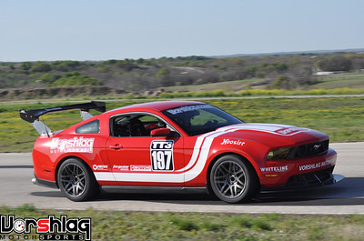

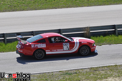

NASA at Texas World Speedway 2.9 mi CW - April 19-20th
I was admittedly nervous about running this April event with NASA. Even though I started doing track events at TWS back in the late 1980s, I couldn't remember running the 2.9 mile course "backwards" (clockwise) in the thousands of laps I have running this road course in various configurations and directions. When people ask I will say ECR is my home track, and I know it best, but TWS was my first track, and one I will likely have the most laps on for a good long time yet. I had some folks saying the terminal speeds off the main, banked straight and into the Turn 15 corner would be "well in excess of 150 mph", which is different from any other road course in Texas - all the rest of which involve fairly low peak speeds (>125 mph). ECR, MSR-C, MSR-H, GSS, HHR, TMS.... all of our other tracks are much slower than TWS, and the TWS 2.9 CW is the quickest of them all.
And all I needed to do was have a "4-off" into T15 at 160+ mph... where my room mate in college went off, flipped 4 times, and totaled his car. Of course this was unlikely, but who knows - all I'm saying was this CW 2.9 mile course was just a tick out of my comfort zone, mostly from lack of experience running it this way.
We loaded up on Friday, once again borrowing Ed's Duramax dually, then Amy and I bombed down to College Station, TX, leaving at about 7 pm and hitting massive Friday downtown Dallas traffic. We arrived about 11:30 and managed to stick the truck + enclosed trailer into the hotel parking lot (not always an easy job), got a few hours sleep, then towed out to TWS early Saturday morning, hoping to get a decent paddock spot. BZZZ! Wrong. The place was packed and we were stuck out in a grassy parking lot, well outside of the normal garage area. Oh well - gotta rent a garage or get their early to guarantee a good paddock spot.
No worries - we had the entire lot to ourselves and it proved to be a great spot to watch the racing (very near Turn 3), and the weather was so perfect we didn't even roll out the shade awning. We got the car ready for Time Trial and Amy and I helped fellow racer Joe D change over to some Vorshlag/D-Force 18x10" wheels and Continental slicks on his 2013 Boss302 Leguna Seca.
When we entered, I registered for Saturday only and Amy was signed up to drive Sunday, but we noticed that some of the eight TT3 cars didn't arrive on Saturday, so I paid the difference and signed up to run TT both days, so we could make sure we had at least 5 in class both days - in the hopes that somebody could win some tires (minimum 5 cars in class to pay out for Hoosier). I ran the first Saturday session with Amy riding along, since the times don't count on that session (but do count for gridding in TT session 2). I was pretty apprehensive and put in some 1:55 laps before Amy said "Enough!" and I came in after 4 laps. She is a terrible passenger... or I am a bad enough driver that she can't ride with me, one of the two. :D There was all sorts of mayhem in the first session, with a Mazda2 spinning in front of us going into Turn 15, a Porsche went off Turn 7 on the next lap, then another car was off, and by lap 4 a Corvette not only went off track but was on fire before Turn 4 (not much damage). Wow, what a mess. They called the session early and we all "had a talk" about driving wild in TT. ;)
When I went out for TT session 2 I was gridded a bit better and got some quicker times, into the 1:51s with a best of a 1:51.749, which put me in front of TT3 by a good bit. See video below...
Click above to see in-car video from the TT3 winning/lap record setting 1:51.7 lap in session 2
Saturday TT Final Results: http://timingscoring.drivenasa.com/N...ay%20Final.pdf
I went out again in session 3 but the temps were rising and I didn't get any quicker, with a 1:51.9. I didn't bother to go out in session 4, as the temps were on the rise and I didn't feel like there was much left in the car, at least with me driving it... a few tenths maybe? The Hoosier A6 tires always seem to put in their best laps on the FIRST hot lap, and work best in the FIRST sessions of the day (coolest temps), so I was on a steep learning curve - trying to learn this course and put in my best flier in my first lap of each day, heh. ;)
It looks like TT3 ended up having 7 in class for Saturday with a C5 Z06 Corvette taking 2nd with a 1:54.057, with Jerry Khoury's ST2/TT2 Corvette somehow sneaking into TT3 for 3rd (he is going to get a new tune to become TT3 legal soon, but I didn't mind, as it gave us more TT3 entries) and a Super Touring Ferrari F355 Challenge car in 4th. Looking at the results I was very happy to be ahead of the class that day, with so little seat time on this "backwards" 2.9 mile configuration.

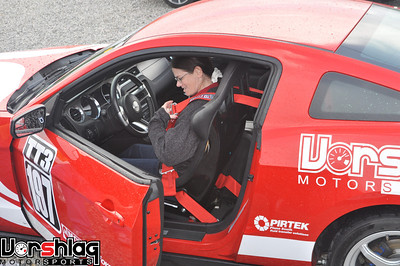

Sunday was supposed to be Amy's TT day for all 4 sessions, but we had a lighter attendance than we thought... and since I was able to pull out the win Saturday I went ahead and signed up for Sunday, and agreed with Amy to only take one TT session, the second. Sharing a car sucks. So she went out in TT session 1, but felt she wasn't getting enough seat time so she went out again with HPDE3, after her first TT session. I rode with her, trying to get her to learn the course and push the braking and acceleration zones, which were holding back her times all day.
NASA @ TWS Photo & Video Gallery: http://vorshlag.smugmug.com/Racing-E...il-20-21-2013/
Anyway, since I was the quickest car to show up for grid on Sunday 's session 2 grid, I lined up P1, which makes for a nice, traffic-free session - well, for at least 2 laps, until you catch the back of the field.
Luckily I was able to find a tiny bit more time and my first lap 1:51.530 time was a new lap record and took the lead in TT3. But not by much! Jerry Khory slapped on a new set of Pirelli slicks and dropped FOUR seconds, nipping at my heels by less than a tenth of a second. GAH! I didn't see that coming. Now his ST2/TT2 car running in TT3 gave me a bit more reason to be concerned, but Jerry was cool and agreed to be re-classed if he beat me in a later session. In the end I held onto the TT3 win by .071 sec and scored another lap record and 2 more Hoosier tires; 4 tires for the weekend. That was a smidge quicker than the newly set AI qualifying (1:52.9) and race lap records (1:53.8), set by Mike Patterson on the way to four wins in American Iron over the weekend, in his AST equipped 4th gen LS1. So that's 3 lap records for TT3 at the 3 NASA Texas events so far this year. :)
Amy was struggling a bit but managed to get down to a 1:59.721 in her last session, just eeking under the 2 minute mark. The high speeds were a bit more intimidating to her, but with more seat time I'm sure she'd find the time that was in the car.

There was a heated battle in TTB among several Vorshlag/AST equipped E46 M3s, with Allen Page taking the win. And KenO got his car's right side damage all fixed up, from the TT incident at MSR-C. Sadly there was another TT incident this event, and more meetings other changes in TT will follow.
The red E36 above has a PlastiDip spray paint job, which was interesting to talk about, too. And while I didn't instruct at this event I was definitely busy, working on a number of people's cars who had issues, including the OEM splitter that decided to come off at 145mph on a Leguna Seca, another stranded car we helped get towed and repaired in town, wheel changes, and other various "hey, come take a look at this" requests. But it is all good, as this is why we come to these events - to meet folks and try to help out. And sometimes, just maybe, win a set of tires. :)

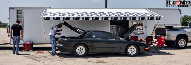

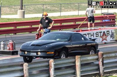

Drag Racing at North Star Dragway, April 28, 2013
Just to show how little time off we actually get from racing, this last Sunday I went drag racing with my friend Ed - who has helped us at countless events over the past few years. It was my pleasure to go help him at the track for a change! Amy, Ed and I towed out to this 1/8th mile strip in Denton, TX and spent the day sorting out his 4th gen LT1 powered, 275mm Drag Radial Firebird.
This was the first time he had this car out in 4.5 years, and a lot of the recent work on the rear suspension and exhaust has been done at Vorshlag. Used to run 5.30s in the 1/8th, so it isn't slow.
Anyway, had a good time and I learned a lot about the "Texas 275" and "Extreme 275" classes of drag racing. Good stuff.

Since I have complained publicly about the lack of track maps being available at many tracks and events before, and I feel that the lack of maps/corner numbers/pit lane routing has led to issues at some events, I put my money where my mouth is and we made the track map above. Brandon here at Vorshlag took an existing but very hard to read color track map from NOLA and created a line graphic shown, added legible corner numbers, and marked where NASA TT race director Ken Brewer wanted the TT group to bunch up on the out lap. All of the various alternate configurations were removed as well, to only show the course we were to be driving that weekend. We printed 70 of these and handed them out at the TT meeting as well as to our HPDE students. This went over so well we are going to do this for all upcoming NASA Texas events we go to in 2013.

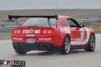

Late morning Friday the rain stopped, the clouds parted, and the sun came out. It gets brighter and brighter...
Even with the rain no longer falling there were still significant puddles that covered the track at corners T8, T13, T16 and all down the front straight. I was short shifting 4th and 5th on the front straight to keep the tires from breaking loose at even the reduced speeds of 120+ mph we were seeing. The massive lake at T13 was DEEP and there was no way around it - you just had to slog through it. We named it the "sippy hole", and the lake at T16 wasn't abating much either. By the 3rd and 4th morning sessions we were the only ones brave (or fool) enough to be out on track and Amy and I pounded out dozens and dozens of laps each. Eventually we were just making laps to try to push water off the track, and each lap was making a difference - with water splashing 20' high at some "stream crossings". The interior of the car was pretty wet, but we cleaned it out during the lunch break. And that's when we noticed the NOLA crew go out in 3 track drying trucks, dragging massive air blowers, and they dried off the track! They did an awesome job for about a solid hour and it made a massive difference. Well, T16 was still wet and you had to tip-toe around that corner, but the rest of the track was completely dry. They again warned us after lunch "if you go off, you WILL get stuck", but we never dropped a single tire in the mud all morning during the rain, so we weren't too worried.
Off with the street tires ("poor man's wets") and on with the well abused A6 tires, late on Friday
We didn't shoot any video during our rain driving, as it was pretty slow, but it sure was entertaining! Probably should have got a few laps on video to show how wet it really was. You know its bad when NOBODY will go out on track with you, but we didn't care - we were learning the track layout, and that's what mattered most. During lunch we saw the track drying and swapped the car back to the Forgestars mounted with 1 weekend old Hoosier A6 tires we used at TWS (I will talk more about the RAPID wear rate of A6s at the bottom of this post), which had some tread left. Then we both took a full 20 minute session each in the dry. The times dropped from the 2:30-2:15 range in the wet to 1:53.8 in the dry for me and 1:57 for Amy.
During these afternoon dry sessions we would come in from the track to the hot pits, where Ryan was waiting to check/bleed down tire pressures and tire temps, while Brandon was shooting pictures from numerous locations. Ryan noted some tire temp issues and adjusted the camber and tire pressures to eventually get the temps even across each tire, and the performance felt better, too. It is always a big plus when we can have him at the track with us! He does track-side work with a World Challenge team (and is at COTA while I'm writing this) so this was nothing new for him, and in fact he said "this is the least work I've ever done at a race weekend. I like it when drivers don't crash or blow up!" And the pictures always look SO much better when Brandon can come along, as well.
Left: We used up 3 of the 4 scrubs on Friday. We had one "keeper" and the rest were junk. Right: New tires going on for Saturday

Check out the outside rear tire - looks like a lot of deformation, but remember: this is a 315mm tire stretched onto a 12" wheel
Overall the car was working pretty well and it was fairly easy to drive. The picture above (Brandon shot some great ones!) shows the car loaded up exiting Turn 16. The outside front tire still has a tick of negative camber with the car fully loaded up, which is what you want. Body roll is within the range we can accept, which with only 600# front springs and a 3800 pound car as raced, is remarkable. There still seemed to be a high speed push, which we feel is completely aero based. The rear APR wing is making far more downforce at speed than the front factory Boss302 Leguna Seca ABS plastic splitter. This was very apparent when taking Turn 8 deep into 5th gear (124-125 mph at corner entry, according to data) and after braking into Turn 1 (with peak speeds of 140-141 mph). Throughout the weekend I was edging up my courage and taking Turn 8 at Wide Open Throttle, then braking significantly for Turn 9 and downshifting mid-corner. Watch my Sunday lap video (in the section lap below) and you can see that it is understeering significantly when cornering at high speeds, as well as real time track speed pulled from the data logger.
