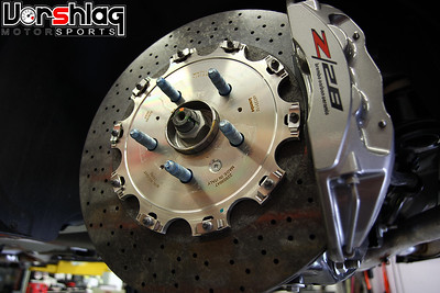

The S197 Mustang is a heavy car, and has a lot of power and the potential to go fast around a road course. This means one thing: it is going to turn a lot of kinetic energy into heat, and that heat has to be dissipated or it can boil the brake fluid and then you will lose your brakes.
I personally feel that the factory optional 14" diameter (355mm) Brembo front brakes are a damned good set-up, and we've kept this on our car for all 4 years we've raced it. The move to larger 15" (380mm) rotors normally means you are most likely going to have to use at least 19" diameter wheels, which I am loathe to do for many reasons - namely weight, cost, and poor tire selection. We've recently found some 18" solutions for this brake, which I will discuss with our 2015 Mustang very soon (which will keep the 15" brakes). I feel that 18" wheels and tires are the sweet spot right now, and we do everything we can to keep the 14" front brakes cool (and have upgraded to 14" rear brakes as well, to help shoulder some of the load).
In a previous installment in this thread we showed a new 4" brake duct backing plate that we built for our TT3 Mustang, after the issues I had at Road Atlanta. This one-off set is shown in the first two pictures in this post. Now our 3" ducted brake backing plates are more than adequate for 99% of the S197 track crowd, but for heavier/faster cars or for race cars that run in longer stints/races than a typical HPDE session or 20 minute sprint race, the 4" ducts are the way to go. Here is our oval 4" ducted front brake backing plate for the S197 being built.
Ideally you want to keep the incoming cooling air going to the hub and inside the rotor face, which was easy on the 3" ducts but the 4" round tube had a lot of the air pointing right at the rotor itself. Our new 4" oval duct backing plates now force almost 100% of the incoming air towards the hub and inside the vented part of the rotor, which will allow the rotor to "pump" the air out through the vanes and cool more effectively. These 4" oval tubing sections were first hand rolled (slip roller), welded in round, then ovaled using a couple of custom made tools. It will probably make sense to just buy 4" oval tubing, but it was pricy and we wanted to make a small run of these first - we like the finished look on these first few sets and will make another production batch soon.
When we were making the 4" oval plates we also updated our 3" backing plate design, choosing a different Ford part number for the backing plate itself. This new backing plate has more "inset" area for more even brake cooling around the hub and actually takes a little less time to make, as big chunks of the plate don't have to be cut away from this design. The oval versions are more expensive and time consuming, and fewer of these will be built and sold, so they are priced a little higher.
Both the 3" and 4" backing plates are about 1.75 pounds for the pair, so the need for the super expensive carbon backing plates seems a little spendy, to me. But the backing plates and hoses are only part of the brake cooling solution - that cooling air has to come from somewhere. Ideally you want to get high pressure air from the front of the car that has a provision for the 3" or 4" hoses to clamp to. On the 2010-2012 Mustangs the factory fog light holes in the "CS" lower fascia (see below, left) are an ideal way to get the brake cooling air to the front rotors and backing plates. If your 2010-12 GT didn't have the CS lower, get one, and then just don't add the fog lights... this becomes an ideal place for getting inlet air for brake cooling. We've even modified these openings to accept 4" tubing and hoses on our car.

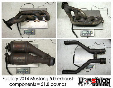

Another mod we did to Steve's car was installing ARH 1-7/8" Full Length headers and their catted X-pipe. We've done a lot of these but the install never gets easier, heh. Due to the massive girth of the 5.0 Coyote motor getting access to remove the stock exhaust headers is difficult. There's a half dozen ways to do this, but we've found that it goes easier (least time and least busted knuckles) by dropping the front crossmember down about 12 inches.
continued below
Vorshlag-Fair
Official Site Vendor
Nov 12, 2010
1,592
112
Dallas, TX
continued from above
The factory service manual shows a custom engine hanger, but we use an off the shelf hanger, which sits on the front fender rails just under the hood. We set it forward, just above the front of the engine. After adding longer M8 bolts and chains to the only two access bolts at the front of the block (goes through the front of the heads, through the front cover), the front of the motor can be secured. Then you raise the car on the lift, remove the front motor mounts, starter, disconnect the steering shaft, loosen the front crossmember bolts, and drop the crossmember down while supported on a telescoping hydraulic jack. On this 2014 model we had to drop the A/C compressor (didn't have to on 2011-13s, so something must have changed slightly) to access the right front header bolt.
Once the crossmember is down it is a game of wrenches, extensions and patience, but the stock stuff comes out and the new bits go back in. We've done a half dozen of these and it always takes about 7-8 hours, with a lift and all of these specialized hangers, jacks and tools. But the results, the added power at all RPMs, there's just nothing else that adds this much horsepower for the money. We typically see peak gains of 35-40 whp with these headers and cats and low to mid RPM gains of 60 whp. No other single bolt-on can do that without adding boost or nitrous.
And as we show above, there is also a weight savings when going from the stock tubular manifolds, cats and H-pipe to the 304 stainless ARH long tubes, high flow cats and X-pipe. We call this a Win Win: a nine pounds drop isn't anything to sneeze at, and there's even more weight to be found in the axle-back exhaust, which we recommend MagnaFlow for. One question we get a lot when choosing the ARH header primary size is: Won't the larger 1-7/8" primaries give up power at low RPMs to the smaller 1-3/4" primaries? The answer is NO. We've seen the data, and talked to the owner at American Racing Headers, and they only offer the 1-3/4" version "because people asked for it", but the 1-7/8" version "always makes more power, at all RPMs. Its the obvious choice". We couldn't agree more.

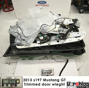

I showed Jamie's GT briefly in my last S197 build post, as it was after we had received the car with much of the interior removed. We weighed it at 3276 pounds with one front seat, which was down from 3553 pound weight before the interior was removed (no back seat, race seats, AST coilovers, Maximum 4-point roll bar).
Jamie brought what he pulled out and we weighed 171 pounds of interior bits, not including the front seats, which consisted of the interior panels, carpet insulation, and 3 days worth of scraping of seam sealer from the floor pan. It has lost a lot of bits and pieces since then as well as gained a wing.

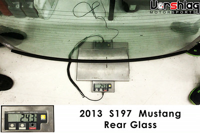

We are going to add a simpler and much lighter defroster, then the dash pad will go back on, as will the factory gauges and main gauge binnacle. The wipers, lights and a few other bits will stay but the A/C and a lot of interior and under-dash bits are coming out.
We've started removing and weighing lots of parts, and you can see the lightweight defrost unit that will go back in (above right). The glass is all out and weighed, as is the A/C bits. Look for more updates on this project in my next update in this thread with more weights and cage pics. The rear and side quarter glass will be Lexan in the final iteration.

The side, rear quarter glass is fairly light at only 3.0 pounds, but each one is relatively small. But we found some pounds in the A/C system removal, shown below...

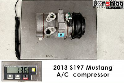

To be honest, I thought the A/C compressor would weigh a good bit more, but it only tips the scales at 13.6 pounds. Likewise the condenser is a svelte 5.3, but removing this is more to help airflow to the radiator. We pulled the condenser off of my 2011 Mustang for similar reasons (and because it got busted at RA), but it will be reinstalled and functional for Optima event in Vegas. We gotta stay cool on the road rally, yo!
We had removed the guts from both doors when I wrote my last installment, but hadn't weighed all of it, which included: interior door panels, speakers, trim, weatherstripping, door glass, window motor, regulator/tracks, and inner door structure. As you can see it all weighs in at 67.2 pounds, but that doesn't include the door bars (which were left in place last time).
As you can see above left, the glass, regulators/tracks and motors alone were 34.2 pounds of that. And after the door bars were built it was shown that the OEM "crash bars" would be in the way, so 4 quick spot welds later those were both removed, for another 7.2 pounds of steel. All together, the door modifications for the roll cage installation have removed (67.2 + 7.2) 74.4 pounds. It is all adding up...

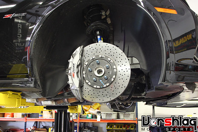

I think it helps the S197 crowd to see what the competition is up to, right? So let's take a look at some of the features of Chevy's new track terror pony car: the $75,000 Camaro Z/28.
The Carbon Ceramic Brakes are the most outlandish thing on the Z/28 - and the most delicate. These massive yet lightweight carbon ceramic 2-piece rotors are mated with 6 piston front and 4 piston rear calipers and really can make this 2 ton terror slow down quickly (1.5g braking, as tested). But you have to be VERY careful around these rotors - one nick to these brittle beauties can damage them to the point of being ruined (if you don't catch it they can explode under heavy braking). We have to always take SPECIAL care around these rotors on ZR1s, when removing or installing wheels or working around them with metal tools.
The cost to replace all 4 rotors can nearly eclipse FIVE FIGURES ($1200-2400 each, depending on where you get them). And they WILL wear out eventually, and do so fairly quickly if you track these cars. After talking to the guys at AP brakes at SEMA, well... I won't be lusting after CCBs any longer. They have brisk sales of AP iron brakes to replace CCB systems on track driven Porsches and the like. Their main concern was maximum heat attainable - the CCB rotors can only reach 1600°F and then they stop shedding heat, after which they start to wear exponentially. Iron brakes can reach 1900°F and still be shedding heat. AP said they have had customers go through a set of CCB rotors in one track weekend.... ouch! Just be careful what you wish for. I'm glad that Ford eschewed CCB for the GT350.
