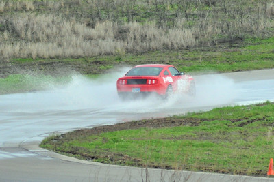

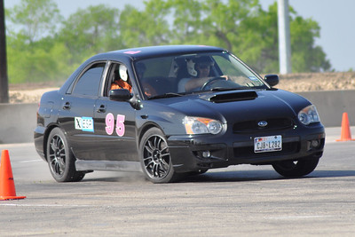

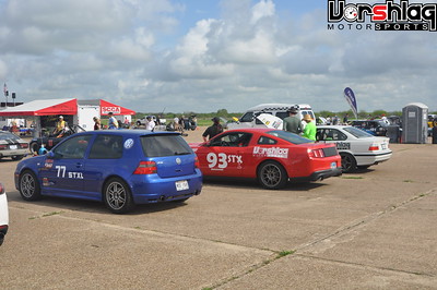

Last 2011 Autocross

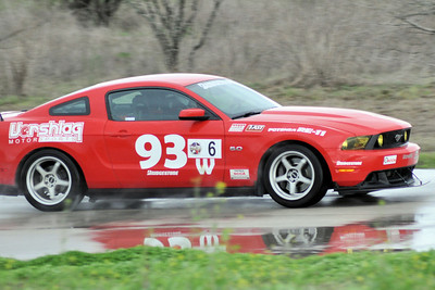

Overall, it was actually a very fun day, surface degradation notwithstanding. Jarrett Jan laid out a pretty fun course that was technically challenging, plenty long (60 seconds), yet well marked. The hard working SCCA crew spent some serious time cleaning the course surface before the first runs, using brooms and air blowers to move hundreds of pounds of gravel off line. So the first run group has some clean course runs. :) The weather was looking very iffy (high chance of rain), and due to a site-forced re-scheduling, the event was moved a week back from its original date, so we were expecting a very low turn-out - but 82 racers made it out and we had a great event, running in STU and STU-W.

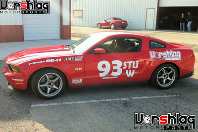

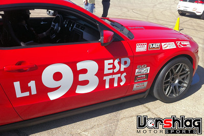

New Tires, Wheels, DDP pistons in AST struts

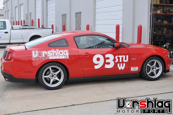

So yea, if you were paying attention just then we didn't run in STX. Let me back up a bit to explain why. In July of this year Amy won a random drawing for a free set of Bridgestones at the NSTC event. One of those "fill out this survey" deals. Whatever the reason for the tires, Amy already had a great relationship with Bridgestone for several years, after winning a National Championship (STU-L) on them in 2007 and being sponsored driver in 2008. So we were excited to be running their tires again, no matter how we got them. :) They sent us a set of 275/40/18 RE-11s (the biggest 18" size they made, by the way) and a big box of decals, and we mounted them up on the D-Force 18x10" wheels on Friday before the autocross. I gladly put on all of the decals they sent - give me $1400 of free tires and I'll damn sure run your decals!

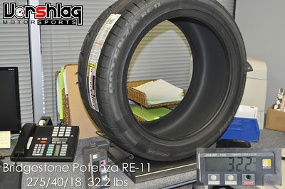

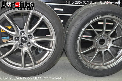

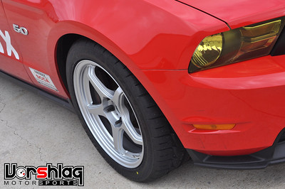

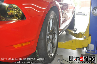

We've got pallets of these 18x10" wheels (5x114.3 mm PCD, fits '05-up Mustang and '08+ Subaru Impreza; I'm almost 100% certain it fits the RX8 as well - will know soon!) arriving at Vorshlag right around the end of this year ($300, 19 lbs!) so I really wanted to do an autocross and a track day on the wheels first, and fit them with something wide like these 275s - which fit the 10" wheels perfectly. Sure, a wider tire would work even better, and for a more serious STU effort we would go with a 285mm tire. It was just that the widest RE-11 was this 275, so that's what we asked for and received. We'll use them for street use, drag racing, maybe a random track day, and this last autocross of the year. Good test miles on the D-Force wheels, for sure.
I was really impressed by these RE-11 - I think its just as fast and as competitive as the Dunlop, Hankook, or Yokohama. We drove that day in the cold and later when it warmed up a bit, and it was ripping up pavement. I think the RE-11's higher price and "lemming effect" of the online community has given this tire a bad rap. I'm going to start keeping the RE-11 on my "go to" list for Street Touring choices. Also street drove on them Monday in the rain and I was able to use 100% full throttle in 1st gear. That's never happened before on this car... the Pirelli's are a joke in the wet. These RE-11s are stupid good in the wet.
These wider/taller tires fit the 10" wide wheels and the car PERFECTLY, with the tall 40 series sidewall making for great ride quality on the street. Filled out the big wheel openings and were only 1/2" shorter than the mammoth 255/40/19 tires it came with. Anything we can do to lessen the effective rear gear ratio (3.31) is a plus, extending 2nd gear speeds even higher - into the mid 70 mph range @ 7800 rpm.
So I was curious if the wider and significantly taller tires would be a significant performance improvement, going from the 18x9" wheel and 265/35/18 Hankook RS-3s to the 18x10" wheel and 275/40/18 RE-11s. The 265 Hankooks had so much shorter and stiffer sidewalls, I felt the 'Stones would be a big improvement. And I was right.

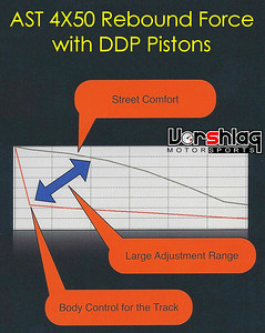

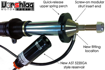

We also got to try out some brand new shock pistons from AST - their new Double Digressive Pistons, or DDPs, were installed into our 4100 front struts a few weeks ago. We have Moton Clubsport doubles ready to install for this car but have been waiting to try the DDP equipped (and renamed) 4150 AST shocks at both autocross and track events first, before we switch to the Mo's.
I'm glad we waited! These DDP pistons are amazing - they ride even better on the street than before, but when you turn up the knobs they make some SERIOUS rebound forces. This piston is a game changer, and starting in 2012 all 4000 series ASTs will have these pistons (and a new shock name). Be prepared for a slight price increase on the AST 4000 series on Jan 1st 2012 - but the added costs will include these DDP pistons, improved top guides, upgraded seals, aluminum shock bodies, and several other innovations - all things learned from racing in GRAND AM in 2011 (where ASTs took 28 of the 30 podium positions in GS for the year!). The new 4150 is coming soon...

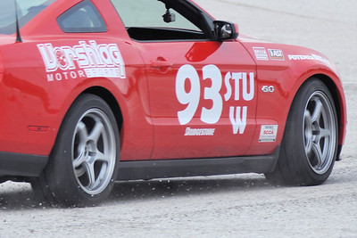

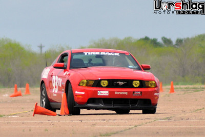

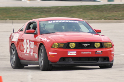

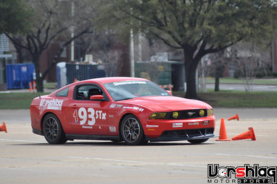

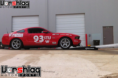

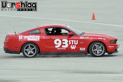

This was also our first "normal" autocross event running with the additional ~30 whp from the ARH full length headers. We picked the larger 1-7/8" primary headers with their cat equipped X-pipe, and it added a very noticeable bump in power across the entire RPM range, but strangely added no additional outside noise (as measured in our WOT and drive-by sound tests - see previous thread entries here). The car feels so much quicker, but I was worried it would be even harder to control wheelspin on corner exits.
Boy was I ever wrong. The other changes (wheel, tire, and DDP pistons) must have combined to do something magic to the car - it had corner exit grip in 2nd gear like NEVER before. As long as I kept the outside/loaded tires on the clean line it was clawing out of corners, and the car was FAST. I was running in STU since it was +10mm out of spec for STX, but I still compared times to the serious STX we have in our region, with some outside region drivers arriving as well (Paul Carrig's DSG/AWD VW). So STX ran in heat #2, and I ran in heat #3, at the end of the day when the course was the dirtiest possible (there were piles of gravel just offline). Still, for the first time all year I was able to beat Ledbetter and his co-driver Brian in their 328is, and was only .018 sec behind Maxcy in his 328is STX car. That was nice, and we have still barely scratched the surface of the prep on this car. Amy won the PAXed "Womens" class, having to put an extra 1.1 seconds on Jen Maxcy in her STX car to win by a scant .075 sec on PAX, since the STU factor is so much worse (Jen won the W class for the year - congrats!).

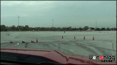

Left: Terry's Run 4 in-car video Right: Amy's 4th run (timer borked). Her 3rd run is here, which won "W".
So in the end, I PAXed 13th overall, which was my best PAX finish in a long time; Amy PAXed 31st, which is far from her best. She was a full 2 seconds back from my times but I think the unexpected corner exit grip, lateral grip and braking traction from the new tires/shocks/wheels threw her way off. She needs more seat time to adjust. The car just WORKED like it never has before, and my spaz-monkey driving style of throwing the car on its nose under heavy Left Foot Braking and being super aggressive on the throttle on exit finally worked for me. It was just... hooked up. I dunno. I was also extra careful to keep the outside tires on the clean line (driving on gravel with the inboard tires, and she seemed to get caught out in the marbles on one showcase turn on every run. We don't know what she ran on her 4th run (timer error) but I hand timed the video at a nearly identical 62.3 sec time, so there was no hero run lost for her.
Two odd things didn't happen at this event: the steering never got into its feedback loop on me, and the brakes are completely ICE mode free, and I pushed the HELL out of the brakes. Amy said she noticed one steering shudder moment coming out of one slalom but that was it. The HP+ pads were rock solid but are getting below 1/2 pad thickness. I noticed some brake pedal squishiness in runs 3 and 4, and mention it in the video (I remind myself of these things in verbal "notes" when I am driving on camera; had totally forgotten about that until I watched it today). We will bleed the brakes soon and keep an eye on the fluid change intervals (Motul600). Still gong to keep working on a steering rack solution, which will happen over the winter (probably just buy a new electric steering rack and stick it in the car).

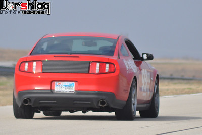

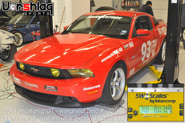

Project Update for Dec 9, 2011: There's an ECR track day this Saturday (ECR Toy Run) and AJ and Ryan have been wrenching this week on both our 2001 BMW 330 and the 2011 Mustang, to take these two cars out for one last blast around the track for the year. The BMW hasn't been on track or autocrossed in over a year, but its been running around with its fresh 2005 motor for a couple of months and and we've finally found all of the clunks and bangs and repaired them (the ball joints in fairly new front control arms had already sh!t the bed! Lesson learned: don't buy cheap, no-name replacement parts).

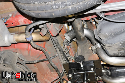

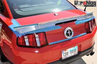

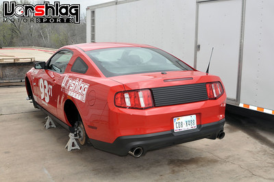

Before we got started on the exhaust, I had AJ swap the race seats back in, then align, corner weigh and corner balance the Mustang. The weights were looking good - this was before the exhaust work lined out below. The weight above (3483) was with the trunk junk still installed; it was 3472 lbs with low fuel (autocross weight) and the junk out, so it is slowly getting lower. Not too terrible for this big pig - the car started out life at 3563 lbs w/o fuel, and we've seen over 3600 lbs stock, with some gas in the tank. The 18x10's and the 275/40/18 tires are a bit heavier than the normal 18x9/265 tires we run, so knock off another 40 pounds out for the "STX" autocross weight. And we're going to get some weight out of the exhaust, today...

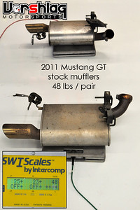

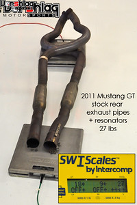

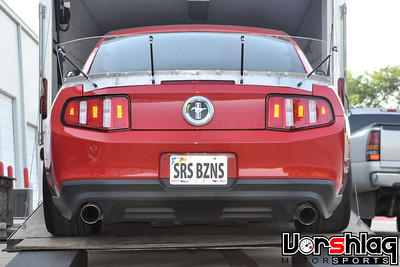

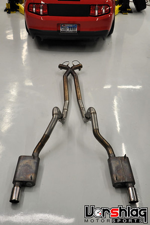

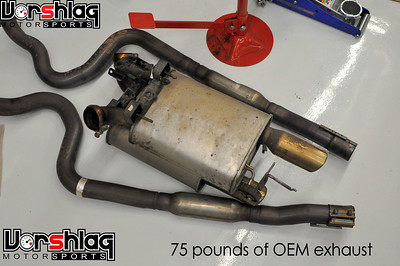

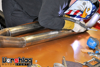

The Mustang is getting a new, 304SS, 3" mandrel bent, "after-X" exhaust here at Vorshlag today. It has been running around with the ARH 1-7/8" primary full length headers, the ARH catted X-pipe, but the stock rear exhaust section from just after the X. The drive-by sound test numbers didn't go up at all with the headers, which meant the stock mufflers were choking the the exhaust noise and flow down considerably. The stock mufflers looked heavy, too, and the over-axle section and resonators are "factory crushed" with crazy crimps and "clearance" bends. Its been bugging me for months, and we finally found time to attack the Mustang after our fabricator finished with McCall's Z3M dual 3" exhaust (which is incredible). Did I mention that Vorshlag is offering custom mandrel bent exhaust fabrication now? :D
I was right about the Mustang's stock mufflers - they are 25 pounds each! The after-X exhaust section with mufflers was 75 pounds just by itself. Factory exhausts are ALWAYS crazy heavy, and restrictive, and too quiet. We'll fix that!
While Ryan was TIG welding up the exhaust AJ was swapping to the dedicated set of track rotors and pads, plus giving the car a brake fluid flush.
This is the final routing, above. It gets within 2 inches of a fuel filler line so we wrapped that part of the exhaust with header wrap, just to be extra safe (there was zero issue with it after 2 drivers tracked it all day). To see how much weight the new dual 3" exhaust shed, we did a quick scale check as it came down - 3442 lbs. So it lost exactly 30 more pounds just in the rear exhaust. Most of that was in the mufflers, but some was in the larger diameter 16 gauge pipes, too.
After we got home that night, before we went out to grab some dinner in the Mustang, I shot a little video (below) of Amy in the Mustang starting it up, idling, and a little blip of the throttle. It sounds pretty subdued at idle and cruising around, but at WOT it is definitely "easier to hear the engine" now. :D
click for video of exhaust test
Next week we'll take the Mustang back to True Street and have it re-dyno tuned, and finally get the damned "street" tune, that takes out our weaker "autocross" throttle mapping. I will do another thread update after the dyno runs, with a report of how the track event went (Mustang was great!), what times it at ECR, etc.

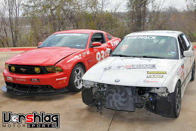

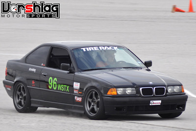

Track Day in Mustang + BMW
As I already posted about in the BMW 330 project thread, the folks who run the 2.5 mile road course at Eagles Canyon Raceway always put on a good "fun" track day every December. Its only $50 + a toy + some canned goods to run, makes for great donations to local families in need, and which brings out all sorts of casual racers that want to run on track for lower costs + a few serious track guys/racers that want to squeeze in a track event at the very end of the year. I guess we fell into the latter group, but barely. :p
Pictures and videos are here.

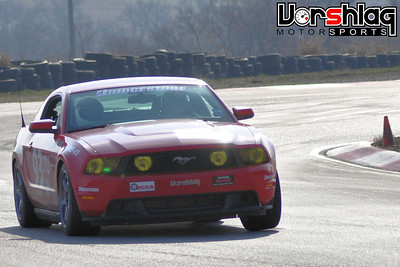

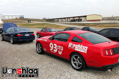

ECR put on another great Toy Run event, with 90+ cars in attendance on a cold 30°F wintery day. The track was mostly dry from previous rains and the weather warmed up into the mid 50s that afternoon, so we had a great time, peeling layers of clothing off as the day warmed up. The plan was to for me to primarily run sessions in the BMW 330 in Red group, logging its first track miles on the "new" 2005 M54 longblock, and its first miles driven in anger in over a year. Brought the transponder charged up, had sticker 285 R6s mounted (which we can just barely squeeze into the build for TTD use), so I planned on putting in a mild first session, coming in and checking everything. Then go out and pound out a lot of laps in it, steadily pushing the car and trying to put in a quick time.
Amy was to drive the Mustang in the same group all day, and just have fun. Towards the end of the day I was going to swap cars with her for the last session (each group had five 20 minute sessions on track scheduled), slap on the transponder, and see what the Mustang would do, too. I've driven literally hundreds of laps at ECR since my first NASA TT event there in 2008 (where I set the TTU record, and fastest TT time in the old E36 LSx Alpha car), so I knew the track and it would give us a good baseline for the Mustang. When we put the very-revised/DDP equipped/updated Moton Club Sport doubles on the Mustang (soon), we'll go back to ECR and re-test the Mustang with the same wheels/tires/power and see where we pick up time.
If you wanted to, the 275mm tires could be vaporized like this all day - in 3rd gear
The best laid plans... first of all they did not have the AMB timing system turned on, and wouldn't. It was a long shot, but I had hoped they would. So no "real" times. Damn it - should have pulled the trigger on that new on-board lap timer/data logger. Oh well, I figured I'd find someone to hand-time both cars for me towards the end of the day, when it warmed up and we'd be quicker anyway. So we both went out in Red, which was the very first session on track at 9 am, and it was frakking COLD. I warmed up the BMW's tires, trying to scrub them in, and put in about 9 trouble-free laps over 20 minutes in it. Never saw Amy in the Mustang - she was on the other side of the track each lap, running about the same times as me. The 330 felt fine, but there was some unusually SLOW traffic in this group (one of which was moved down to Blue group later, some to Yellow), so I just took it easy, shifted the motor early (5500 rpm), and just tried to scrub in the tires and not abuse the brakes. The HP+ pads on the 330 were fairly thin (the replacements we had ordered weeks before arrived the next Wednesday), so it wouldn't stop 100% for more than 1-2 lap bursts.

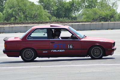

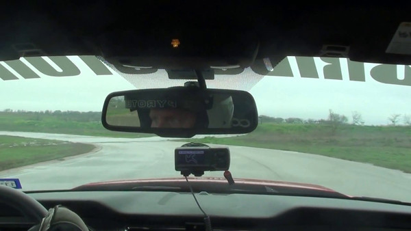

Got in-car video driving the BMW in this first session, but only ran a 2:07, with plenty of mistakes. Meh, not very quick, but that was already 3 seconds quicker than its previous best, which was a NASA TTD record. So it wasn't a totally wasted effort.
Came in the pits and the BMW had developed a tiny leak at the coolant reservoir. Freak thing, where the OEM bracket flexed and let the tank rub a pulley, and didn't start to leak until I was already off track, and just a trickle at that. Long story short - it went onto the trailer. Amy had a blast in the Mustang, said it was working great, so I took the 5.0 out during the next Yellow group and she stayed running in Red, so we doubled up sessions in the same car. Car didn't care... just asked for more fuel, and more abuse!

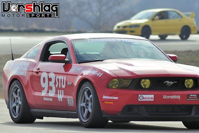

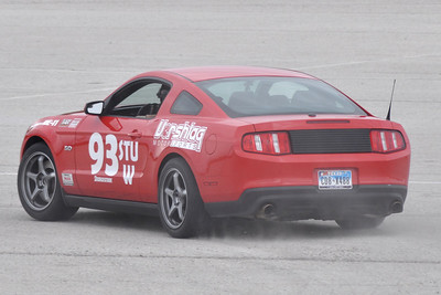

Getting into the Mustang and driving it on track for the first time in 6 months... man, I had missed THAT! And now the car had more power than at any other track sessions before (we had 100% stock dreivetrain/power mods on it before). Every track event I've done since driving the Mustang last were in LeMons cars, the BMW, or something else with a lot less than 430 whp. Driving the Mustang on track with the newly added horsepower (ARH full length headers + ARH X-pipe + cold air + Vorshlag x-back exhaust + tune) and 275mm grip on the 18x10s and new AST 4150 DDP pistons was a BLAST, even if it was on Amy's full street/daily driver set-up.
The new Vorshlag built dual 3" exhaust behind the ARH 1-7/8" full lengths sounded GOOD, and we had several drivers, spectators, and corner workers walk up and tell us that "that thing is the best sounding car on track today!", and it was. Sweet, sweet V8 sounds, but not terribly loud. The sound it made from 5000-7000 rpm... oh, it made my man parts tingle. I opened the hood in grid and a swarm of people came by to gawk at the clean, tidy engine bay. Got a lot of "That thing blew by me like I was STOPPED!" comments from Yellow group drivers.
So Amy and I kept taking it out in Red & Yellow and I led some "Lead-Follow" groups during a few Green groups as well (hazards on, about 60% pace, for to show the proper line to n00bs without freaking them out). All we needed for the car was fuel - but it averaged 11.8 mpg, running some hand timed 2:03 laps. Amy had some low 2:10s, and with a little coaching she'll find every ounce of speed I had. So yea, the Mustang on street tires was 4 seconds a lap faster than the TTD prepped BMW 330 on 285mm Hoosiers. Horsepower. 'Merca!
Current track impressions: This Mustang probably still needs some dedicated brake cooling ducts, as I could get the DTC-60 Hawk pads a little warm if I was pushing the brakes 100% for a couple of laps, but it still STOPS. Might switch to a Porterfield pad someone has put me onto. Some added aero wouldn't hurt, as it has the ample power to convert into some downforce. The car was pretty much just flawless on track, and too damned much fun. No temperature issues at all, even with 2 drivers driving it back to back to back. I could hoon it in 3rd gear in slow corners, or drive it nicer and put down some decent laps. Played with a certain hot TT driver's E92 M3 on similar tires and the Mustang came out ahead. I had it all on video, but all of the in-car from the Mustang was borked when we looked at it the next day. Gah! It was so good, with a passenger hooting and laughing the whole time.
So, I think any more power in the Mustang and it would be begging for Hoosiers... Hell, its already begging for Hoosiers. I gotta quit tracking this still too-new car. Its just so much more fun to drive than my "dedicated track car" BMW with M54 power!

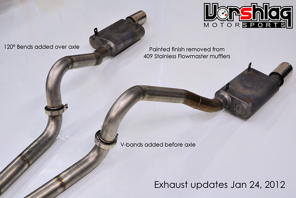

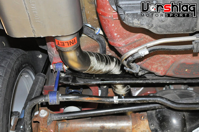

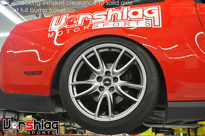

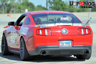

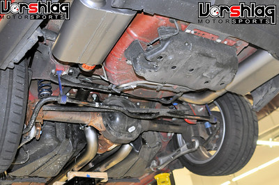

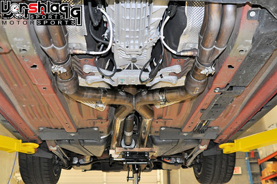

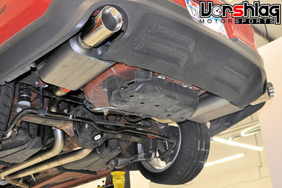

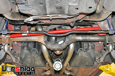

Exhaust V 2.0
First, the custom dual 3" exhaust we built here at Vorshlag has been heavily revised. The various 3" mandrel 304SS bends we had on hand the first time did not include a 120° bend, which is very helpful when making the over-the-solid-axle routing. Now that we stock a LOT more bends we were able to route it better and have lots more clearance at full bump travel. We confirmed the routing with the springs removed and the axle at full bump travel, then added even more room. The 3" tubes are routed over and through the panhard bar and structure with space to everything surrounding them.
It is crowded under there, but Ryan made it fit great and look beautiful with ample clearance everywhere. There's so much more room to the fuel line than before that this version didn't need header wrap insulation there. You can see how the left and right tubes are asymmetric - that's due to the panhard mounting and the fuel line differences side-to-side.
The two pre-axle "slip-fit joint" clamps were removed and a pair of flanged V-band clamp joints were welded in their place. This ensures a leak-free connection at this location. Much quieter now after driving the car - we will never use a slip-fit exhaust joint in this shop again. It was a test, after other shops had said they have used them successfully, but we're not going to do it again. V-bands or nothing.

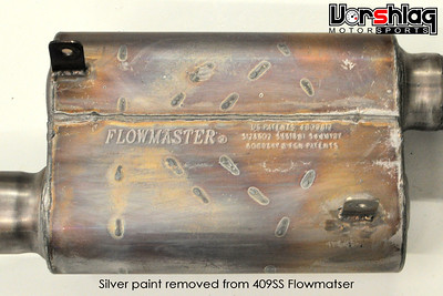

The 409 stainless steel (it is magnetic so it has to be a 400 series) Flowmaster Series 44 mufflers came new with a silver painted finish (see above left pic) - it looks like the same coating they put on their carbon steel mufflers. Well of course this burns off and makes a stinky mess. While the exhaust was off for this re-work we used some Scoth-Brite pads and paint thinner to get the rest of this silver gunk off, which left the mufflers in their natural "bronze" finish (after several weeks of use). Don't know why they bother painting them - next time we use these FM mufflers we'll remove the finish completely before putting them on a car.

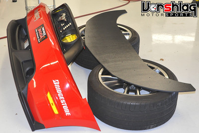

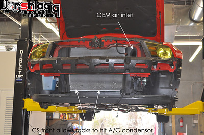

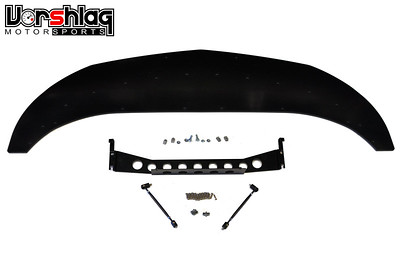

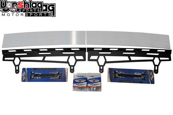

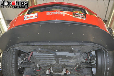

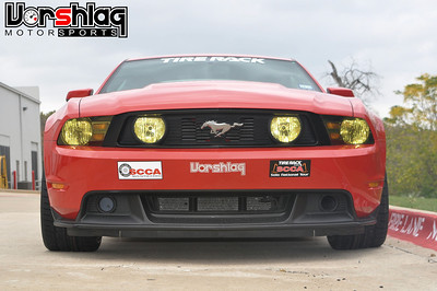

Boss302 Leguna Seca Splitter

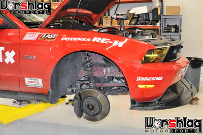

So we've been looking at this OEM piece for some time and figured, what the hell? Let's try putting one on our Mustang and do some track testing to verify if it is working (adding downforce/lowering times). We'll use the aero test procedure detailed in Neil Roberts' ThinkFAST book, of course. These LS units sell for $700-750 and "bolt on" with the CS lower valance we added (that became optional mid-2011 model year).
Well it took some time to install it - figure 2 to 3 hours to be safe. The whole front bumper cover has to come off, more than once. The LS splitter is indeed made to fit this CS lower valance, and it shows, but the install was tedious with so many bolts/clips and the test fitting to line up the support strut "through holes". Once finished and put together for the first time, it can then go on and off in 2-3 minutes (which we might do to ease trailer loading/unloading and prevent an "oops!" on the street). We were missing 14 pieces from the hardware kit, so figure in a trip to a specialty hardware store if you get this thing. The counter-sunk mounting hardware is all M6-1.0, so are the 22 qty nut-clips they mate to; our kit was 14 clips short but Ford is supposed to be sending an extra hardware kit "soon". Zero instructions, so AJ looked online for some tips (not much help) then figured the rest out on his own. We might make an instruction guide for this in the future.
Of course we weighed everything before it went onto the car. Looks like the ABS plastic splitter itself (which is thick!) is 12.2 pounds, sticks out past the bumper 5" exactly (American Iron class limit), and the hardware and bolt-on strut mount for the splitter weighs another 5.5 pounds. So will this thing produce enough downforce to offset the $700 cost and 17.7 pounds of added junk? I don't know - what do you think? The AI class 2010+ Mustang racers seem to use this thing, as do the pro racers in the S197.
Shazam! That thing is big. But no, I wouldn't stand on it...
We've street tested it today and it works fine there. Only one light scrape on a very steep parking lot entrance incline that Amy had trouble with before the splitter, so we'll be extra careful there. If she scrapes it up too much in street driving we'll pull it off and only use it for track events, and install it at the track. Its not too low for street use even at our lowered ride height, really, if you drive carefully and have half a brain. Again with an electric impact it only takes 2-3 minutes to swap it on/off now that all of the brackets and nut-clips are installed.

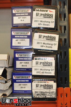

Brake Pads + Cooling
After the track event last month at ECR, AJ swapped the rotors and pads from the Hawk DTC-70s back to the HP+ pads and the street rotors. The DTCs were melted to slag and are in the trash bin. The HP+ pads don't look much better. Me thinks these Hawk pads are full of filler - it would explain their low price point, and their low threshold of abuse.
I was only getting 2-3 hot laps on the DTC-70s at ECR before I noticed significant brake fade and had to take a cool down lap. We're going to switch to a higher cost set of race pads before the next track event. PFC 01, Ferodo R4S, something. We're also going to make a brake cooling kit for the car. After reading about the issues with installation on the Ford kit, plus the added hassles of making something that is STX legal (cannot cut the fender liners for cooling hose), we're going to take a stab at it here. According to many, cooling air to the rotors via the two 3" ducts on the CS lower valance helps tremendously when used on track.

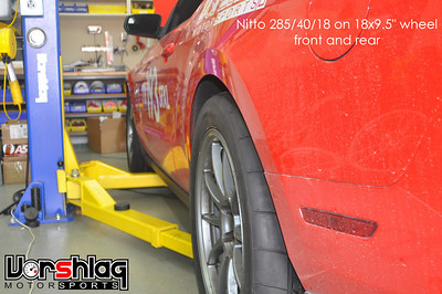

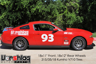

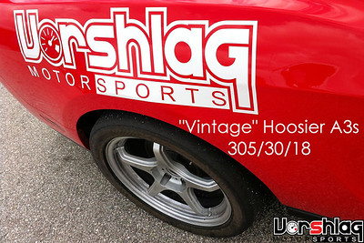

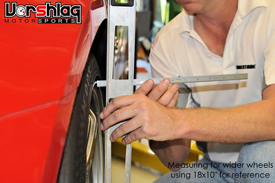

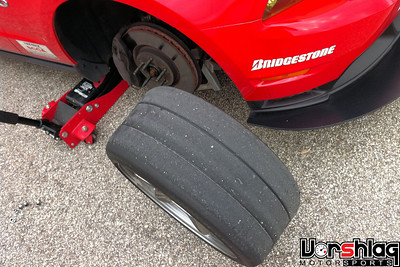

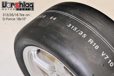

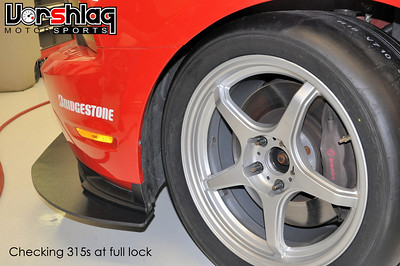

315/35/18 Tires on 18x10 D-Force
If we're running in TTS we could use wider tires, right? We also had several S197 Mustang autocrossers ask if we knew if 315mm tires would fit the car on our new D-Force 18x10" wheels. I had my doubts about using a tire that wide on "only" a 10" wide wheel, but I gave it a try. Ordered a set of 315/35/18 Kumho V710 R compounds to see...
This set actually came free from Kumho - our spoils from winning the $2011 GRM Challenge (and our E30 V8 is on the cover of the next GRM mag!). So yesterday I took one of the 18x10s and mounted one of the 315mm Kumhos, which is shown above. It looks a bit squeezed on the wheel, to say the least. For me, I'd want an 11" wide wheel for a tire that big, or maybe an 11.5". But for some autocrossers, this is fine (look at some of the crazy squeezed stuff Stock class guys do). Today we stuck them on the Mustang, starting with the front and using a 5/16" spacer we had...

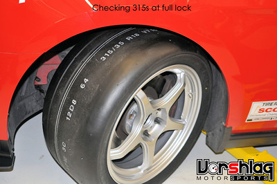

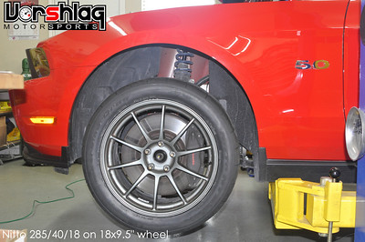

Monster room up front, both inboard and out, with this 5/16" spacer. It would work with as little as a 1/8" spacer, but to be safe I'm going to recommend a 1/4" spacer when using this massive 315mm tire up front with these wheels. If you stick with a more sensible 275 or 285mm tire it still needs no spacer on these wheels, front or rear.
Checked them at full lock, room for days. Now this is with -3° of camber up front, but that's not much in my book. That's what we use for the street on this car. Now on the rear it wasn't as ideal, but still "good enough for auto-x" in most people's eyes. So I would say "these tires fit" but I won't be running these 315s on a 10" wheel. Stick with 285s or smaller, as those tires fit the 10" wheel width properly - no squeeze.
I'm now pulling the 315mm test tire off the 18x10s and re-mounting the 275/40/18s. Damn, we need a tire machine here at Vorshlag. It would pay for itself in one racing season. On the prowl for a deal. So now I've got these massive tires with no wheels to use them on. So... once we get the panhard and upper control arm on later this week we'll measure for 18x11 front and 18x11.5" rear 3-piece wheels. Forgeline, CCW, something. These should fit with fairly different offsets front and back. Can't let these tires go to waste, and it sure would make for some monster TTS grip.

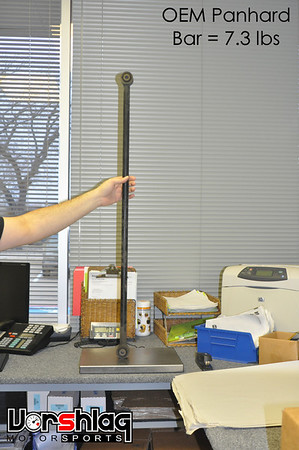

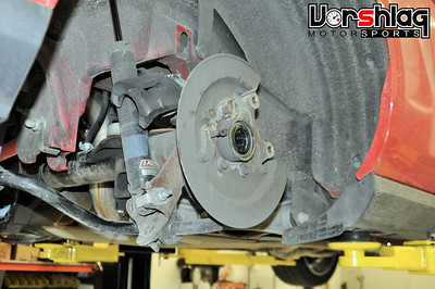

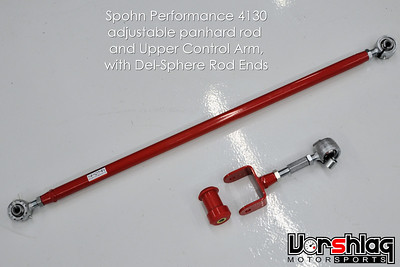

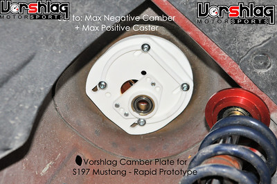

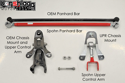

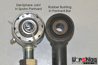

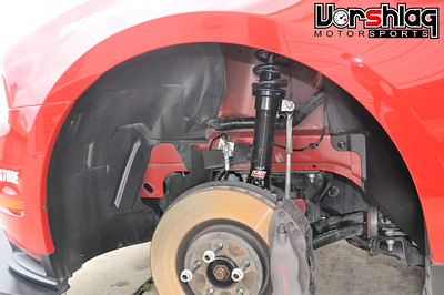

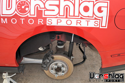

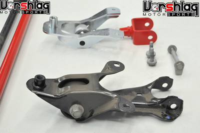

Rear Suspension Fixes - Quick and Dirty
Our first autocrosses for the Mustang are in early March, with a track event in mid-February, so we've got some new rear suspension bits to install and test before then. I feel that much our our low speed traction problems in this car center around the compromised rear suspension geometry. When you lower the car with this 3-link rear suspension the pinion angle on the axle gets out of whack.
Solid axle RWD cars have so many limitations when compared to an IRS set-up that the SCCA Street Touring rules give the stick-axle vehicles all sorts of leeway, and we're going to finally attack these issues. We did a lot of looking, thought about making our own stuff, then looked at the calendar and bought the Spohn Performance's upper control arm and panhard bar as a stop-gap solution. Their adjustable length upper control arm allows us to adjust the pinion angle properly at the lowered ride height. The adjustable panhard bar lets us center the axle relative to the car, when lowered. Each piece features their optional "Del-Sphere" joints , which allow for high angular movement without bind or noise, at least on paper. These are basically giant spherical joints made inside forged steel ends with Delrin material surrounding the steel ball joint. They are rebuildable - we bought the tool to do that. Seems like a neat little joint that could give you the best of a rod end but without the metal-to-metal street nightmares. Once these new arms are installed we will set the pinion angle for our lower ride height and do some before and after acceleration data logging. I'm hoping for some help in 1st and 2nd gear for STX use - keep hope alive!

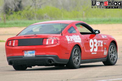

Feb 7th, 2012...
Nice upgrades to the exhaust.. i swear i can hear my slip on axle backs leaking.. but its too late now!
Have you considered adding hood vents for front end grip also? The new functional hood vents for 2013 reduced lift in front significantly from what the engineers have told me. No more hood trying to bow up in the center and rip off over 150 MPH. I'm looking for a simple way to cut the hood and add in the 2013 vents.. watch the Boss 302R in car footage from the 2012 Rolex race, that hood is bowing up when Ian James hits about 150MPh
Yea, we've got some rules restrictions that are holding me back from opening up the hood and reverse ducting the radiator. SCCA STX doesn't allow me to do any aero I want - but we can use "any" OEM front aero, so anything that came on a 2005-up S197 Mustang or that is in the Ford "Appearance" catalog (not Ford Motorsport catalog, after a rules clarification). This means OEM parts like the CS lower fascia and the Leguna Seca splitter are legal. I could switch to the 2013 GT500 front bumper cover, but I'm not sure about the hood. Is a hood considered aero by the SCCA? It is something I need to ask about. The SEB is like a bunch of Republican congressmen - all they know how to say is "No!". :D

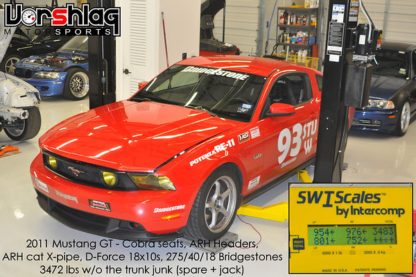

I don't know if you guys are interested or not, but I weighed my 2012 base GT with manual trans and no options other than front plate bracket. With everything in the car as it comes from Ford and a full tank of fuel it showed 3608 lbs on the scales.
Just taking the spare tire and associated junk out along with the floor mats and dropping 10 gallons of fuel would get it down to about 3500 lbs. I know the Brembo brakes add a bit, but I'm guessing the premium model adds some weight relative to the base model too.
Wait... spare tire? Hmm, my car doesn't have s spare. Does your car come with the Brembos and 19" wheels, or 13" brakes and 18" wheels? I suspect the 18" wheel/non-Brembo package is a good deal lighter. I measured the "trunk junk" weight and fuel its not actually 100 pounds of fuel and trunk junk, on my car.
Gasoline is a little over 6 pounds per gallon, so that's about 60 pounds if you drop 10 gallons. Add in the trunk junk and you've lost about 73 pounds, so around 3535 or so.... but yea, its getting down there. :) If you do have a spare tire that will weigh more, of course.
This was the weight of a loaner '11 Brembo GT back in June 2010 - 3605 lbs with 1/2 tank of fuel
After weighing this Brembo / 19x9" equipped loaner we borrowed from a Ford dealer we custom ordered our 2011 GT with all sorts of options I didn't want (my wife - oiy!) and it came in even heavier. We ran it out of fuel, removed the "trunk junk", then weighed it at 3563 lbs baseline. I always try to weigh them with nearly no fuel, or show the fuel gauge to account for fuel weight.
This is the weight on our '11 Brembo GT with no fuel - 3563 lbs sans 12.7 lbs of "trunk junk"
Sounds like your '12 is a little lighter than our car - probably different options and such, or the brakes. We've been on a quest to lose weight from this S197, and here's where we have it now with 18x10" wheels and 275/40/18 tires:
Not much left we can remove or lighten and remain SCCA STX legal. Again, we're building this around two very different class rules, SCCA STX and NASA TTS, but using the SCCA ruleset when one set limits the other. Most of the cars we are racing against in STX are 2800-3000 pounds, but have the same tire width limits we do, which puts the Mustang at a disadvantage - but I knew that going in. If I could just find a "265" tire that was magically 11" wide... well, I came close. I've got one that is 10-3/4" wide. I'm not telling which brand it is though. :D

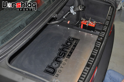

4) I'm sure you've considered a dry-cell battery (Odyssey PC680 weighs 15 lbs vs. 30 lbs OEM).
Already installed. Gallery: http://vorshlag.smugmug.com/Projects/S197-Mustang-race-battery/

Can you tell me more about the mounting plate and bracket you used for the Odyssey battery? Is this a production piece? Any issues with cranking amps? I've been pleased with Odyssey batteries in the past.
Zero issues in the past year of street driving, autocrossing and tracking the Mustang. Amy drives it to work every single day.
If you go back in this thread to post #92, I describe who's battery mount we used, and the other bracket and bits we fabricated to make it bolt into the Mustang without having to drill any holes.
I have PC680 Odysseys in 3 of my personal cars. Only car I have any issues with is one of my BMWs, which has a known battery draw when parked - and draws down the battery after about 5 days of non-use (no matter the battery). We keep it on a Battery Tender and its fine. One of these days we'll chase down the voltage leak...

Ok guys, I'm looking to buy some new wheels and tires and I keep going back and forth. Now I'm considering the D-force wheels too. You're saying they will work front and rear without spacers, but is that with a normal strut/spring setup? What's the biggest tire you guys have tried with them (diameter)?
The reason I ask is because I'm looking for just street tires right now and I'd rather not run smaller diameter tires...trying to keep fender gap to a minimum and I'm not lowering much. I think a 285/40-18 would be ideal, but there's a good deal on some 275/45-18's right now (with a 10.1" tread width). Those are some pretty big tires, actually a bit larger in diameter than the factory rubber...maybe too big, but I did find someone that's actually running them on a 18x9.5 et40 wheel.
We tried a 285/40/18 tire and it looks ridiculous...
These pictures don't show how silly this giant, tall tire looked up front. We all turned our noses up.
I get that you don't want a lot of wheel gap, and these cars apparently do respond well to running taller tires... but within reason. The stock stuff is 27" tall, which is enormous. There are no 18" tires that match the 27" tire height of the stock 255/40/19 tires. After much testing, calculations, and trial fitting we went with the 275/40/18 tire on the 18x10" wheels - that's the best fit for the car and the wheels. They look the best out of the many sizes we have tried, fit the wheel nicely, fit the car nicely, and were 26.4" tall. The closest we could get, without going over the stock 27" tire height.
On my car, I installed some Steeda sport springs and different shocks/struts, now I'm already wishing I had AST's! I got that stuff cheap just as a temporary measure, so depending on what happens I might end up getting some AST's for this car at some point.
Yea, you are int he same position a lot of folks find themselves... they install lowering springs with stock length struts and shocks, and the ride suffers greatly. This isn't because the springs are too stiff (they aren't), or the shocks aren't damping (they might be), its because you've lowered the car but have the tall stock length struts and shocks - and they are simply running out of "bump travel".
I've been there and done that. ;)
This is partly why the ASTs ride so much better than most set-ups like yours at these lower ride heights - AST shocks are shortened appropriately and thus have the proper amount of bump travel at a lower ride height. Then there's the fact that they are adjustable monotube struts with killer pistons and customized valving... so even with more spring rate and a lower ride height they usually ride as good as or better than stock.
As for wheels, I was gonna go really cheap but I'm leaning towards picking up the D-force set from you guys now. My car is black...wish you had the D-force in gunmetal color! Might just go with flat black for now and see how it looks.
Yea, the temptation to use some of the cheap replica wheels avilable for this car is huge... just know that they are horrendously heavy - which impacts ride, handling, braking and acceleration - and many are made for the SN95 chassis, and just simply don't fit these cars. If you need something quick just find some OEM take-off GT500 wheels (18x9.5" or 19x9.5"), but if you can hold out another month or two our 18x10s should be here and they are light, they fit right, and are a full 10" wide. :)

Project Update for Feb 17, 2012: We've been buried in work in the shop, but we took a couple of days off from customer work to attack the Mustang (while doing an M52 longblock swap on an STX prepped E36 328is, shown below). We are cutting it a little close (I leave for the track event down in San Marcos in about 4 hours) but the last few bits are going in the car now (seats and new 6-point harness mounts) and it should all be wrapped up by AJ and Ryan in time to load at 1 pm...
Rear Suspension Updates

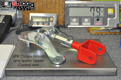

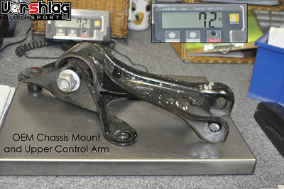

We've installed the Spohn upper control arm and Panhard bar, both of which are equipped with their Del-Sphere joints (Delrin encased spherical). And yes, this is all legal in SCCA Street Touring - thanks to copious allowances for solid axle RWD cars - since none of these have proven remotely competitive in any ST class. Basically STX and STU have the same torque arm/upper control arm allowances as ESP.
So all of this has been installed, and yes, the non-adjustable OEM upper control arm made for a wacky 0° pinion angle at the lowered ride height. Basically FUBAR for a solid axle car. You want pinion to be at 0° under acceleration loads, so you try to shoot for -2 to -3° at the pinion at rest and at ride height (according to Spohn and many others). At the lowered ride height the fixed length OEM panhard bar resulted in axle offset, which we also corrected with the adjustable Spohn piece.
Can't say enough nice words about the Spohn UCA and Panhard hardware - its top notch. These Del-Sphere joints are super slick - they rotate and pivot with almost no resistance - so no binding - but are still wrapped in Delrin for less crashing than an all-metal spherical. Plus they have grease zerks and are fully rebuildable. I'll see how it rides with these in the UCA and Panhard shortly.
Weight differences between the OEM UCA and Panhard vs the Spohn hardware looks like a wash. We also used a new bolt-in UPR Products upper chassis mount - made of plate steel vs the stamped steel of the OEM bits. Yes, its STX legal - we can go hog wild on the upper control arms. I am now more worried about the factory lower control arms - they are far from parallel at ride height, and this plays hell with the Instant Center. We're going to measure that and come up with a solution to test soon (likely offset bushings).

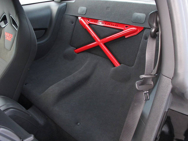

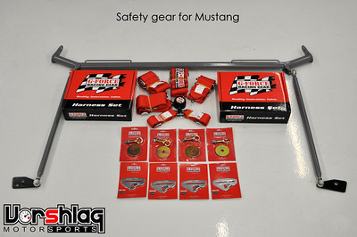

Safety Gear Upgrade

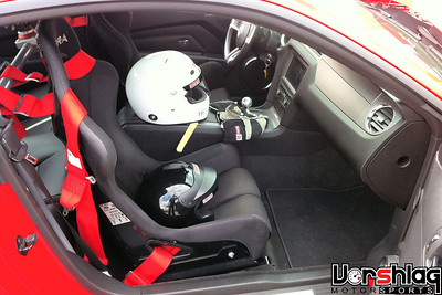

I have been skimping a bit on safety for the various track events we've attended. For autocrosses in 2011 we have been using the fixed back race seats with 3" harness lap belts only - not a big deal when driving around a parking lot. We did most of the 2011 track stuff with OEM seats and seat belts (which is safe), but I admit to doing one track day in December with the race seats and lap belts. I did double-up with the OEM 3-point seat belt, but that's still pretty hinky. So for this weekend's track event I wanted something a little better...
That is a Corbeau harness bar I picked up from Stuart at AST/Moton. Nicely built piece, pretty hefty tubing used, and better than mounting harnesses on the lower rear seat belt locations. No, I'm still not running a 4-point roll bar, and likely won't ever do that to this car... don't want to mess-up the rear seats to make that fit. I'm sure some of you will reply with the "you are going to spontaneously combust!" safety concerns, and yes... I hear ya.
Again, this is not the perfect safety solution... so "don't try this at home". :) But this is NOT a race car, its a daily driven street car that I don't want to cut up for a roll cage. If the only other alternative is OEM seats and belts, then I'm going to stick with my FIA approed seats and 6-point SFI approved harnesses hung from this 1.5" dia piece of DOM, and mounted to the floor with proper G-Force clip-in floor anchors.

I put a picture up above showing the various brake pads we've got for the Mustang. Going away from the Hawk options (HP+ for autox and DTC-60 for track) and moving to Porterfield (R4 for track and R4S for autocross). The R4s are on the car now for the first time so I will report back with my impressions from Harris Hill Road's tricky little road course.

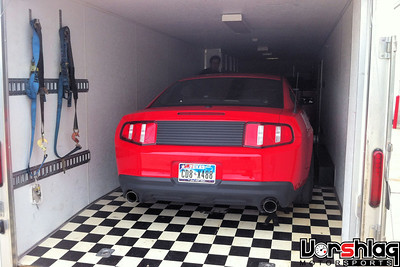

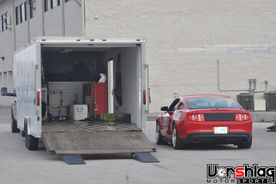

The crap started with loading the trailer. I sold my 38' enclosed trailer in January (and just bought another one late today) so I borrowed a buddy's open trailer for the weekend. I was trying to leave Dallas by 1 or 2 pm, in a failed attempt to avoid Friday's "leaving town" traffic. I was also worried about the splitter making it harder to load, but with my nearly 12 feet worth of ramps (Race Ramps + the trailer ramps), it just cleared. Right as we started loading the car the weather went from sunny/nice to raining...
And the rain didn't let up for almost 48 hours. My wife, who normally co-drives our race cars and always goes to races with me, was going to come along as track side support and to help with driving to and from the event. Since we were only taking one car, and since I'm done trying to "double up" on track events in one car, she was just along to help. Too much abuse, and too hectic, to run 2 people in one car. Friday morning she was starting to get sick, and I knew from experience it wasn't going to get better anytime soon. I called McCall, he dropped everything and agreed to run down to San Marcos with me for the next 2 days to help. When I told my wife she was off the hook, she insisted she was going to go along to help, even when I begged her to stay, so we left about 3:30 pm and McCall was off the hook instead (this proved to be a huge mistake). She had set-up a blanket and pillow in the back seat of the MegaCab and proceeded to make a cocoon and slept back there the entire way. 6 hours of driving through crap traffic and steady rain the entire way... with her coughing and hacking from the back seat (later we found out she had full blown bronchitis). Oh joy.
So the drive down from Dallas to Austin/San Marcos was a nightmare, from weather and health reasons, but the truck and trailer worked fine (other than two hub caps coming off of the trailer along the way, which is $90 I need to replace now). The hotel she had reserved was very nice, full of high school cheerleaders (no joke), and we got there early enough to go out and get a real meal, but with a sick wife I stayed in and ordered room service food. She was up all night, throwing up and coughing. I almost convinced her to blow off the event and head home, since she was a mess, but she convinced me to stay. It rained HARD all night - rain pounded on the hotel window and kept waking me up, too. This all night downpour was not a good sign...

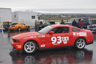

American Street Car Series "Run To The Alamo", aka Pain in the Rain
The ASCS guys said the track portion was to start at 7:30 am sharp, so "be there with cars ready for tech on time". We got up early and drove to the track by 7:40, just a tick late thanks to terrible directions by my sick navigator (heh!) and a "deep water crossing" we had go across at a bridge near the track (bad sign #2). We got to HHR and it was utter mayhem there, trucks and cars parked willy nilly, trying to unload cars in their postage stamp-sized upper parking lot. We finally figured out where to park (lower lot) and unload the car. It was raining pretty hard and it never much let up all day. Unloading a car from an open trailer in the rain SUCKS.
The main guy running the event showed up around 8:45 (oiy!), registration finally got started about 9:30, then we sat around watching the Daytona GRAND AM race in the clubhouse and kept seeing the rain come pouring down. Track owner said it had rained for going on 3 days in a row, and even though they were "in a drought" the area around the track was super saturated and "it will be draining across the track all day, even if it stops raining" (he was right). All the surrounding land drained into and across the property that the HHR track is placed on, and it was soaked.
Around 10 am they finally started had a driver's meeting ... that became a sponsor thank-fest that lasted a good 1/2 hour. By 10:45 am we had our RFID transponders installed (more on that) and a few of us finally lined up to get out on track. They wanted to do "some lead follow" laps to "sort out the drivers into groups" (never happened), and these laps lasted for almost 45 minutes, 2 laps at a time. Two drivers spin off track and proceeded to get good and stuck in the mud, during lead-follow laps. So yea, it was one of those kind of track days. I think by day's end we had 7 or 8 cars go off into the mud, needing a tow.
Watch this "highlight video" and you can see how much the weather and track conditions sucked...
in-car video showing "the opposite of track enjoyment"
There was a serious water crossing on the track, where you had to slow WAY down, and it made for 20' rooster tails whenever you crossed it. There were another 7-8 "rivers" crossing the track all day. This track has MAJOR drainage issues - not the fault of ASCS but it sucked all the same.

On a positive note, I did finally get to see better in-car video from my 1080P vidcam, mounted properly on the harness bar, and not stuck right to the windshield with the old suction cup mount. Bad news is the rear view mirror and my ugly mug are now shown. I need to play with placement and maybe tweak the rear view mirror location, but it works better than before. I also managed to finally get my G-Tech Pro RR Fanatic data logger + lap timer to work properly in Road Race mode.
I fought with this damn G-Tech thing for a couple of events last year but never got it out of the "SS" (drag race) mode. This time, after but sitting in the pits in the rain waiting to get out on track, I messed with it long enough to figure out that the "scroll wheel" is also a push button for "select", and that did it. I also figured out how to make it work for continuous lap timing, predictive lap timing, how to add segments, and even how to make a separate start and finish (for hill climb and autocross). So now this $299 data logger display finally paid off - because now it works as advertised! I need to make a "how to video" for this thing because the instructions it comes and that they have online with are terrible. It has software I can download to data mine the laps and maybe... maybe place these onto the video??? We'll see.
What else... oh yea, I guess I tested the new Porterfield R4 brake pads, which worked fine on track but it was raining all day. They are still on the car now, and after a week of street driving there's very little brake dust, they don't make too much noise, and they work fine cold, so it might work for autocrossing, too (I bought R4S pads for that, though). With the DTC-60 Hawks, the wheels would be BLACK after a DAY of street driving, they sucked cold, and after a week the noise would make you want to drive the car into a tree. I couldn't tell jack squat about any "new rear grip", other than I had none. The new 6 point harnesses worked out nicely, and the harness bar was rock solid. Nobody wanted to ride in the Mustang - guess it wasn't cool enough? There was some pretty crazy hardware there, the weather sucked, and a lot of cars went off into the mud - not too shocking.

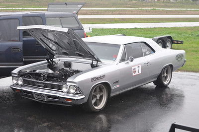

Pictures I have posted from the event will show you some seriously nice muscle car hardware, and many of you will recognize a these cars from the pages of Popular Hot Rodding and the Pro-Touring scene. Neat cars, a LOT of money invested in many of the, and I was impressed with how many of the owners weren't afraid of throwing them off the track and into the mud. I can think of only one car there that wasn't driven on the wet as hell track. There was no real damage done, luckily, but it could have been ugly if a car had spun off sideways and gone shiny side down. Oh yea, the "Detroit Speed Inc" 53' 18 wheeler transporter was chock full of kickass cars, any of which I would be proud to own. They are doing something right - that transporter was nicer than some NASCAR team's units (and may have been an ex-NASCAR Cup teams' setup). The DSI owner was a super nice guy, and worked his butt off to help me get my timing issues sorted - big thanks to Brian for that. He's apparently an owner of the new ASCS series, so maybe he can help guide them into a more organized competition series.

Tex Reg SCCA Autocross #1 - First Autocross of 2012
On Sunday the 11th Amy and I took the trailer on a short tow across town with the Mustang loaded inside. This was a test of the trailer before our longer tow the following week (happening in about 2 hours), as we could have driven to the site only 45 miles away. Still, I'm trying to keep the STX autocross tires off the street and reduce heat cycles, so it will likely be towed to all autocross events this year. I'm glad we had it - as it rained all morning, and the trailer became a good dry spot to sit inside of.
Made a few small mistakes this day, such as not scrubbing the tires in before the first run (silicon mold release + wet surface = slippery first few runs!), I didn't load the "autocross" throttle map tune via the SCT (so it had the bezerko street tune map - not what we needed in the wet), we left the Porterfield R4 "track" pads on (ran out of time), and we had the loose shoulder harness belts clanking around on the back of the seats (I only use a lap belt for autocrossing - lets me move my upper body around and I can see better out the side windows, which happens when you're going sideways a lot).
Anyway, we started with fairly low rebound settings on the AST 4150s and lower tire pressures, to soften the reactions as much as we could for the wet conditions. Amy and I worked the 1st of 2 heats, where it rained off and on until about 11:30, when it finally stopped. The skies were overcast and the wind was nil, so it didn't dry off much at all during our runs in heat 2, as you can see here on our first runs...
Left: Amy's 1st run Right: Terry's 1st run

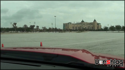

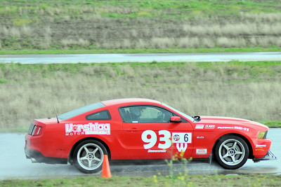

As you can see it is not raining but it is still pretty damned wet. We both ran in STX open class, as I don't have another co-driver this year so we'll both run "open" until Nationals, where she will likely move to STX-L. Since we had a 2 driver car, had to adjust the seat and belts significantly, swap numbers, check tire pressures, and reset the video between runs, and the smaller heats made for quick driver changes, we ran 1 run each, then did runs in 2s... so Amy, then me, then Amy, Amy, me, me, Amy Amy, me, me. Even with faster changeovers we were running behind and I was one of the last cars to make my a run - and in fact I put myself on a 5 minute timer from my 4th to 5th run. It turns out that Amy stopped for a downed cone on her 2nd run, which they threw out, but she didn't know they gave her the re-run so she didn't take her 5th run. That sucks because she would have likely dropped more time.
The sun had just peeked out and it was a tick drier, but if you watch my 5th run you will see that the actual driving line was still wet, due to the cars dragging water from some drainage onto the line. It was the only lap where I tip-toed the throttle and braked early, so I wasn't too surprised that it was 1/2 second quicker than my previous best. It "felt slow", which usually means its fast... you know?
Left: Terry's 5th and quickest run (37.5). Right: Amy's 3rd and quickest run (38.2)

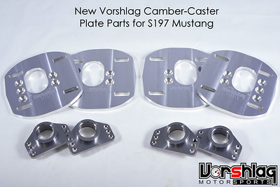

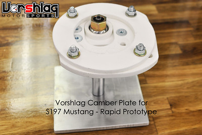

New S197 Mustang Camber Plates + New Aero?

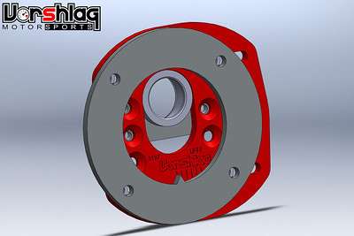

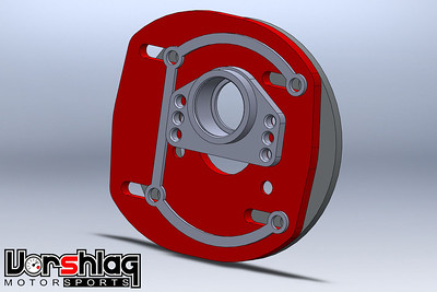

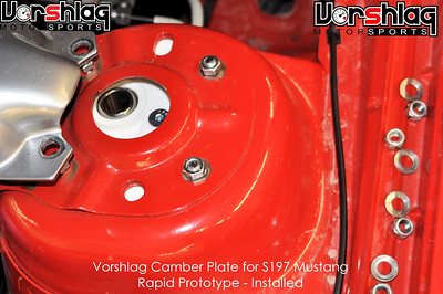

So I had an ad out there for a new draftsman (ended up hiring 2 folks), as I was needing some drafting help to help catch up on some camber plate revisions, new designs and other product development. Since I spend too much time on forums I can't get all of my design work done. ;) Got 40+ resumes but found the perfect guy to help out for the short term. He is a great SolidWorks guru and racer; he and I worked several late nights last week and got the drawings done for an all-new Mustang camber-caster plate.
This one is easier to adjust camber (loosen the 4 strut top nuts and slide the assembly in-out) than before, it has 3 caster settings (like our BMW E36 design), has a pointer and hash marks for camber setting reference, and is now using an aluminum main plate and an all-new bearing holder design. A lot of work but he did an excellent job.
I took those 3D files, output them in the proper format, uploaded them to a website that makes stereo lithography parts, and 36 hours later these Rapid Prototype nylon parts arrived. Woo! We tapped the holes, pressed in a spherical bearing, installed a snap ring, and assembled the new camber plate.
We just test fit this into the 2011's LF strut tower today and it adjusts perfectly, with more camber change than before and a lot more caster adjustment than the previous two revisions. So now we will have a production batch made and skip the normal machined prototypes we normally make. Should see these in 3-4 weeks. Woo! Right about when the AST 4150s arrive for this S197 Mustang chassis (and many other 4150 models).
FYI: The 25 sets of 18x10" D-Force/Vorshlag wheels for the Mustang and Subaru chassis are on the water. They should be here in 3-5 weeks. We've pre-sold over 20 sets of the 25 coming in, so if you are on the fence... ?

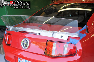

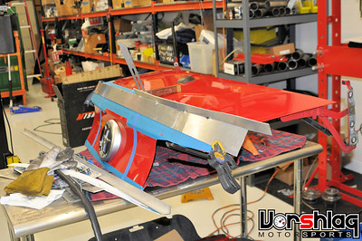

The aero part mentioned above... I am running out of time so I will make a post about that soon. Working with a composites expert, we now have a composite splitter to fit the 2010-2012 Mustang. Looks similar to the Leguna Seca Boss 302 part that we bought for our car, but instead of the 12 pounds of flimsy ABS plastic for the element, this one is 3 pounds of high density foam core wrapped in glass weave and structural resin. Much more rigid than the LS plastic piece, too. We still have some work to do before this goes to market, but we think it will have a significantly lower cost (with the mounting kit) when compared to the $750 price for the Leguna Seca splitter. I will show pictures and talk more about this in a future post. I am running TX2K with the Leguna Seca piece so hopefully it will have a bit more front bite on this (hopefully dry) track than before.

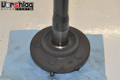

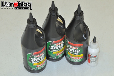

So before we head off to MSR-Houston for the TK2K event tomorrow I mentioned some noise form the Mustang's rear end. Howling on the right side, so Ryan popped the rear cover, pulled the C-clips, and took a look at the axles.
Everything looks fine - the outer bearings, the axle shafts, the ring and pinion, no metal or shavings int he fluid - weird. The fluid smelled a bit burnt so we'll see if the fresh fluid helps any. Maybe it is the inner bearings in the diff carrier - I'll order the Wacetrac LSD I wanted to try out and new bearings and we will get that installed soon.
Before we loaded up the car it was pushed outside, put up on jack stands, and the fender wells and underside got a much needed washing. It was nasty under there. We mounted up some 275/35/18 Hoosiers A6s to the 18x10s for TX2K, so maybe it will have some grip.

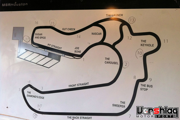

We are running MSR-H's 2.4 mile course clockwise for TX2K12 tomorrow, supposedly

So let's back up a tick. Where we last left off here the Mustang was being hurriedly prepped, washed, and loaded into the trailer. There was some wheel bearing noise I noticed at the Harris Hill Road track event (RTTA) and it was louder at the last autocross earlier this month. Ryan and AJ pulled the rear axle apart, yanked out the right side axle shaft, and we inspected the bearings, shaft, and differential for wear. It all looked perfect. Was I hearing the noise correctly?? I know it was from the right rear... or was it? Weird.

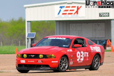

We had found some 275/35/18 Hoosier A6 (autocross compound) DOT tires to mount to the D-Force 18x10" wheels, which were to be used at the MSR-Houston track event held by TX2K12 last Thursday. Our newly repaired tire machine was finally ready to use for the first time... but one more little issue cropped up (fixed this week!) so we took them to Discount Tire once again. I hadn't run the Mustang on track with anything but street tires up until now so some R compounds were long overdue. I could have thrown the 315/35/18 Kumho V710s on there but... I just had a bad feeling about the event and didn't want to burn up brand new tires at this one. That was a smart move.
The 275/35/18 is super short and looks ridiculous (to me) on the Mustang, but hey, its the spec tire for the GRAND AM Mustangs so I went ahead and tried it. Meh, it works I guess, but has a ton of wheel gap at the fender. A little skinny for an 18x10" but it had some grip. We got the car loaded up, strapped in, and AJ and Ryan loaded out the trailer with the toolbox and all the track gear for the first time. First long tow with the trailer, and no spare wheel/tire to be found. Oh well, wish me luck! We left Dallas around 5:30 pm (rush hour traffic = FML) but got to Pearland around 10 pm and crashed out.
The next morning we got to MSR-H early and set-up our trailer next to Costas & Anna's set-up, right next to Track Entrance where NASA normally grids... but with only 40 cars split amongst 4 sessions, there were very few cars to grid, so it worked. Great trailer/paddock location, whatever - thanks Paul! :) We went to the driver's meeting, turned in our self-tech forms, and made sure they had our AMB transponder numbers registered. It was clear that Peter and the TX2K crew had stepped up their game for 2012; this event was better organized, safer, and more enjoyable than in 2011. Costas and I were put both in group Advanced 1 (A1) which had 8 cars, there was an A2, and we had to work with beginner (B1, B2) drivers all day.
I took a GT500 Mustang driver around the track in my first A1 track session with the 275s at all 4 corners and he had a BLAST (you can see his GT500 in the bottom right pic). He'd never done a track day, autocross, nothing - so his eyes were huge as we bombed around MSR-H on Hoosier A6s, drifting the rear out of most corners - these tires had been sitting for over a year before I bought them, so I was "cleaning off old rubber". :D Managed nothing better than a 1:49.48 lap in this session, going the ClockWise direction, meh. I was shifting around 6K to keep from hurting anything, as it makes peak power around 6200 anyway. The laps felt slow, and it was loose as hell out back. Was the splitter actually helping front grip and the lack of rear wing hurting the overall balance? All I knew was that it was loose in high an low speed corners. And the track was BUMPY... coming out of turn 10 there's a huge dip, so if I do any more track events in this car the 175# rear springs (which work great for autocross) we might need to bump up a tick in rate, to keep the rear from bottoming out on tracks like this.

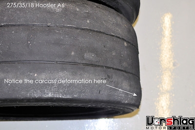

The wheel bearing noise was getting loud in session #1 and sounded like it might be the right front tire, and not the right rear as I had thought? We came in after our 20 minute session and I took a look - tire pressures went up to where they should be but the RF wheel bearing felt tight when I rocked the RF wheel, while it was in the air. I took Amy out with me in A1 session #2 and we didn't make it 100 yards before we knew something was WAY wrong; came right back in after one lap for a better look. Click the video below and you can hear the loud WAH! WAH! WAH! noises above the wind noise, but it was VERY apparent in the car that something was BAD wrong with the TIRE now. Steering wheel was shuddering like mad - and it wasn't the electronic gremlins this time, it was the tire. Sure enough, the RF tire had grown about 3" in diameter on one part of the inside shoulder; it was grossly out of round. This happened during the half hour of down time after I had re-checked hot tire pressures and wiggled the RF wheel bearing immediately after session #1. WTF? Costas :" Oh yea, that tire has popped some cords".
Click either pic above for in-car video and hear the RF tire doing its death howl
The tread looked fine but the carcass of that Hoosier was toast; luckily I had a back-up plan and brought along a pair "vintage" 305/30/18 Hoosier A3S5 autocross tires with a DOT stamping date of 2005... so that's like 7 year old tires. I had used these early on with the E36 LS1 Alpha car, so they were good back then... but "then" was around 2007. Amy and I pulled the Right Front and one Rear wheel off, took them to the MSR "Office Shop", and they swapped on the 305s for us (sure wish I had my Taylor Dunn track vehicle up and running at this point! That was a lot of walking around with wheels and tires). We put these 305s on the back and moved two of the better 275s up front for a non-square set-up. Not ideal, but it was what I had for spare R compound tires in the trailer. Went out in session 2 with Amy riding along again (mistake!). Here's that highlight video...
Click for video from my A1 Session #3...mistakes and all
So I had one warm up lap where I took it pretty easy, trying to scrub the rear tires in - they really did have some OLD rubber that needed to go away. Come around for my first hot lap and got sideways under braking and had a quick off and on. I managed to steer around the curbing and saved the splitter from curbing crash testing, but Amy was still pissed. This was her daily driver, she bemoaned, and "you are never tracking my car again!". Well, crap... so I took it easy for the rest of session #3 but still managed to go 2.2 seconds quicker with the old 305mm rears, running a best lap of 1:47.26 lap. The rear was still a bit loose in high speed corners but it was clear that the car responded quickly after having a wider rear tire... All of you that think I'm crazy for wanting more than a 275mm tire, well, I beg to differ. :) I do wish we had found a trunk in time to make a wing mount (I have a 68" wide CF APR GTC-300 wing sitting here waiting to be mounted to something), as I think it could have gone much quicker with some rear down force.
Left: The RF tire #2 gave its life to the MSR-H gods. Right: The 305 looked right at home
So we came in after she said she had "had enough", checked the tires and found another RF tire that had been destroyed. WTF?! There was only one corner on the track where you really load the RF going clockwise, but it was the fastest turn there. Was it a combination of a bad wheel bearing and this corner? Too much negative camber? Something else? We checked the RF wheel bearing again (it now had some serious resistance when spun - took a lot of force to turn the hub by hand; not good), and the camber (-3°, right where it should be). I think we're done for the day... not going to kill a 3rd tire to maybe squeak out another second or two, if I'm lucky. The higher powered cars at TX2K12 were far quicker than I was going to get to today - Costas GT-1 car had the top spot but some race prepped big power GTRs, a couple of Vipers and Z06s, and a Supra were all several seconds faster than the Mustang. I wasn't going to make the Top 5 Time Trial shootout, so Amy and I mounted the 18x9s and RS-3 Hankooks for the upcoming National Tour on Saturday and loaded up the car.

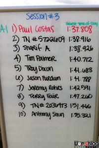

Costas had a pretty good day - his GT-1 car ran great in 3 sessions, putting in more trouble-free laps all day than I've seen that car do in the last few events combined, where I saw it run. He was pushing the car harder each session but taking it pretty easy; he had a small deficit going into the Time Trial but was confident the car had more time in it. Sure, he had an off in session #1 on some older/harder tires, but we gave him sufficient quantities of grief. GT1 Lawn Service, "We cut your grass fast!". It was on FB before he had even un-belted; by the time he had his helmet off there were 3 more "captions" for that pic. ;)
So his GT-1 car, 3 GTRs and a Viper went out for the Time Trial Shootout at the end of the day. 3 hot laps later a GTR was on top - wish we would have had used his helmet/pit radios so he would have known to push it on lap#3. There was some potential blocking by the first place car but he didn't mind and still had a great day - anytime you get to bust off a lot of trouble-free laps in a GT-1 car on 14" wide slicks, its a good day.

We arrived early Saturday morning to walk once again, then I worked the sound meter (busy - couldn't watch the course much), and Amy ran STX-Ladies in heat #2. She made her three runs all within the same tenth: 69.694, 69.649(+1), and a 69.689. Consistent! She was 2.5 sec ahead of the rest of STX-L (3 cars), but her runs looked a bit timid on video and she felt like she left some time out there. Here's her fastest Day 1 run:
Video of Amy's Day 1 Run 3 with an STX-L winning time of 69.689 sec
She drove smoothly and consistently, but after comparing videos and times of our Day 1 runs, we both felt like she was not giving the car enough throttle on corner exit - that's the only thing the Mustang does better than the lighter cars in STX: Accelerate. Play to your strengths.
Before my first runs I was comparing the day's STX car weights. From what I can gather we had a 2650 pound RX8, a 2750 pound E36, 2950-ish pound MZ3 and '08 WRX, and a 3200 pound R32. Our 3500 pound Mustang seems a bit piggish in this flyweight field, and all of those cars except the AWD R32 and WRX can run the same 265mm width tire as the Mustang, and all are considerably narrower. Hey, at least the 1900 pound "STC" Civics finally got booted out of STX, so we weren't looking at a 50% weight handicap anymore. An 800 pound deficit doesn't seem so bad now. Still, on paper the Mustang is pretty outgunned for STX class - duh, that's what everyone has said since the beginning of this crazy plan! But do I ever listen?? No.
The one thing the 5.0 Mustang does have in abundance in STX legal trim is horsepower - about double what the rest of the STX class makes (excluding the turbo cars, which are considerably closer). But we all know that in autocrossing power is the least important thing... but to me its the best part of driving - power management. :D I don't like driving "momentum" cars as much, which is just a nice way of saying "under powered", but that doesn't mean they are slower. They aren't. Driving these cars just doesn't do it for me - maybe I'm wired wrong.
Video of Terry's Day 1 Run 3 with a time of 68.743 sec - good enough for 4th
So on Day 1 heat 3 I strapped in, fired up the vidcam, and went out and drove aggressively on Run 1. Too aggressively; I DNF'd at a gate to avoid plowing over a cone and possibly damaging the factory Mustang Leguna Seca splitter, which so far has only taken glancing hits when Amy has hit a cone or two. I have yet to hit a cone with the splitter installed (knock on wood... err... ABS?), so maybe this $700 plastic protrusion hanging 5" off the front of the car is a good thing for my driving? Fear is a great motivator. I drove a bit cleaner and was quicker on Run 2 and you can see my best Day 1 Run 3 video above, which was a whopping .007 seconds quicker than run #2. WTF? I was driving my ASS off and that's all I could find? Seven lousy thousandths.
Driving that car on that course Saturday was... challenging. Exhilarating? Tiring! When I looked at the times it was more... frustrating. That word pretty much sums up my feelings after 3 runs on Day 1. I was now sitting .748 sec behind Sipe's RX8 (below left), and fell from 2nd to 3rd to 4th place at the end of the day, behind Wilson in the WRX and Roberts in the MZ3. I expected to be trailing the RX8 and maybe even the E36, but I didn't see the other two until it was too late. Ledbetter in the BMW 328is had some quicker times but coned them away and was placed behind me on Day 1, for once.

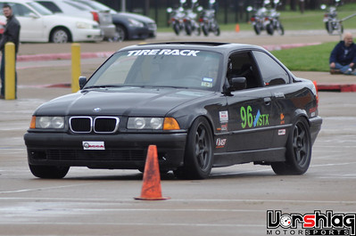

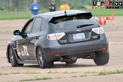

None of STX PAXed well, which must have been course dependent, as the runs I could see looked clean and quick. C Prepared driver Todd Farris (the Divisional Steward who set-up most of the event logistics) took the Top PAX honors for the event in his AST equipped 2nd gen Camaro, which was pretty cool.

So after Day 2 there were some highs and lows, and on the drive home in the truck Amy and I discussed several options for the rest of the year. We were waiting for this National Tour to see where we were and now we know. I felt like I pushed the car to the limits of my driving ability and came up in 3rd place at this event, which to me was another disappointment. But I had lots of people congratulating me for the 3rd place trophy placing, which I guess... was actually an accomplishment? We haven't placed this high in STX open against Nationally competitive drivers before, so after thinking about it for a week I am a bit more encouraged with this car once again - keep hope alive!
Adding up the numbers, having an 800 pound handicap is pretty ugly on paper. Maybe ESP, with a much wider (315mm) and stickier (A6) tire, and much more similar cars in class (heavy Mustangs and Camaros), is a better place to test suspension parts for this S197 chassis Mustang? On the 3+ hour tow back to Dallas I downloaded a new copy of the 2012 Solo rules to the iPad and we made a list of all of the STX legal and ESP legal mods left to do on the car. Everything we had left that's legal for STX was also be legal in ESP, and that list is still sizable. Lots of little things but most importantly - exploiting every rear suspension allowance that we can. This could unleash some badly needed rear grip. I wish I had a team of engineers and mechanics "back at the factory" that could jump right on that, but we really only work on the Mustang when we aren't swamped with customer service work at Vorshlag. Our 2 month work schedule is on a 6' x 4' whiteboard and its pretty full at the moment, but I am putting the Mustang on the board for next month!
ESP vs STX Preparation
Some of the things that are legal in both classes are becoming a higher priority. We really need to make a 2-piece lightweight 14" front rotors, to rid the car of the 25# all steel anchors that are on there now. We could lose 10 pounds of un-sprung and rotating weight from the front rotors alone. I was hesitant to delve into this earlier because it seemed the STAC was about to write another Take-Back ruling and make all brake upgrades have to weigh as much or more than stock, but so far they've held off on this. Our new draftsman has made aluminum brake hats before so we will jump into that project next week and get some hats modeled and machined before they are deemed illegal, as I am not spending $800 on two lightweight front rotors (from Girodisc). I could step down to 13" rotors (as the base GT comes with 13's) and also lighter calipers, but I really like the braking feel and stopping power of the 14" front Brembo 4-pots, on track and in autocrossing, so we'll stick with 14's and the factory Brembo's for now.
The rear suspension bits that have been bouncing around in my skull for over a year have got to be developed and turned into metal, as I am not buying an off-the-shelf Watts link or Torque Arm for this car. The stuff out there for this chassis looks nice, but is either too heavy (bolt-on) and/or made to work with LCA relocation brackets (not STX or ESP legal), so we will make an SCCA-friendly set-up that is lighter and weld-on where needed to save maximum weight.
Some of the ESP legal bits look like FUN, though. Big R compound tires (as big as you want!), 10" tall rear spoiler (rear downforce), and MOAR POWER! The Boss302 intake manifold is a relatively cheap $430 mod (less than a cold air) that adds more top end power (I've seen dyno plots with power peaking over 7K), beyond where this STX legal set-up falls off (6500 rpm). There's all sorts of other Boss 302 and Leguna Seca-specific bits that SP update/backdate rules makes available, but I refuse to remove the A/C from this car (this is still a daily driven car, this is TEXAS and we see some HEAT).
Wheels and tires are the biggest part of differences for ESP, so maybe we show up at a couple of races on the big 315mm Kumho V710s and see how we do? We have the fastest ESP driver in the country right here in town, so that's a good gauge. If we are even remotely close then maybe we go further? We'll see. Right now I'm focused on getting to the rest of the STX legal mods as well as getting the dang Moton Motorsport Doubles that I bought many months ago onto the car. Just have to make the time.

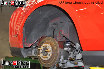

In the days after we got back, AJ here at Vorshlag pulled off the factory center grill mounted foglights, which is both STX and ESP legal. These fogs are plastic so they don't weigh enough to matter, but pulling the LF foglight uncovered the factory engine air inlet, which was stupid of me to keep covered up for all this time. Free Ram Air! Hehehe... Ryan is making a mesh grill covering / deflector for both foglight openings to keep rocks and tire debris from smashing the evap core and he will see if we can extend the inlet to the "cold air" allowed mod a bit. More soon on that.
As soon as we got the car back and unloaded from the trailer we knew we needed to replace the RF wheel hub. The car only has 11K miles but this hub failed prematurely due to installation error back when the ARP long wheel studs were installed 10-12+ months ago. Its a long story but the tech that pulled the hub failed to torque the nut to 340 ft-lbs, and Costas and I fixed it after our first runs ("WHAT ARE THOSE LOUD NOISES!") at an autocross last spring.
The Ford Motorsport kit shown above was the best bargain for wheel hubs + studs and was a perfect solution to our bad wheel bearing issue. It includes two new Timken wheel hub bearing assemblies with new 3" ARP wheel studs already installed. The $230 price wasn't bad considering that's roughly $90 worth of wheel studs and $150 worth of hubs, and it saves us the effort of pressing the short studs out and new ones back in. The kit even comes with new wheel hub nuts, which were torqued properly this time. The RF hub had indeed killed the inner race (parts of it shown above), but the other hub looked fine, so it will be kept in the trailer as a spare.

So after 18 months of ownership we finally pulled the GIANT foglights off of my 2011 Mustang GT that we run in STX (ignore the "STU" markings in the lower left picture - with the new ST classification rules we cannot run this car in STU on wider tires any longer - its STX or nothing; I'm not complaining, just explaining). They don't weigh much, but hey, every little bit helps. Removing them uncovered the factory air inlet for the engine. Doh! That LF fog light has been blocking that opening from day 1, so its never going back on. So this would end up being sort of a "ram air" inlet... MOAR POWER! (just what this car doesn't need)
Now looking into this opening there's going to be more air going in via this hole. How well can I seal this to the air inlet, which is 4-5" behind the foglight opening? I mean, does the allowed "cold air" modification extend into the foglight hole?
14.10 ENGINE AND DRIVETRAIN
C. The air intake system up to, but not including, the engine inlet may be modified or replaced. The engine inlet is the throttle body, carburetor, compressor inlet, or intake manifold, whichever comes first. The existing structure of the car may not be modified for the passage of ducting from the air cleaner to the engine inlet. Holes may be drilled for mounting. Emissions or engine management components in the air intake system, such as a PCV valve, or mass airflow sensor, may not be removed, modified, or replaced, and must retain their original function along the flow path.
Notice the bolded part in 14.10.C above, which is where I am concerned. We are allowed to remove the foglights (via 14.2.C), so can my allowed cold air extend to the opening of the foglight hole? And if so, is drilling a hole to mount the "air horn" an allowed modification? I'd think the wording "Holes may be drilled for mounting" kind of covers that.
My goal is to make some sort of sealed tube that goes into the foglight opening for some sort of "ram air" effect. Again, not critical at autocross speeds but when we're bombing around a big road course at 150mph+ it doesn't hurt. I also want to make a fog light "mesh grill" for both fog light openings, to keep rocks and track debris from smashing into the now uncovered evap core / radiator behind the foglights (this car get's tracked a lot and being sprayed with rocks isn't unheard of) This mesh would be more of a "comfort and convenience" mod, via Stock class rule 13.2.A, and not in any way performance enhancing. Right?
Lastly, when we make the foglight mesh grill covers, for the RF foglight hole I'd like to make a little air deflector to direct air from that opening towards the evap core/radiator as well... but I can't see where that mod is allowed, so if not it won't happen.
Thanks for any rules advice on this one, especially from SEB or STAC members.

TMS Bus Lot was the site for this past weekend's autocross, which is a sealed asphalt lot very similar to Heartland Park. This is the slipperiest lot in all of Dallas/Ft Worth and on top of that there is now highway construction nearby with a 3' tall berm of soil at the southern edge of the lot (behind a concrete barrier that you do NOT want to hit). Add in the heavy rains north Texas has seen of late, washing dirt onto the racing surface, and we had a dirt covered slippery parking lot. You can see the plumes of dirt in the pictures above and we all felt it on about half the surface all day.
STX Class Results
Even though Amy and I ran in ESP, we still watched STX closely since they ran in the same heat as we did, with a large, healthy class that day. You can see the class results cropped out of the total results sheet above and they were quick. Maybe the unusually dirty surface explains the times they ran that day? Cars on treaded tires seemed to do unusually well in the PAX standings (2nd, 4th, 6th, 9th, and 10th), but the STX crew drove their butts off too. Brad Maxcy was about .8 sec back from my 2nd time for most of the day, but he dropped a lot on his 4th run and got within a tenth of my ESP time - yikes! Ledbetter was also in the same second in his STX car in 2nd. AST/Vorshlag equipped cars were also well represented in PAX results, with 1st-5th + 8th-9th of the top ten.
Sipe and his co-driver in the Texas Tour winning RX8 seemed to struggle on this surface, as did the 325is E30 (below). Maybe this was a good day for us to not run STX, as we could have been pretty far down in the standings. ;)
How's it Feel to Have Hoosiers??

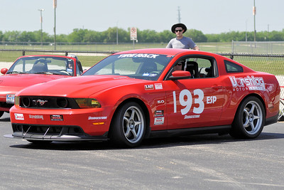

The Mustang on R compounds was A-MAZ-ING! I cannot describe how much more fun and how much EASIER it was to drive this car on sticky race tires, even on this dirty, slick parking lot. It hooked up in 1st at the launch, it was hooked up coming out of corners, it turned and slalomed like it was on rails. And yes.... "Duh!", right? Everyone has been telling me to try ESP in this thing from Day 1, and I have to admit - once you have that R compound needle in the vein, its hard to stop. Kids... Don't do drugs!
We were lazy and left the crappy old Hoosier 275/35/18 A6 fronts and 305/30/18 A3 rears on the 18x10s, replacing the one corded 275 with the last A6 I had left. The A6s were only 2 years old but the A3s were 7 years old, so I wasn't expecting to see miracles. But even so... the car was still pretty quick, PAXed 8th, and compared well relative to other cars on R compounds that day that had solid drivers/well prepped cars, such as: ASP, BSP, CSP and SS (see my class mash-up, below).
So my best run straight timed the quick SS and CSP drivers, but trailed the ASP and BSP winners, which wasn't a huge surprise. I've seen 1-2 seconds gained on the same day just going from 1 year old tires to fresh sticker tires, so how many seconds in bench raced results are 7 year old tires worth? :D Bench racing is fun and all, but next time we'll have the sticker 315s on the car. Next time is the Mineral Wells Pro Solo, where Madderash and Todd Farris are driving the 7 time Nationals winning ESP Firebired. That should be a better gauge for how competitive (or not) this STX car is on R compounds.
Looking at close-up shots of the tires under load it appears we were a bit low on tire pressures, even for this lot. I was guessing and ran 36 psi front, 32 psi rear. I should have been closer to 40 psi from the carcass deformation seen above. This new set-up might need some additional spring rate as well. A real test day with a box full of springs is probably needed.
In-Car Videos + More Race Analysis
The weather was perfect with temps in the 70's to high 80s, breezy and cloudless. We worked 2nd heat and ran 3rd (last heat), so we had the cleanest course of all heats - but it was still pretty dirty. Amy and I both ran in ESP class and alternated driving every 2 runs. She took a rider on her first run and I forgot and left the shocks at full soft, so it was 3 sec slower than her best run. I also noticed that the LF tire had corded on the outer edge by the time she came in after that run, not good. Oh well, we would just have to know it would be pushy and have less grip in right turns - luckily there was only really one big right-hander.
Left: Video of Terry's Run 2 (ESP winning time). Right: Video of Amy's 4th run (2nd in ESP)
So the video from our best runs are linked above. Amy is a bit less aggressive on the throttle but is amazingly smooth (as she always is) and managed to get a 42.2 sec run. That's pretty good considering she was doped up on the same medications that I am now on, since she had this same cold/sinus/whatever thing that day (I started symptoms that night). So, kudos to her for driving well with a splitting headache and coughing fits. My 1st run was a 41.5, my 2nd run (my fastest - fail!) was a 41.0, and I ran 41.1 on 3rd, and a 41.0+1 on my last run. I edited and uploaded video from my 3rd run because the first sector (our region like many others has sector timers) was 0.5 sec quicker than my best run. I had a huge mistake going into the last 2 corners that blew the run - and still almost matched my best time. Combining my best sectors gives me a theoretical 40.6, which would have been 5th in PAX instead of 8th. Meh. I was consistent (running within the same 5 tenths on all 4 runs) but not exactly "Blisteringly Fast".
Watching all 5 of my runs (my 1st look at the course I stopped for a downed cone + errant course worker) I am making lots of mistakes, and mostly driving the car like its still on street tires. I'm not pushing hard enough in slaloms and corners, and I'm tentative on the throttle (paranoid). There's also a front end push in steady state corners that needs to be dialed out (testing/spring rates/square tire set-up?) as well. All of the rear traction issues seem to be completely gone/hidden with 305mm Hoosiers, which wasn't much of a surprise either. The old "R compound crutch"?

After leaving the event our trailer had a blowout on a busy tollway that took out the fender and some aluminum paneling, which kinda sucked. And the trailer had no spare so we made some hasty road-side repairs to remove the bad wheel and limped on 3 wheels to a parking lot of a tire store a few miles away. Stupid not to have a spare or the proper tools to do a trailer tire extraction quickly - mistakes that were all mine. We got there right at 5 pm (closing time) on Sunday, so the only open tire store around had nothing in stock and no way to get the right tire until the next day. This all made for an interesting evening, but we managed to get unhooked and still made our dinner plans (a bit late). On Monday morning returned to the trailer with a pair of new BFG Commercial T/A E-rated truck tires. Now I'm searching for nicer aluminum 16" wheels to replace all 4 steelies with (and turn 2 into spares). Never a dull moment.

That next potential "update" to our car that could come from the Leguna Seca and would be ESP legal is the rear seat delete. I have come up short trying to find out more information about the X-brace, but I did see this entry online today for a "rear seat delete kit" at $149. Its made of wood (bah!) and carpet, so not a copy of the actual OEM Leguna Seca kit. The customer reviews are nearly all bad. Its 40 pounds lighter, which I cannot ignore. This $149 kit would be legal for StreetMod (where you can pull the rear seats in any 4 seat car), but not legal for ESP. To be legal in SP we would need the factory X-brace and the factory rear upholstery bits from the Leguna Seca as well.
Question: Anyone here got a line on the "real" Leguna Seca X-brace and rear upholstery kit? Please send me a PM if you know, thanks.

ESP Rear Spoiler
In my last "quick update" from 4/13/12, I showed a picture of some rear spoiler bracket and element parts we got from a circle track supplier, as well as some machined washers and struts. We didn't use that bracket or the spoiler elements - they were too tall for use on the Mustang trunk. The manufacturer's website didn't have any dimensions so we took a gamble and it didn't pan out. Oh well, the rear support struts and the machined washers were useful. Instead, we made an all new rear spoiler from scratch using some 1/4" thick plexiglass we bought locally and some aluminum sheet we had at the shop. If you haven't been following along, SCCA Street Prepared rules come from pre-historic times and still do not allow a rear wing, only a rear spoiler. It can be as wide as the widest part of the car (excluding side mirrors) and can extend 10" away from the body in any direction.

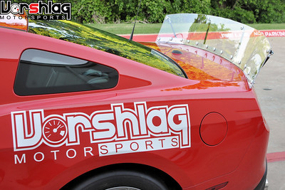

This spoiler was built to fit a spare red Mustang trunk we located a couple of weeks ago - one we weren't afraid to drill into for the ESP-legal rear spoiler or for the upcoming TTS/AI legal rear wing. The trunk was set up on a bench at the same angle as it sits on the car, so it could be built while it was off the car. Some of the scrap aluminum we had at the time was anodized, which made it a royal b!tch and a half to weld to, so it wasn't the artwork-like welds you typically see coming out of our fab shop. No worries - it was strong, worked great at the ProSolo, and was built to an insane deadline in only a day and a half. It looks pretty good for a prototype made out of scrap, but the next one we make will use some virgin aluminum.
The spoiler bracket bolts to the trunk using four "nutserts" installed into the trunk metal with a special rivet gun. The four points are shown above, where the black lower strut supports are placed. This aluminum spoiler bracket extends past the trunk and covers the width of the rear of the car, to about the edge of the sheetmetal. It could be another 4" wider per side (to extend out to the rear fender lips), but we felt this was wide enough to make plenty of rear downforce to match the Leguna Seca front splitter. The lower sections where it overhangs the rear fenders was later trimmed out so it wouldn't rub the paint and some Xpel paint protection film was added to the fenders "just in case".
Once Ryan had the bracket laid out and tacked up, he and the guys made a cardboard template for the spoiler element itself. It is 10" tall and laid back at about a 65° angle. The next step was transferring the template to the plexiglass sheet and carefully cutting that out. There's a trick to cutting plastic with a saw - too fast and it melts back together behind the blade, too slow and it won't cut cleanly. My cheap "one speed" jigsaw (he had to pulse it on-off-on-off) was a nightmare to work with and it eventually burned up the motor after about 40" of cutting. A trip to Lowe's produced a variable speed Bosch jigsaw that worked like a charm and cut the 1/4" plexiglass sheet like butter. Drilling holes in plastic also takes ... patience. They managed to get everything cut and drilled without cracking the plexiglass. The machined washers are placed on both sides of all bolted joints in the plexi and held up after a weekend of ~30 autocross runs.
The plexiglass spoiler element was simply bolted in place - it was flexible enough that it did not need to be heated and bent to follow the curvature of the trunk or the two "bends" at the edges, where it meets the rear fenders. The struts hold the element well enough, but we might go back and mount two tension rods to the widest points of the spoiler, with the rods attaching at the forward edge of the trunk. A little testing (and video aimed at the spoiler at speed) will tell us if that is needed.
The rear spoiler was finished up minutes before the car was loaded into the trailer Thursday night and it definitely got a lot of looks at the ProSolo. This was the first time we'd made a rear spoiler here at Vorshlag and we learned a lot. The guys were very careful during mock-up and construction (lots of painters tape used!), there were only 4 holes drilled for this part and not a single scratch was added elsewhere in the paint. Good stuff.
Bigger Wheels
Another new ESP modification we added were 315/35/18 Kumho V710 R compound tires mounted to Forgestar F14 wheels in 18x11" (front) and 18x12" (rear) sizes. We had been eying Forgestar (a division of iForged) for a while now and decided to give these wheels a try for larger widths like these. We called the guys in California there and they knew about Vorshlag and our Mustang, and our propensity for using big wheels. After speaking with them for a bit, they wanted us to become a dealer. So now we are a Forgestar dealer - if you see anything in their catalog you like, we sell at their MAP price.
They did a super-rush build and made these wheels (from flow-formed/semi-forged blanks they keep in stock) in an extremely short time frame for us. These were machined to our 5x114.3 bolt pattern, hub bore, and backspacing. We have done a ton of testing to see how far we can push wheel widths on this car and we sent them our specs... and no, I'm not sharing those with you. If you want wheels that fit like these, call us and we'll be glad to sell you a set. :) It's the only piece of the puzzle we can hold onto, and we've spent a lot of time and money learning these wheel specs on this chassis.
Even being careful as we measured for backspacing, then calculated offset, we still missed the numbers a hair in the rear and had to add a small spacer. So ... that meant longer wheel studs in the rear were needed. AJ pulled the rear axles out and used our new 30 ton press to remove and install the studs. Now we have ARP long studs on both front and rear axles (and the front/rear studs are different spline diameters and part numbers, so don't just order 20 of one part). All of this final wheel fitting was happening as the spoiler was being built and other race prep work was being performed, all while we had customer cars coming for service and orders were being built and flying out the door. It was a hectic week to say the least.
That final rear spacer tweak got us to this fitment with 11's in the front and 12's in the rear. The front is too tight for 12's under stock contours, hence the 11's, but the rear has the room for a race application (I wouldn't recommend either of the above for a pure street car). I'm very happy with the wheels, which have insane amounts of front brake caliper clearance and a pretty low weight. I will talk more about Forgestar costs and weights in a future post - after we do some more testing on them. They worked flawlessly at the ProSolo and next we'll see how well they do at a banked/high speed track tomorrow - with a NASA time trial at Texas World Speedway.
