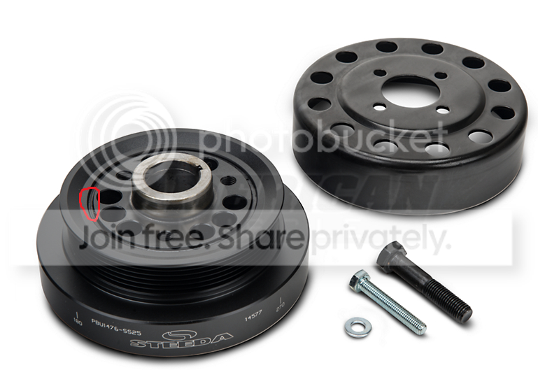

Do you have a picture of the balancer that "looks funny".
Let me get one in the morning. I think it is a Steeda Underdrive. There is a grayish material between the inner and outside metal of the pulley and some of it is coming out. Ill see if I can find a pic online

That's too bad. UDP especially Steeda are a common denominator with broken oil pump gears. If you find the time to collect data like the build clearances and oil used could you send it to me? I've been collecting info on broken gears to get an idea of what the commonalities are with a failure.

Yeah I can do that. Thanks bruce!
