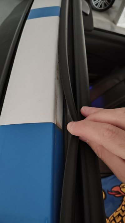

I have checked and cleaned also the drain tubes in the pillars.
I have a doubt.
Here, should the weatherstrip be glued to the frame? Or is it ok like this because it gets pressed and sealed by the roof when sitting on it?

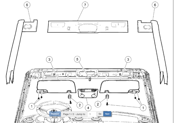

I've found a temporary workaround: remove the dome light, tuck a piece of cloth inside the plastic header trim (7) to the right of the dome, and then reinstall the dome.
This prevents water from reaching the dome and dripping down, but it still collects inside the plastic header trim.
I'm wondering if the water is coming from the right A-pillar (6), possibly seeping in through the windshield...
