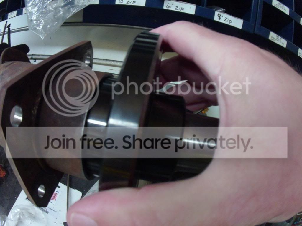

After reading through about 18 pages of the "Please weld your axle tubes..." thread, I just really wanted a single, condensed version of the steps to complete it correctly. I read some posts about heating it up, then doing the weld, then wrapping to cool slowly etc... Is that the gist of it? Any way to make it clearer on what to ask for?
Looking at the pic it looks simple enough, and I bet if I took it to Midas here in town (I've been there several times for exhaust welds etc.) that they'd be able to knock it out quickly... but I'm just not sure if they would have the experience needed to do it "right" with the heating up and cooling down slowly or whatever unless I came in and explained the steps to them. I just don't want corners cut because I don't want my 40k car to end up in a wall at the track.
So can someone explain the exact steps needed to properly weld the axle tubes, so that I can explain the steps to the welder?

My axle with stock HP was not true when I had it welded/braced. They corrected that issue. 4x4 shops often have the right equipment to check true with guys messing up axles.

Anybody can throw a bead on metal, with axle tubes I'd think there is a little more involved like stated above.

May as well have the cheapest place possible do it, the welds can't do much. I wouldn't get huge worms laid all around, either, more chance of pulling the housing out of alignment.

Is it cast? With pipe typically youll want to "quarter" it when you weld it to help keep it as true as possible.
