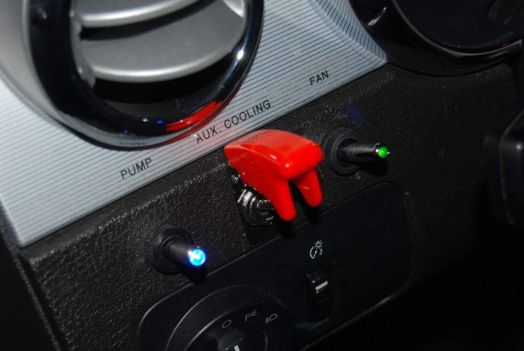

I have mine set up to run when I want with the motor off. The pump along with the fan will allow you to pretty much hot lap it if you want. Takes only a few minutes to cool the motor down and then I would leave the fan on to remove as much excess heat from the rest of the engine bay and prevent heat soak. I used to run about every 15-20 minutes with no drop in times due to heating issues.
That is the normal way the drag cars are setup. At least that's the way we had the SS/AH car setup. The only thing you have to watch with the car not running is the batt. drain. Depending on how long you run one or both you may need to have a charger on the batt while doing this.

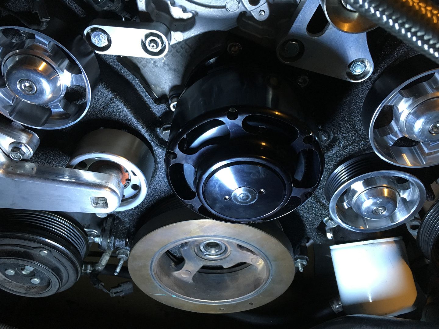

This one.
You can see the pulley is much larger and can accommodate a really wide belt.

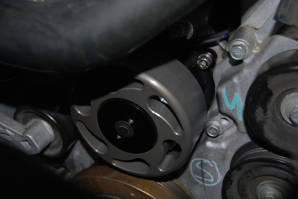

Here is the old one.
Not only is the pulley wider to accommodate larger belts it also has heavier bearings in it.

This one.

Sorry, changed the pic.
I think I got the pulleys from Metco.
Oh I forgot to mention that you need to run the dummy pulley to insure proper belt wrap around the other accessories and pulleys.
