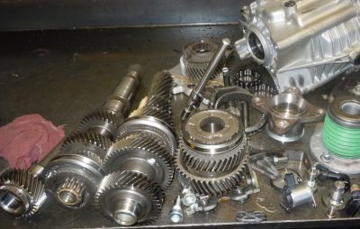

tech said my issue is normal and it's because first gear is a straight cut gear..i smelled BS but took my car home anyway. used up all of the road in front of the dealership when i left the dealership sideways and powershifted to second at 6500 rpm
I smell BS coming from that dealer. GETRAG says they are all synchromeshed helical cut forward gears. I also found a pic of a gear set from a Boss. Pretty sure I don't see any spur gears in this picture. Time for a trip back to the dealer bro.

I fired up the wayback machine to see if I could remember the last straight-cut forward speeds gear box and I'm pretty sure it was the 4 speed in the 3.8 E-type Jag. Do clutches on that and it certainly whined everywhere.
Hell, even 32-35 3-speed Fords were upgraded to helical gears in all forward speeds... over the helical 2-3 and straight cut first/reverse that preceded that setup.
