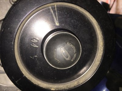

9# now according to the guy I bought bought the car from. Measuring across the outside of the sc pulley on their now it's 4.25" . I know that's not the correct pulley size in SC speak and a pulley vendors website on eBay said you need to remove the belt to get the actual dimension?
Thought there might be an easier way.

With my mods listed in the sig I see 8 psi and some change at 6000 rpm. My pulley is the stock one with the kit. I guess I need to measure it.
Its been a long time since Ive seen a stock Procharger pulley, but IIRC the size is stamped on the back of the pulley.
