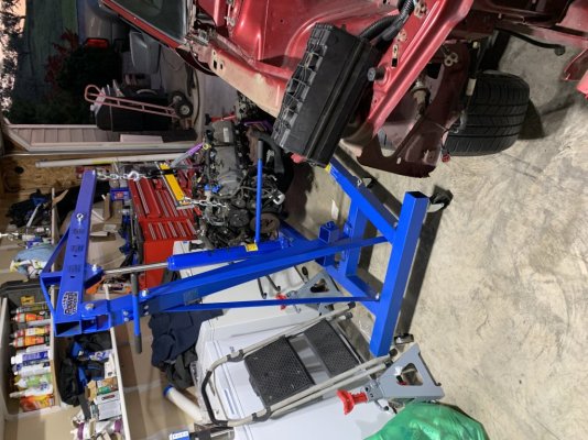

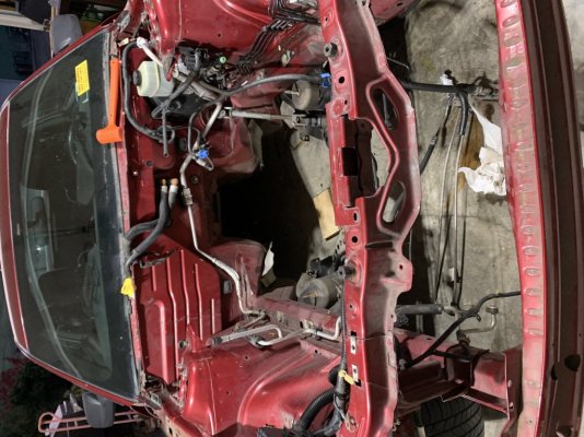

Like the others I used the top transmission holes. I also used the alternator bolt holes. Pics arent very good but here they are. I also used a leveler but it's not necassary.
