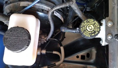

Here's the clutch fluid reservoir installed:
And the stock reservoir with the clutch fluid line still attached :

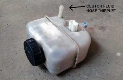

A pic of the stock reservoir with the clutch fluid nipple:
When you remove the clutch fluid line from the stock brake fluid reservoir, leave the reservoir cap fully tightened, since the vacuum with the cap on keeps the leakage from the clutch fluid nipple to a minimum. Once you remove the cap, fluid pours out.

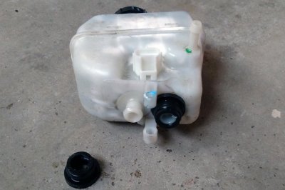

The stock reservoir with the o-rings I'm mentioning:
I had to install the new o-rings in the master cylinder holes first, and then push down the new reservoir.
Trying to push down the reservoir with the o-rings pre-installed on it, the o-rings were getting deformed and not popping into their holes in the master cylinder.

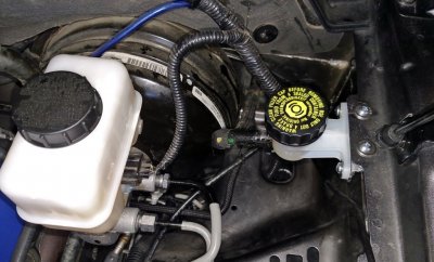

The final set-up:
