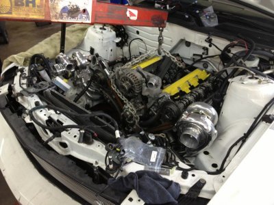

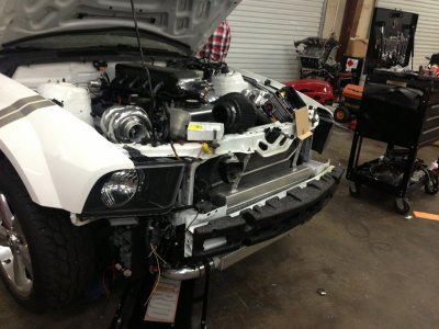

Well guys its slowly, but surely coming together. Hopefully in acouple of weeks we can hit the dyno.

Around 680hp. The car only gave us one good run. The whipple was maxed out and would get crazy hot in the matter of minutes. Then the car decided to spit out a valve and turns out that my cams had too big of a lift and was taking chunks out of my head.
That's the main reason for the rebuild.

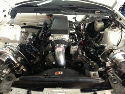

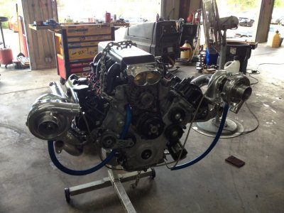

Lol. I'm kinda near Dallas, tx pretty much and I've calm down a lot from my youth with the street racing stuff. Like I said I would really like to get into the Texas mile stuff.

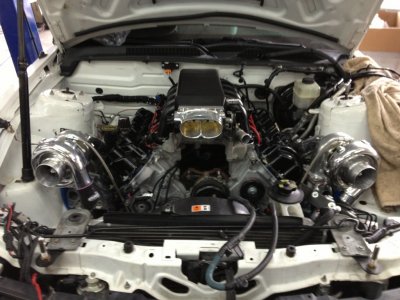

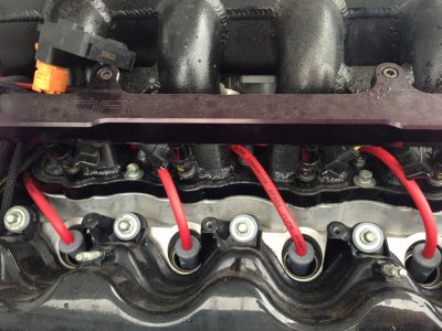

Here's some more pics. The JPC intake with the custom cop bracket for the big stuff 3 is truly a work of art. Very awesome piece.

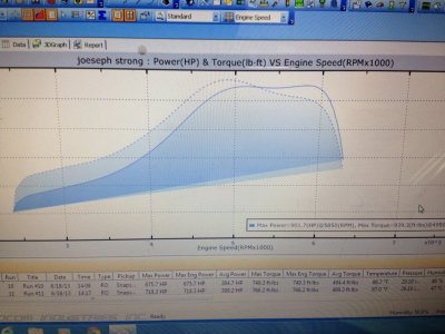

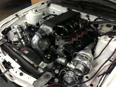

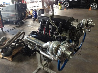

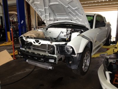

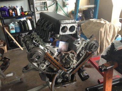

A lot of progress made on the car lately. Had a lot of issues with making the big stuff 3 work right, kept firing on only 6 cylinders on one startup and then fire on 8 randomly. Finally got it worked out.
Car made 901rwhp & 935rwtq on 22lbs.
Here some pics and a dyno sheet.

I'm surprised you still have this thing!
Yea me too. Not going to lie I gave up on it several times.
But after seeing the dyno numbers, I'm glad I kept it.
Ultra ill post more pics with its completely finished. Still need to clean and instal a few things.
