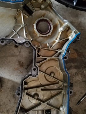

I am chasing an oil leak and I used the stock 3v cover on Ford replacement shortblock. I believe the part number for the shortblock matched up to a mercury mountaineer 4v. Need some new pics or a better description of what is being described in this thread.

Is your current block aluminum or iron? When using a timing cover for an aluminium block on an iron block there's an extra hole under the water pump in the timing cover. There isn't a matching hole in the iron block. So you need to RTV around that extra hole to keep it from leaking.
If you're current block is aluminum and all bolt holes are used then you need to make sure RTV was placed at the seams between the block, timing cover, and valve covers. As well as the seams between the block, timing cover, and oil pan. If those are good I'd guess the gasket itself is bad.

The alu WAP blocks from explorers where 2V and used a 2V cover, this will match the 4V covers too, so I am quite sure he will have the same issue you had if using a 3V cover there.
I am curious now comparing a 3V cover from a 3V explorer that all came with iron blocks.

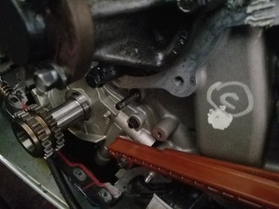

Thank you. I confirmed that the timing cover gasket doesn't line up with the mating surface around the 2nd hole in mustang timing cover. This is a 4v mountaineer alum block. You can see below I started to fill the second hole with grey silicone. Hoping this and a new crank seal fixes my oil leak.
