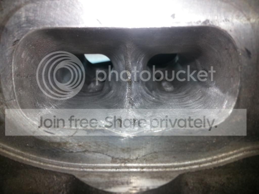

Made a little more progress today, the block is de-burred and oil passages cleaned up. Also ported one cylinder and un-shrouded the valves in it. Came out pretty decent I think...I want to open up around the spark plug a bit more but there doesn't seem to be much to work with there so I'm probably just gonna leave it alone, I don't want to break through!
Now I just have 7 more to go!

I finished the Right head today! Here's a few pics. If all goes well I'll finish the Left side and cc them both this weekend. Then off to the machine shop for a nice valve job and decking. Still waiting on those darn pistons! It's been 2+ months! Supposedly they shipped today, so maybe they'll show up Monday. My cams, springs and lockout's should arrive sometime next week too. The machine shop has about a 2 week backlog, so if all goes well I should have everything ready to assemble early in July. Although I'll be on vacation then so IDK~!

Finally finished the porting work today! Overall I'm pleased how everything came out. Ended up doing a bit more than I originally planned (no surprise there lol!) on the exhaust ports, did some real port work really opened them up quite a bit throughout the short turn and through the exit, while I just did more or less clean up work removing bumps and casting lines, etc. and finally polished out the intakes. My new PAC 1533 springs should come in early next week along with the 2 month back ordered pistons then I can finally drop everything off at the machine shop.

When will the flow test be? Very interested in this.
IDK of anyone local with a flow bench. I'll ask HRE when I drop everything off to them, hopefully sometime this week. They build some pretty serious offshore race boat engines, I bet they either have a flow bench or if not know of someone that does. If & when I get them flowed I'll definitely post the results.
