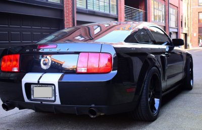

18 x 11 will fit fairly easily with the right offset. 285/35's on 11" end up being 300mm wide, so there's plenty of room for at least 305's. Tire height vs lowering could become a consideration for anything much wider or taller than that. No lowering in the picture below, but the car has been lowered up to about 5/8" at the rear tires with no problems then either. You may need stiffer PHB bushings, though, to limit lateral axle travel due to PHB bushing compression in a corner (poly is OK here, and there is an old-school drag-racer's DIY bushing stiffening trick that I'm using).
full
FWIW, just because a car runs a live axle out back does not mean it can't be made to handle. The S197 Mustang is actually pretty darn good in this respect. I'm not saying you have to turn this into a corner-carver build, just that the assumption that "stick axle cars can't be made to handle any good; you have to have IRS" doesn't know what it's talking about.
This is on street tires (MPSS). Shocks, struts, sta-bars, and rear LCAs upgraded. Still on OE springs at the time. I'm about 50 feet away from going to WOT in 4th gear.

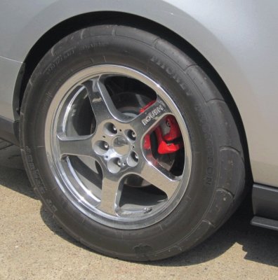

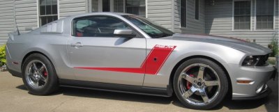

What wheel size are you using or planning on? My daily and track tires are 20" Roush Wheels with 275/35/20 Mickey Thompson Street Comps on all 4 corners. However I also have a brand new set of Firestone Indy 500's the same size to put on. I've been very happy with that setup.
1/4 mile I have 18x10 Roush wheels with 305/45/18 MT ET Streets I throw on the rear. Also run them on the street occasionally for car shows.
That looks stunning, the fitment is not absurdly close to the point of rubbing, I was considering either a 20 or 19 in the front and an 18 in the back. It's not full-blown drag radials, but it definitely has that meaty look to it. That ride height is about what I would do, lowered but still drivable and practical. I can't really judge the offset - maybe it's just the angle of the photo making the wheels look flat, but I would like something with more concavity like an enkei PF07, though those only come in 17 - 19. I think a 19x8.5 front could work with a 18x10 in the back. Still, ur setup is pretty sweet... I might steal it ;)
Oh and whats the clearance on those Big brakes? I'm hesitant to put 19x8.5 on the front because I want to put in bigger brakes, but I also don't want to put in 20s and have a weird brake gap. From what I heard 19" should fit something like a brembo kit.

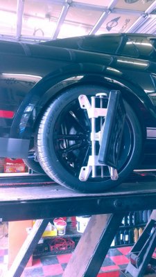

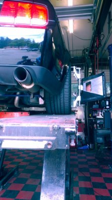

305/35/20 rear tires 20x11 wheels. Car was slammed and no rubbing. 275/40/20 front tire. Not even close to rubbing. These pictures are after I raised it an inch in the rear.
Took these while getting alignment. Sorry for the crap pictures. Phone camera is shot.

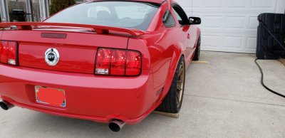

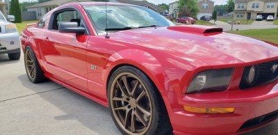

19x10 square setup running 285/35-19. Love it! Cheap ass Ohtsu/Falken tires but they do good!
I'm not sure of the clearance on the brakes, I have Stoptech 4 Piston on the front and no issue with those. If I remember correctly the Roush wheels are +45mm offset, backspacing I don't remember...
20s on a 05-09? when I still had my 05 I considered 20s but I thought it would be too big. How's the ride quality?
The tires that are on it now are all season. They ride better than the Nitto 555's in 18 inch that were on it. That being said, I don't like the way the 20's look on the car. I should have saved a little longer and got Apex 18" wheels. I thought at the time that I would need 20's to clear the brakes. I'm learning now that is not the case.
