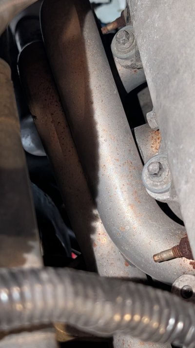

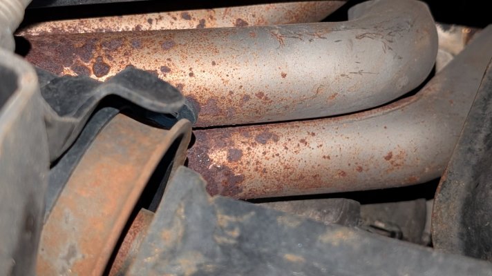

1. It has Long tube headers and is straight piped but I was trying to figure out what brand of headers they could be. I haven't been able to locate a tage but the finish(paint or whatnot) is flaking off. They are a dull silver.

If you can post a picture of the headers, someone may be able to identify them. I don't believe it matters much for tuning purposes though. My tuner never asked what brand mine were, just long tubes: yes or no?

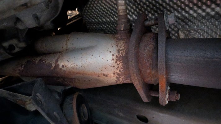

Here is the pic of the headers. The reason I was checking on the type of headers is was it has on off-road x-pipe exhaust and was looking to get possibly a different exhaust that isn't as aggressive.

Those are mild steel headers (definitely not stainless) so I'm gomna guess they're Pacesetter units.
Even the cheap Chinese eBay headers are 304 stainless steel so the ones on the car aren't those.
Pacesetters use a slip-fit connection, not a ball and flange set up.
