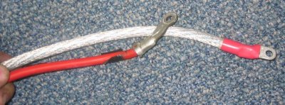

You can't run the stock wire with the 200A alternator, you would probably melt it. Look in the pic below for the difference in size. Considering the wire runs along the fuel rail a wire failure will likely cause an engine fire.
If you are running your battery to the trunk, I would use a 2 gauge wire if you can get it, you can buy it by the foot at a welding supply shop. You need the larger wire for the extra 10 feet you need to run, longer wires run hotter.

^Yeah I'd never try to run just the stock cable with a 200 amp alternator, but I think I'll try to piggyback them.
As for the wire gauge, I don't have a 10' run. I've got the alt cable terminating at a junction block at the fuse box now, which seems to work out well. Thanks for the input.
