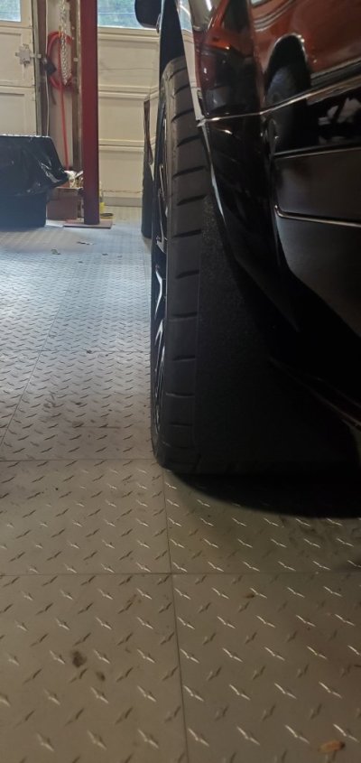

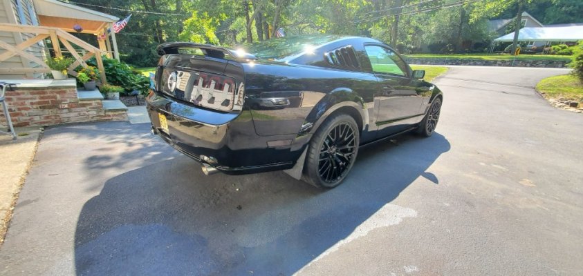

I want to lower my 05 GT, not sure if 1.5 in will cause rubbing. I have 20x10 Performance pack rims with 305/30R20 out back. I was looking at the Ford Performance M5300pa 1in drop springs thinking that would save me a little bit. Anyone got experience with them?1000002082.jpg1000000852.jpg

I run a 305/35/20 which is little over an inch taller on K-springs which is 1.5" lowering, slight rubbing 20x11 with 50mm offset.

Change to the Ford Performance bump stops, if not already done. They reduce the harsh kick when you bottom out (and you do more often than you think)
