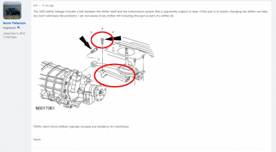

This got me curious, so I did some poking around. Happened upon another forum addressing the same issue, and low and behold, our resident expert had posted some of his expertise! Maybe we can get him to weigh in here too. His thoughts on possible side-to-side wear in the shifter:

That is exactly the piece that I noticed was loose when we were installing the shifter.
