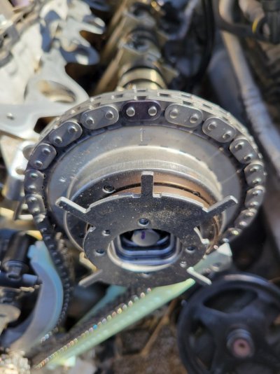

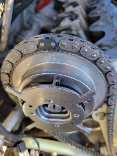

- rain coming, so had to stop. But I put the phasers on the cams and the bolts are finger tight. Installation sheet has quite a bit to say about improper installations damaging the pin. Nice pics and descriptions of the damage in each pic to let you know what you did wrong. A little concerned about getting that wrong. So I slipped one on to see how snug of a fit and looking for a telltale that I have it wrong. Eh....nothing. Nice fit, not loose, not tight. Seats all the way down when you get the pin aligned. How anyone could not get that right, I'll never know. It's like putting your shoes on the wrong feet. Except most people don't put their shoes on with an impact wrench.

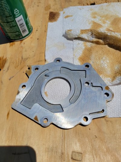

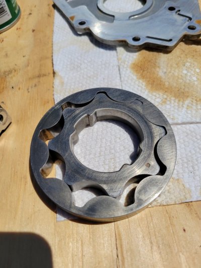

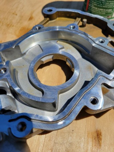

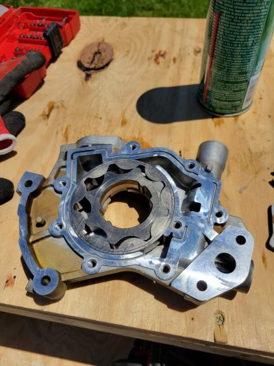

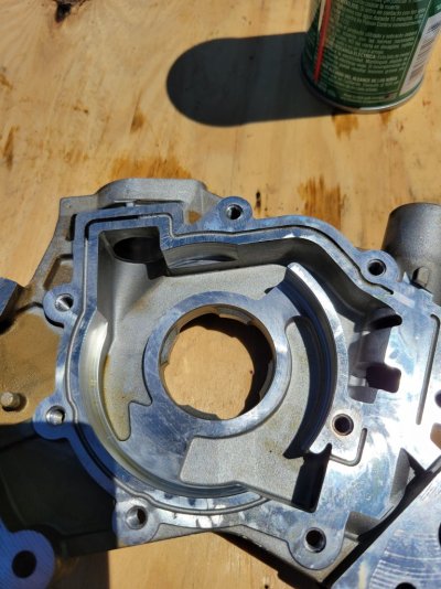

Took the original pump apart. I actually had a lower mileage pump that I stole the spring from, so this is complete and as it came out of the engine. No little pin anywhere to be seen.
Pics of original pump:
20260509_122817.jpg20260509_122822.jpg20260509_122839.jpg20260509_122847.jpg20260509_122850.jpg

Took two 4.6 3V pumps apart, no pins anywhere. I guess I am good. Nothing I have come across has mentioned any pins.

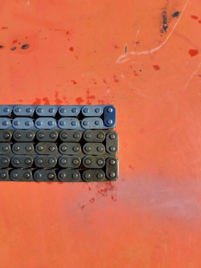

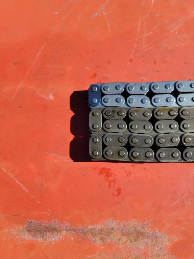

Compared old chains to new one. Slight amount of chain stretch, but not terrible.

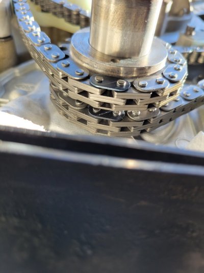

Chains on. Timing marks all lined up.
A word of note.. the crank holding tool that fits over the crank snout and keyway and engages on the down in the block, I have a cheap one. It did not want to go on due to the paint/ powder coating. I had to clean all of it off the inside and then file the little dowel hole until it slid on snugly. Even the keyway slot needed the paint removed and a little filing. Not much and it won't affect anything, but I still had to do it.

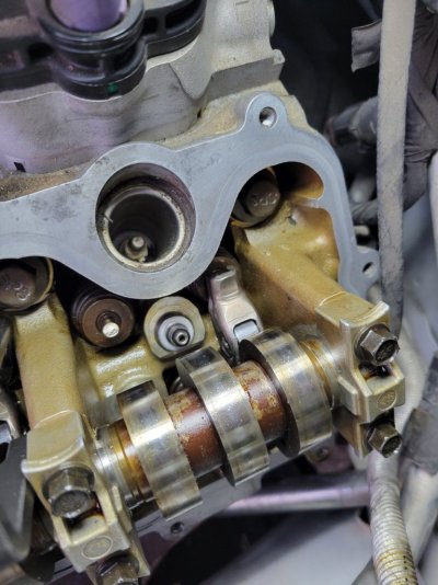

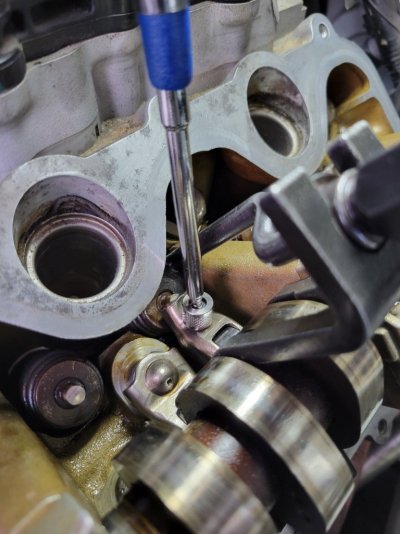

All 24 rockers are in! It was tedious and fussy just as Whitman Ink (and others...) warned me. But I did it!
The finger on top of the valve thing us helpful for two reasons. One is the obvious one, the keepers don't move up and release the valve. Two, use that finger to tell you the valve is compressing. If the knob on the tool is turning but the valve isn’t moving, STOP! Back off and see where the tool is hung up. Knob turns and valve/spring go down is good. Knob turns and valve/spring not moving is bad.
Compress the valve spring as much as you can without increasing effort. That gives you the most room. And no tools! Do not put a wrench on that knob. If you do, now that you've read this, you deserve what happens next!
All the rockers go in from the valve side, not the adjuster side. Try to do the exhaust valves first as you go. They are harder to get in place as they come up from underneath, but without intake rockers next to them, it gives you some room for your fingers. The intakes are much easier since they drop in from above. My magnet worked pretty good at that. See the pic.
Also, if the rockers seem too tight going in, you can gently/slowly depress the plunger on the adjuster to get a little more room.
A little hint...do the very back drivers side intake rocker at the beginning. With the other two out of the way, its easier to get that one in place. Do the exhaust on that cylinder when it comes up as you do others for the same reason and then do the other intake rocker dead last because it will go in easier from above.

Got the new pump in, reinstalled all the timing components, then did all 24 rockers...again. Went much faster this time. It is easier to do when you aren't pulling them straight out of the oil they've been soaking in. They tend to stay in your fingers a little better for some reason.
Did learn a little more finesse with the spring compressor tool. When getting the compressor foot onto the valve retainer, sometimes pulling back and up on the fork gives you just the needed room. It's not much and too far you start over.
You still get the top and threaded part in place then swing the foot in place.
Removal is the reverse, remove the knob, pull back and up slightly on the fork, swing the foot off the valve retainer and out it comes...mostly.

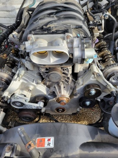

The pic of the pretty new timing cover:

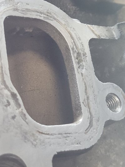

Now, I need to fill in the corrosion voids on the block at the oil filter adapter. One of them falls right in line with the seal on the new revised gasket. Won't take much, but I feel better with something backing that seal.

Maybe JB weld will fill those pores?
That would do it though quick steel epoxy paste cures a lot faster.

It's such a small, shallow spot, but still deep and wide enough to cause an issue with that seal, I want to apply with a razor blade to avoid sanding on that machined seal surface. The thicker putties might be a little too thick and want to just pull off while shaving the surface smooth. The JB I have is the tube type, more workable and 550 degree temp range. Even that might not want to stay.
I may have to deepen the pitting with a dremel to get anything to really stick and not have a lump to sand down.
