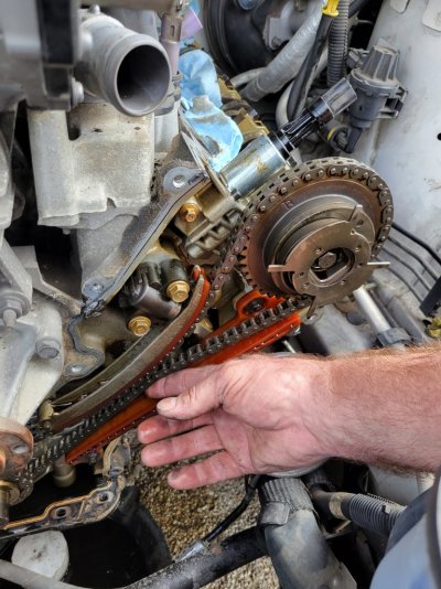

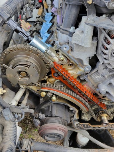

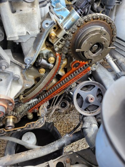

Doesn't look bad for 240k. But I figured ask I'd ask for opinions on the cam lobe. I do have a spare pair of cams that are reasonably low mileage....provided they are the correct oem cams.
I don't see anything tragic. Chains don't seem terribly loose, either.
Passenger side looks much cleaner than drivers side.

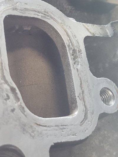

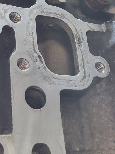

Also, here are pics of the oil filter adapter flange on the block. Notice the corrosion pits:

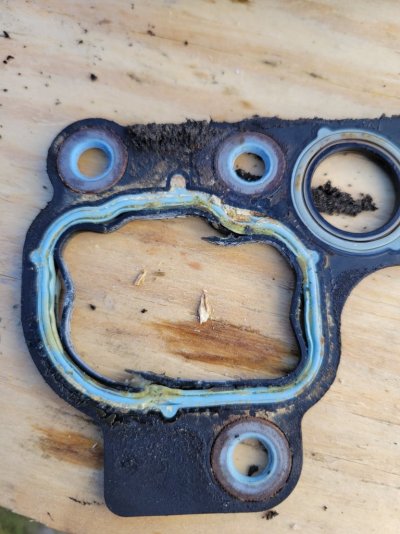

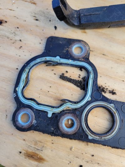

First trick: most definitely replace that oil filter adapter gasket. I could see the seal was in the process of failing. See pic. Drain coolant at radiator and remove upper radiator hose and coolant tank. So much more room than having to fight around it doing the rest of the timing stuff Just using the drain cock on the bottom of the radiator removed enough coolant that I could remove the hose from the oil filter adapter without much coming out at all. I do have the front of the car up on ramps.

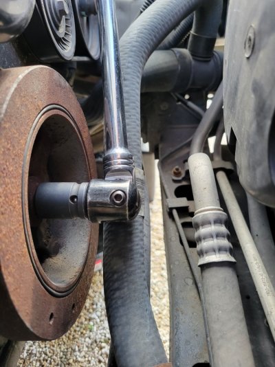

Second trick: break loose the crank pulley bolt before doing anything else. I didn't so I am at a stopping point until I get...

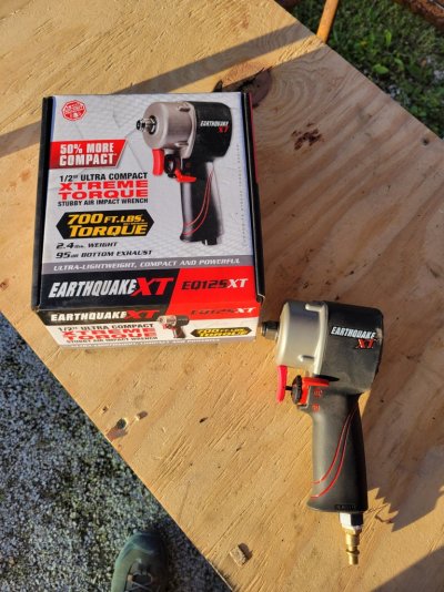

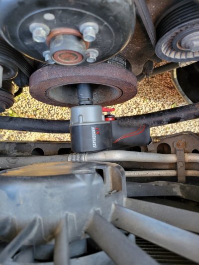

The third trick!: stubby impact wrench from Harbor Freight. I figured I could do it with a long breaker bar, trans in gear and parking brake set. No such luck.
Luckily, my wife has to stop at Walgreens on her way home....exactly directly across the street from HF. You could throw a rock from one to the other.
Fourth....make sure you have the fuel disconnect tool for the fuel line to fuel rail connection.

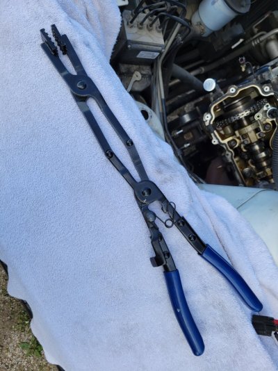

Five: This tool! Hose clamps pliers. Long reach. Best thing ever for the oem clamps....especially on the lower hose to the oil filter adapter housing.
It has a little toothed locking pawl that locks the pliers once you've squeezed the clamp. That part doesn't work so great. But its still waaayyy better than channellocks.

I've watched the Makuloco timing component videos. He does use the stubby impact, but he is working on a truck in the videos. On the Mustang, this is the reason for the stubby impact. There is an a/c line right smack in front of the crank pulley.
In the pic I have a short impact socket.

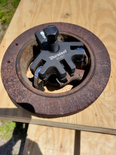

6....Autozone does carry the right type damper pulley that has three hooks that go sideways to catch the flats on the pulley. It's like $65. I have a small three jaw that I'm going to try first.
They also have two different installer tools in the loan a tool program. One has a much stouter jack bolt, but it is longer, the other has a thinner jack bolt with changeable threaded tips. Look at both and decide for yourself.

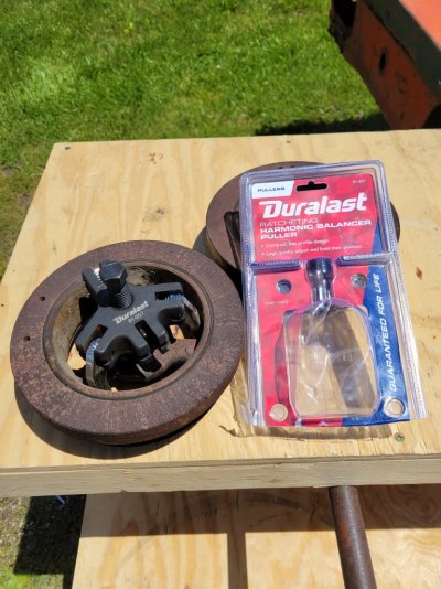

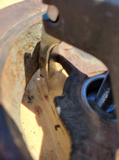

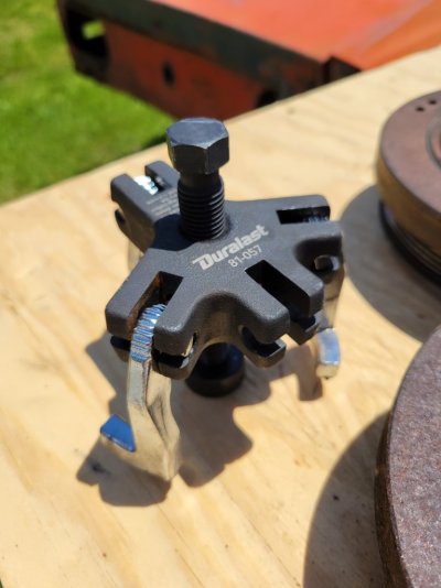

Harmonic balancer pulling....
Standard small three jaw puller is a no go. Maybe if the engine is out of the car where you see everything.
This one worked fairly well. It better for $95. Packaging says its for Ford 5.0 Coyote amongst GM/Chrysler stuff. And 'Misc other three spoke pulleys'.
Anyway, it does work on the 4.6 3v in the Mustang. I have a feeling it may get returned, though....

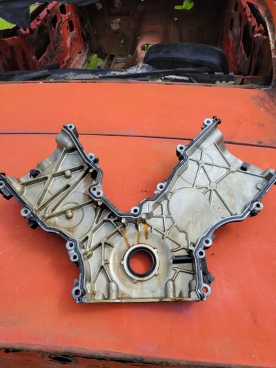

Timing cover off. Pretty clean, no signs of chain wear.
Chain guides not broken as far as I can tell. Passenger side chain is tight, drivers has some slack. Drivers side tensioner is compressed/retracted, failed internally? Passengers is not and doesn't want to compress easily, I guess it hasn't bled down? They do have an internal spring, right? Maybe the drivers side has failed.
