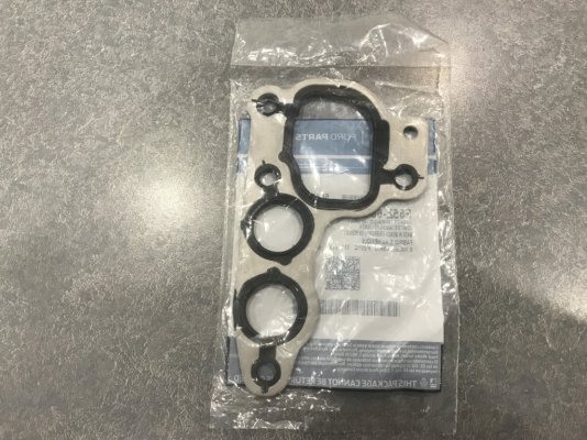

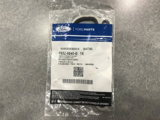

FYI.............this is the 1 you want to get in pictures below. The new revised Ford gasket.........is made from metal instead of plastic.
A gasket set I ordered had two of these for the oil filter housing. I first one I used which looked the best quality and thickest leaked as soon as I put the coolant in, I replaced it with the thinner other one with the red seals I think and it sealed? There was no issues with any other gasket during the engine build. https://www.summitracing.com/parts/MAH-CS5931B I just took it the two gaskets were for different applications or engine blocks?

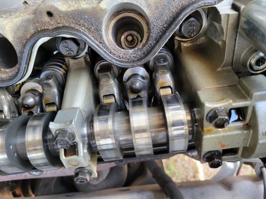

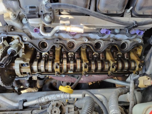

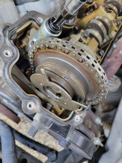

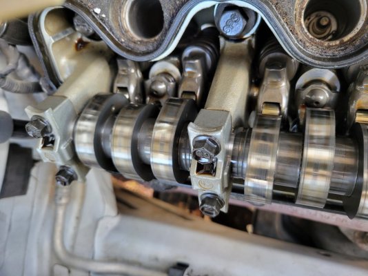

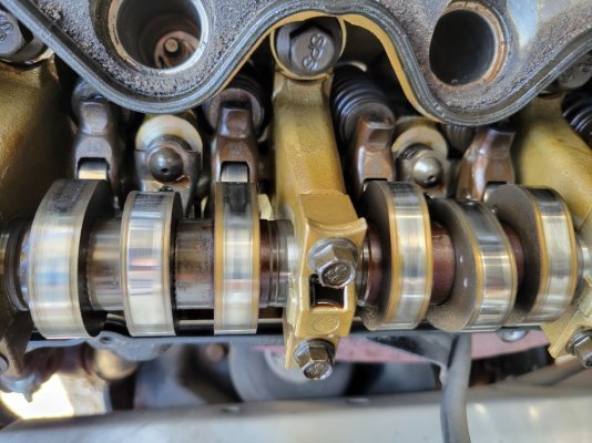

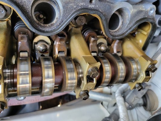

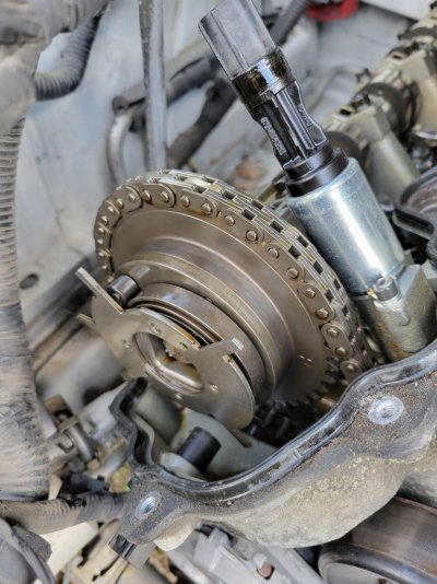

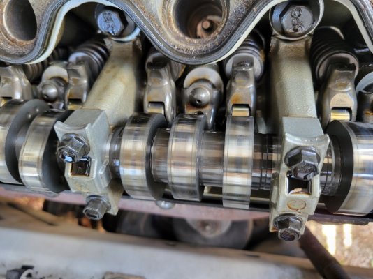

Actually finally working on it. On vacation, but its been rainy.
Cam covers are off:
Passenger side:
