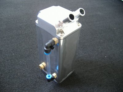

$18 aluminum oil catch can kit

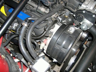

Nice install .. but my understanding is the catch can is supposed to go on the Driver Side valve cover ... not the passenger.
You can run it to either one depending on which one you have piped to your intake. My drivers side is capped off, and my passenger side runs to my supercharger inlet. So it's getting crank case vapor pulled through it at all times, but especially when I'm in higher RPM under boost. I'm considering getting another one for the drivers side and piping it to the intake. The drivers side valve cover has a built in check valve so it'll pull vapor any time I'm in vacuum, but will be closed when I'm under boost.
What is the point of this device?
These motors (modulars) tend to pull a lot of oil particles through the PCV system, the point to this device is to trap those oil particles so they don't get into your intake. Oil in the intake means oil in the cylinders. Burning oil causes poor performance and buildup on pistons and spark plugs. This helps to prevent that.

if you get one, dont get the round one thats super cheap. the fittings on the can are very small and theres not enough room to change it to larger. i bought one and its in the junk drawer. then i got this square can quite a while ago for about $30 from ebay. it has the right size fittings for the larger hose that the stangs have. it comes with the small and large fittings.
it doesnt need media in it. the can works by surface area that collects the old droplets from the vapors. a very small can would be better for a media.

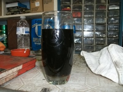

i did a write up but its for a 4.0. very easy install though after ther pcv valve. mine collects alot of oil, i didnt keep good track but i think this beer glass is from around 2 1/2 oil changes(around 7,500 miles)
