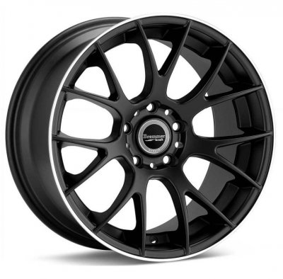

I'm ordering the 19's today.
19x9
45mm offset
25.6 lbs
exact tire size to be determined.
Here's a bigger picture...

Those are friggin SEXY ass wheels brother! I say go 19". 25lbs for a 19" wheel is pretty good.
My wheels are 19x9. I could easily put a 285-35 on there. I'd have to check out the 40 series though. But 275's seem to be just right. Anything above a 285 and it will bulge. 255-35's are just a bit stretched. You can hardly even tell though. I'm running the BFG KDW2 tires and probably will not go with them again. Get too damned noisy over time. They handle awesome on the twisties though and do OK for traction unless you're really getting on it in 1st or 2nd.
I actually think your wheels, which are ASA if I recall, are identical to what I just ordered with a different name and slightly different finish configuration. When you pull up the two on tire rack (which is where I ordered mine) and flip between the two side by side they are the same. I basically bought the saem wheels you have. LOL.
Yes... they are that cool!
I will run 275/40R19 from these choices...
P-Zero All Seasons $188 ish or
Falken PT-722 for $220 ea. or
Hankook Ventus V12 Evo K110 for $192 ish ea.
The first two are 4 wheel rotatable. A plus in my book. The Hankook's are front-rear rotatable.
