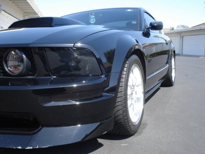

In the attached photos (which I found on a different board) the owner claims these are 275/40R19 Pirellli P-Zero Nero A/S, like I am looking at, on FRPP 19x9 GT500 wheels. Knowing that a 9" wheel is really 10" wide at the outside to outside measurement and that the P-Zero is spec'd at approximately 11" wide with just over 10" of tread width, these do not look right. This looks like a 255 on a 9" or the 275 on a 10" wheel.
This is the look I do not want. This looks stretched to me.
