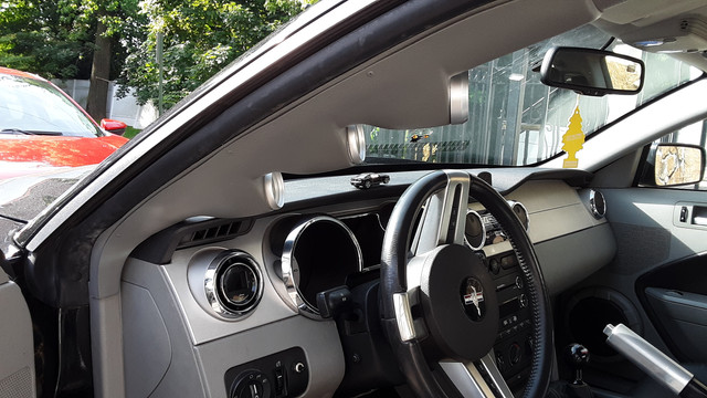

I slapped this autometer triple gauge on after sanding and painting. I managed to fuck up my SOS pillar by trying to add a 3rd pod and it being off enough to piss me off but a triple gauge pod from them is coming out to about $230 now so not digging that right about now. Doesn't look too bad though for $36 lol. kind of a smoother look.

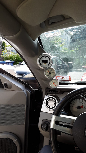

If you run a sandwich adaptor under your oil filter, you can put as much as 4 sensors in it. I have oil temp and oil pressure in mine.
As shown in my pic above, I run oil pressure to its own gauge. The oil temp is run to the Aeroforce (via the analog line you mention) and is one of the parameters I have it cycling through.
