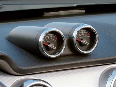

I went with the saleen 2 gauge pod when I added a blower to my car. As for the gauges, I added an Autometer wideband and boost gauge.
(Picture is not of my car, and is not the gauges I went with*)

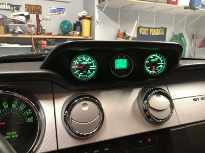

I installed the Ford Boss 302 pod with Autometer Phantom II gauges, white during day to match my Roush gauges but turn charcoal at night.

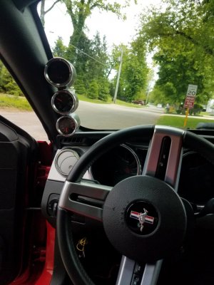

I went speed of sound (SOS) with Speed Hut gauges. A/F gauge is speed huts with the innovative LC1 controller. Bought the DB series because its cheaper than buying the LC1 controller itself plus the sensor. Boost and oil pressure are speed huts as well. They will pair it all up so it works with existing dash lighting or standalone. They provide the inverter, fuse tap needed for the LED lighting. I use velcro sticky strips (soft side) to insert them. They fit very snug in there after that. All three companies are great to work with. Now I still need to finish my install when I have time. I have pics of the whole setup in pieces if you want to see what you get. 20190608_130016.jpg

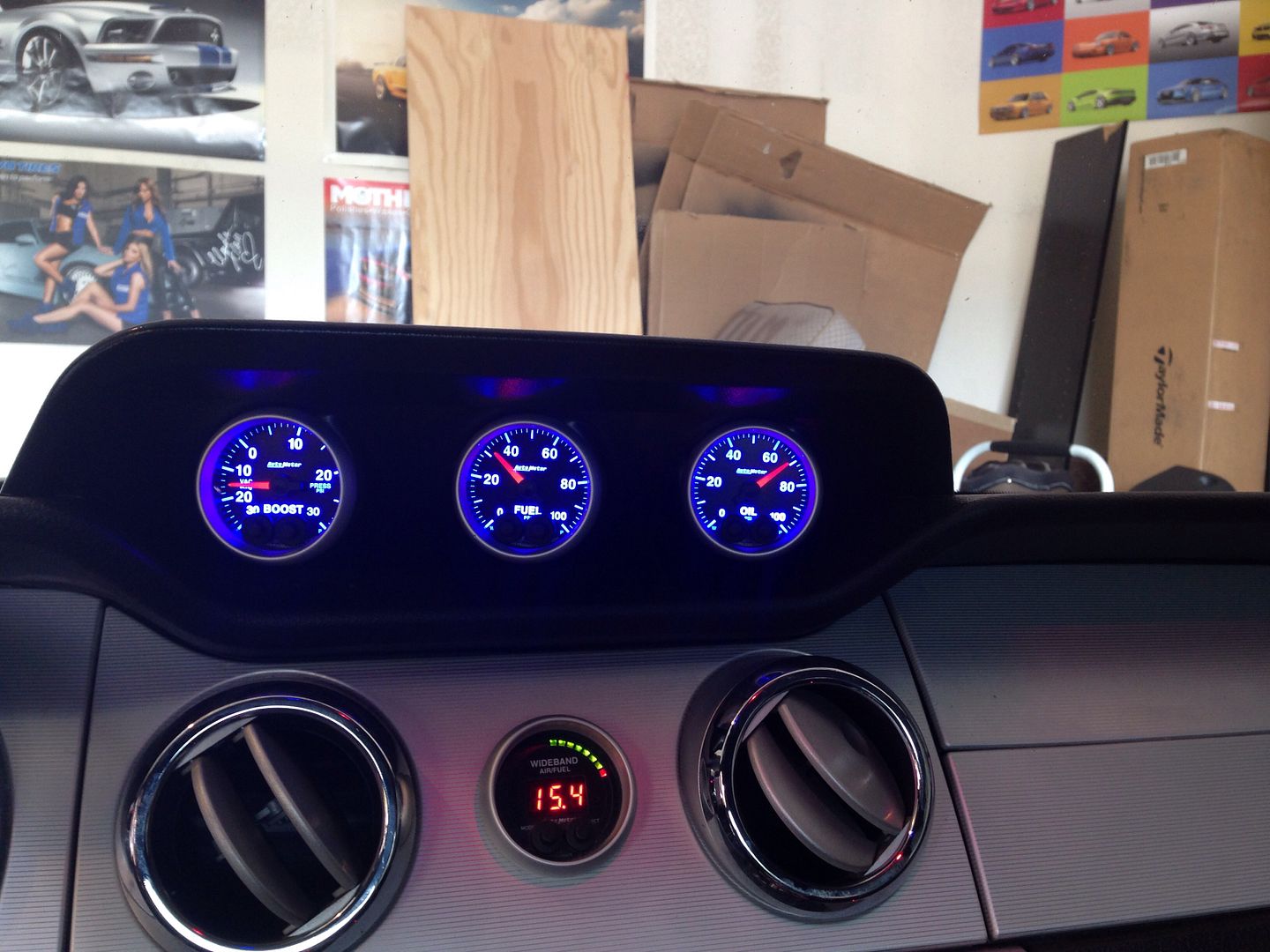

I agree with above that the wideband is very important. I didn’t have it at first but, when I did, I quickly found one of my tunes was lean at WOT.
Running a wideband sensor to the Aeroforce was my choice. Allowed me to see a host of other things too. Put an oil pressure and a boost gauge to either side of it.
Mounted in an Autometer pod. Ignore the crazy values in the pic - that was taken when I first installed and hooked up but before I calibrated everything.
