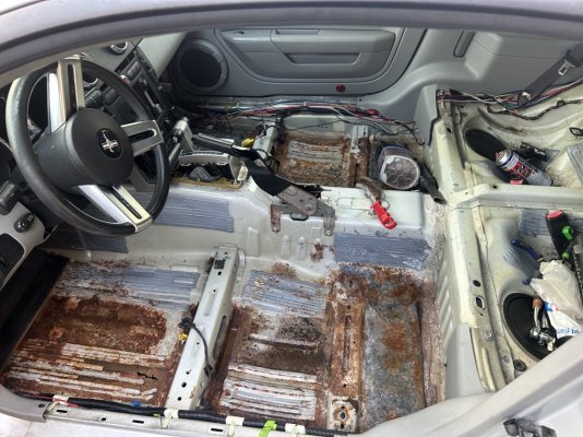

So started noticing a crease on my car floor mat caused by the bottom tip of my foot when my resting my foot on the gas pedal
The only thing in my head I know would cause that is sagging metal.
So pulled up the carpet and only to found the entire floor pan has rotted through
There is actually a few holes in certain spots closer to the clutch pedal.
Was wondering if anyone has ever replaced their floor pan and where can I get the piece?

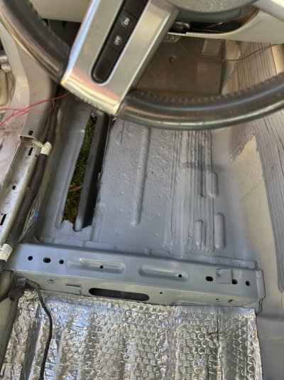

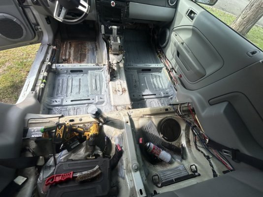

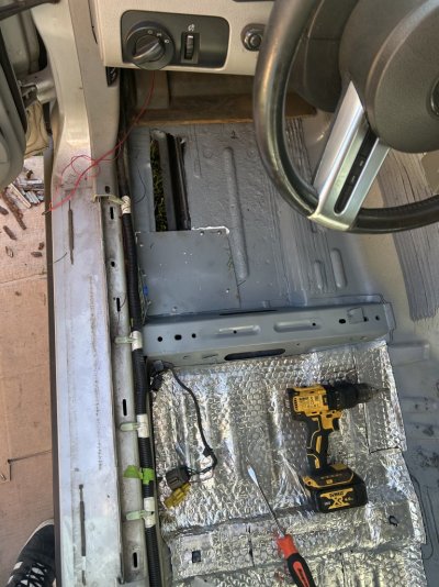

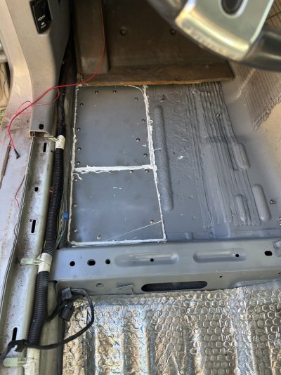

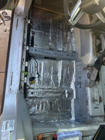

I hope this helps someone !
My drivers side floor pan had rotted through , but the rest of the car was surface rust , it’s lucky I pulled the carpet up when I did, I got wire drill brushes for a fiver and got the car to bare metal (apart from the drivers footwell , and then used rust preventive paint , cut the rot out the drivers footwell and used self tapping metal sheet screws along with an ungodly amount of windscreen adhesive, more rust paint , then sound deadening pads , jobs a gooden , gonna get under the car next week to put under seal on the new metal sheet ! Spent 110 quid on it all together!
18 gauge metal sheet -£20
Rust prevent paint - £10
M3 windscreen adhesive£10
Metal sheet self tappers £10
Sound deadening pads £30
Under carpet wool £20
Carpet adhesive spray £10
Rust hole repaired with no welding , I hope it lasts !
