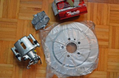

Second try same rotor but fully zinc coated with new power stop calipers and Raybestos street pads. Then third try a brake bleed.

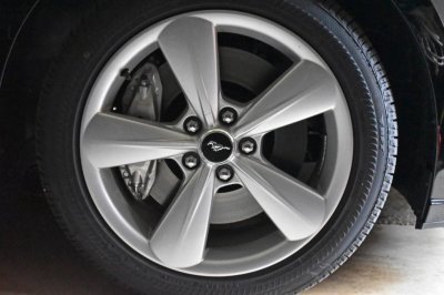

Third try
