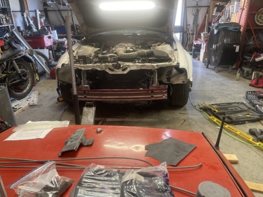

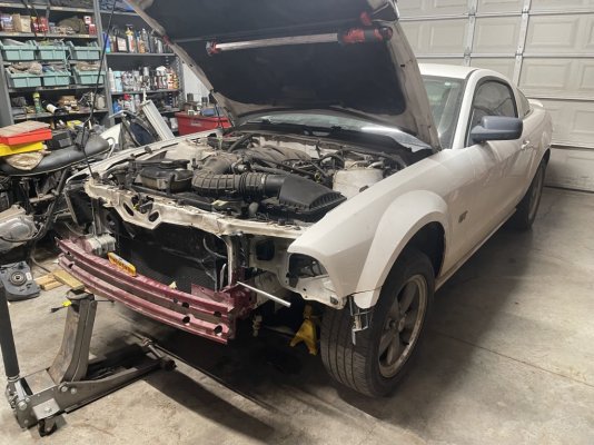

Hello all,

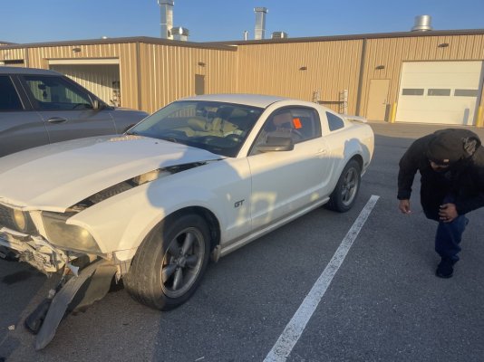

New to me 2005 that I picked up very recently cheap following a mishap on ice by a coworker. He has owned the car since new and decided it was time for a new car.
So far I have taken a couple trips to the wrecking yards in hopes to find parts. I did find a few needed items. Currently I am straightening out the front end, which wasn’t bad really, but it did destroy the impact bar and bent in the frame crumple zone behind the bar. I have cutout the bad section and will be welding a new section in tomorrow. So far it’s been straight forward. No surprises. I am having a hard time finding an airbag for the drivers side. I would delete it, but since it also is the horn push I cannot.
See attached pictures for progress

Anyway, impact bar is welded on after taking 100 measurements. It’s not 100%, 3/16 off in height from right to left. Hopefully the bumper cover and foam will have room to wiggle things a little.

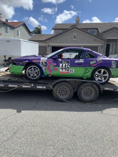

It’s a big job. I changed out the core support on out last race car and ordered it online. You can order all the parts online if you can’t find at the junk yard. It’s a lot of drilling out the old spot welds and rewedding took 2 day will one of my friends. Good luck

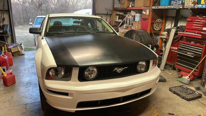

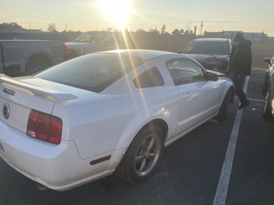

Well, it’s back on the road. Have some hurdles still. There is a healthy clunk in the suspension, narrowed that down to end links. No cruise control as I have not reset the airbag although I did find one. Both wheels up front need balanced as they both threw the balancing weights. I have a purge valve code and a idle lower than expected code. It runs, drives and stops. I have attached a picture of the car as it is now.
