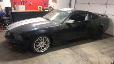

2005 Mustang ProAm build

It's still going! I'm not in a huge rush to sell it, so I'm going to be slowly building it. If someone does offer me a good deal though I'll sell it

Update! Decided to run a bunch of Vegas drift events next season. They decided to model Japanese tracks and run two day fun events so I’m definitely doing those.
Got the sway bars on, lca relocation brackets, removed all of the a/c and lines, got it all aligned now too.
Now just to throw the new fuel pump I have in and save some money for some seats and belts then she’s ready to roll again!

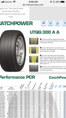

Decided to run these windforce tires for the limited series over the summer. Suuuper cheap and they work great. I’ve ran them on my s13 before and they wear down very evenly and don’t chunk. The tread wear rating is a little high at 300 but at 45$ bucks for a new tire, can’t beat that

Do they come with any warranty or projected mileage? (Thinking about cheap daily tires)
Edit: Where'd you that price?
No idea I’ve havent seen anything though :/.
