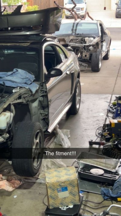

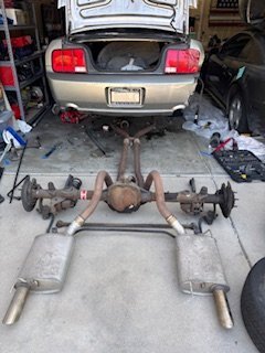

No worries, we chose to swap the rear end partially because we already had the scrap s197. The repair was necessary due to a completely stripped differential pinion but was preferred because of the wider wheelbase. The main challenges were the mounting of the struts and the upper differential mount. We had to weld on brackets to properly mount the new edge struts and use the stock springs from the '02. As for the upper bracket, the 2002 model uses two parts and the s197 only uses one centrally mounted one which we unbolted from the '08 and welded directly onto the frame of the '02 with one main bolt drilled in as well.

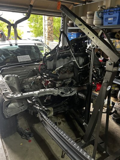

For the front end we are hoping to leave everything stock. From our research the stock GT motor mounts for a 2002 will bolt onto the GT s197 block. It is possible that we will need to replace the K member from the 02 with another 1999-2004 because the car was v6 before this swap. I think rather than replacing the k member we will either adapt the one from the '08 or modify the one in the '02.
As far as our wire problems go, we have decided to attempt a full internal wiring swap. Wish us lots of luck!
I don't have too many pictures, but I will attach what I have and take more later tonight.

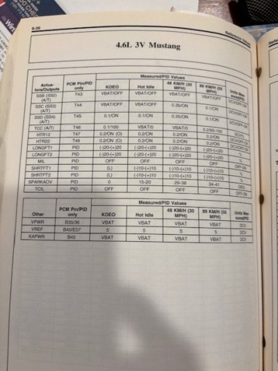

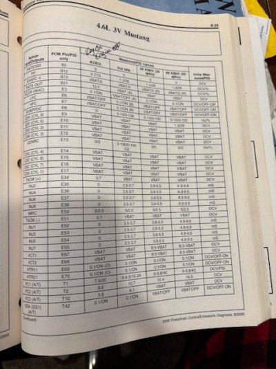

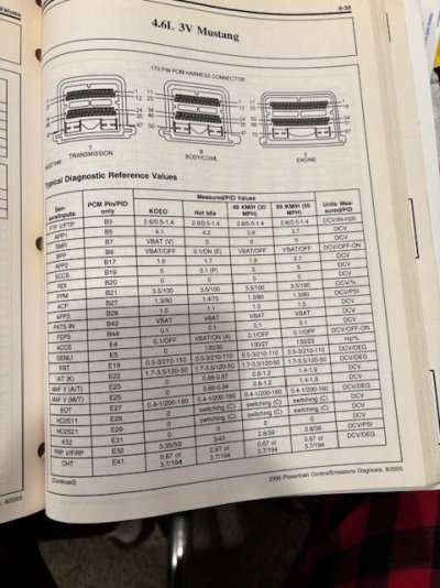

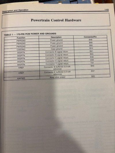

Yeah, you boys are certifiably insane. Those are completely different electrical ECU's and subsystems. My hat's off to you for even attempting it.
Here's an online manual that may help. https://iihs.net/fsm/?d=0
Some terminal ID's are in the PCM manual for C175B under reference values. Here are pics but note these are for a 2006. Don't have 2008. Maybe someone else does.
Best of luck...

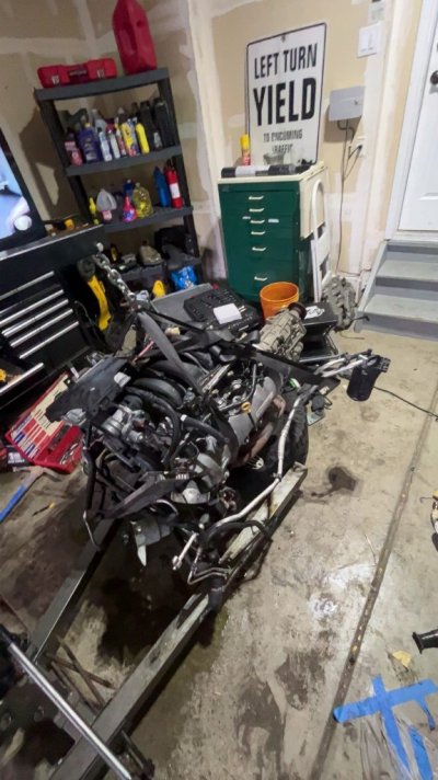

It's been awhile since the last update but a lot of work has been done! The stock motor mounts for a 2V out of the new edge DOES bolt directly onto the 3V block. So, without modification to the K member, the 3V should physically fit into the engine bay.
As far as wiring goes, we decided not to cut it at the engine to body connection and ended up removing the entire interior wiring harness. It will be easier to plug in the s197 harness to the ecu and just wire in the lights to the existing hardware. This means we will be using the s197 fuse box and full wiring harness, i.e. custom routing and excessive modifications.
The biggest foreseeable challenge is wiring the external lighting into the '08 wiring harness, which will probably be more tedious than difficult, as well as splicing connections for the gauges and doors.
The gas pedal from the '08 automatic fits relatively nicely into the same place as the '02 manual, but it will likely need new drilled and tapped holes.
The new goal is to have the first start on August 8th and bring it to the tuning shop to remove the error codes for all the safety features that couldn't be transferred.
