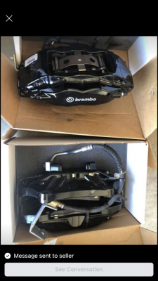

Found a guy selling 2010 gt500 brembo calipers (4 piston) for $325 plus shipping. Is this a decent deal? They have less than 50 miles and look brand new

Did they post pics?
Lots of copies out there that people are passing off as OEM Brembos.
Good news is that the copies are of decent quality
Should I ask for the pic of the back of the caliper to see if they list fomoco or whatever it says? Lol

Those don't have the tell tale casting ear on the front. The top view of the back looks like the s550 calipers though. I'd ask for a pic of the back

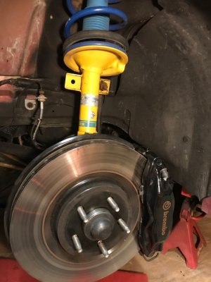

Those are legit. I have the same ones that I’m gonna repaint.

I have Amazon copies from Callahan for at $100 each no core charge and they work great. The Brembo stickers were rather cheap. I got the heat resistant ones. I decided to leave them unpainted.

Those look exactly like the O'Rielly version. If so, you can pick them up for ~$85 ea. Huge difference in stopping power. All I did was add a set of stock GT500 rotors, Hawk pads, braided steel brake lines, hub centric spacers, extended thread lugs and Brembo stickers. All together I think I have around $400 - 450 invested? Well worth it. Have been very pleased with their performance and reliability. Been on for about year now. No issues to date though I don't really go anywhere anymore save quick trips to grocery stores for supplies. The only thing I'd recommend is adding steel braided brake lines front & rear vs rubber.
