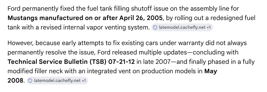

My current GT500 was built on May 27, 2008, so there were no issues with replacing the plugs. When I ordered my 2007 Ford Mustang Roush 427R, which was built in Mar 2007, I installed the BRISK one-piece plug to eliminate the issue when I got the car home from the dealership.

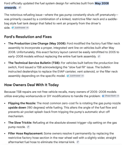

Unrelated, but still an issue I did experience when I owned my 2007 Mustang Roush 427R. Between the plug issue and this fuel tank filling issue, I would not purchase a car built before May 2008 if I ever bought another Mustang. My GT500 doesn't have these issues.
