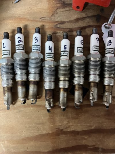

Just pulled out the original(?) plugs from ‘08, but w only 11k miles they came out easy, although one was slightly sticky & required a little back & forth.
My chronic mechanical empathy required blowing out the upper plug boot well, then inserting a 1/4” tube at the end of a hand vac to suck out any debris from the lower plug well before installing the new ones.
I replaced them with these SP547X & a light smear of Permatex nickel anti seize.
