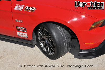

Enkei PF 01s definitely do not fit, the barrel hits. Same goes for American Muscle AMR and SVE Drift wheels both make barrel contact.
19" Ford 302S wheels fit with room to spare and that is what I'm running. Issue is the supply of 19" slick is limited while 18" come in many makes and sizes.
As far as the D Force wheels the clearance issue isn't the center of the caliper but rather the "ears" at the top and bottom, and the interference isn't huge but it is a definite no go.
Steve
Interesting. I only ask because 15" 6 piston stoptechs fit into PF01s, but they definitely cut it close to the barrel. Did you try fitting the 9.5" or 10.5" wheel on the fronts? Hopefully d-force and forgestars can fit on there. Besides the BBS's, the only other 18x10+ that seems to fit is the team dynamics wheel.
