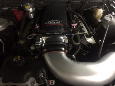

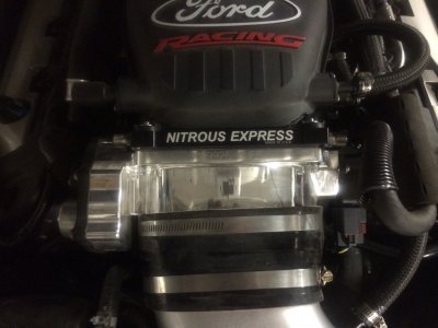

Well I am supposed to have my NX plate today finally(been waiting 6 weeks for it already!)
Since there is no kit for the CJ coyote yet I plan to build one with the best parts I can within reasonable cost.
Here is the plate:
The Nitrous Express GT 500 Nitrous Plate Conversion features a billet nitrous plate that fits between the throttle body and intake making installation quick, simple, and attractive. This part number comes with jetting from 35hp-200hp
Here are the Solenoids:
These are .176 Nitrous Solenoid and .156 Fuel Solenoid
Debating on soft or hardlines from solenoids to plate(I have both)
Going with a -6 feed line and it will be controlled with my NOS launcher system(I already had off my 2011)
With the large NOS solenoid I should be able to get a hard hit on lower bottle pressure.
My car is currently having the converter restalled so once it back(next week sometime) and given NX comes thru with my plate today then I will be fitting it all up next weekend :highfive:
Later this year or early next year I will be putting a built shortblock in the car and this will be one of 2 kits on the car. At that time I plan to have Steve @ IS flow the plate and modify it if necessary to support 400 HP
My goals as is are 100-150 to get me to the 600-630RWHP range(currently I am just shy of 490 RWHP N/A thru auto)
I think with tuning and traction it should net me high 9's in current street weight

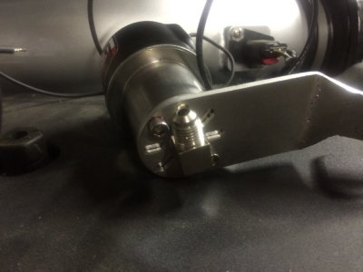

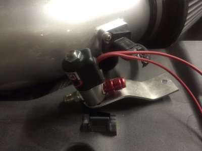

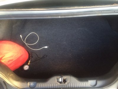

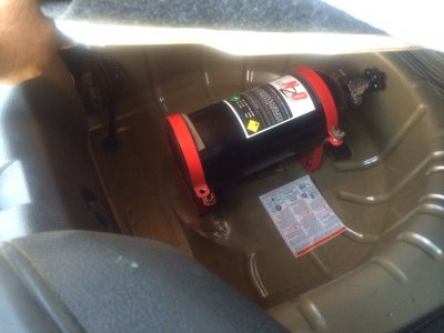

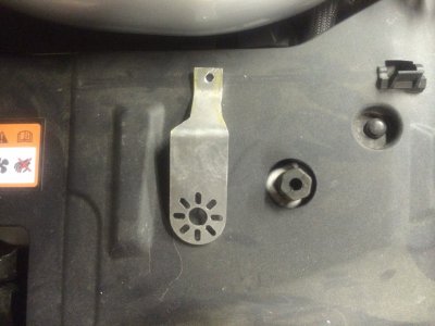

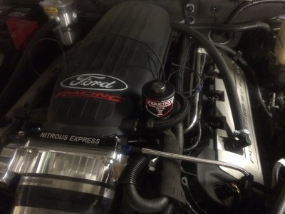

Made a little progress this afternoon
There is no bottle in my trunk ;)
The plate finally
Nitrous Solenoid bracket
90 deg fitting on outlet
Filter on inlet
Trash can solenoid mounted
Fuel solenoid bracket and fitting
Both solenoids mounted

For the truck did you just bang the tire hump flat with a hammer? Doing a battery relocation to the trunk and the hump doesnt allow the battery to sit level.

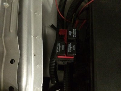

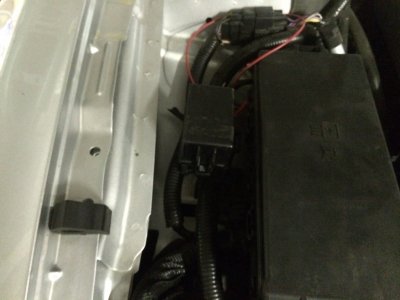

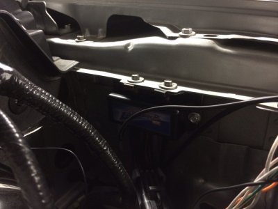

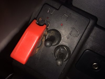

More progress
Made a bracket and mounted my NOS launcher progressive controller
Made use of a Ford relay box and relays to control my nitrous and my transbrake(2-relay brake)
Installed the switch panel I had
In my old 2011 GT
