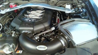

Wayne Worthen
Apr 30, 2020
Interesting video, and I actually have been comparing a stock 2013 Airbox, and a JLT 2 CAI.
I have come to two conclusions so far:
Factory airbox wins for lower temperatures by a small margin.
Both get heatsoaked in traffic and IATs climb.
Last test will be laptimes, stock air box vs cai.

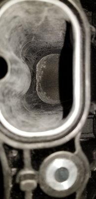

My Airaid race airbox w/home made cover, runs as cold as stock now. Tuned by Mat at Steeda, 2018 manifold ported it myself.My engine bay.jpg 20190622_200855.jpg
