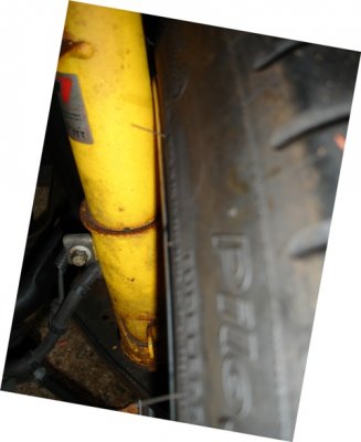

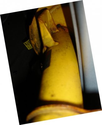

Depends on your experience . . . I happen to think 5 mm is a lot ;)
My current track day setup runs with probably a little less than 1/16" clearance. Before I swapped the FRPP hubs in, I was running down around 0.045" and didn't get any rub until the OE bearings developed a tiny bit of play. Pictures are of the 0.045-ish situation.
You might need a little more than 1/16" because you aren't putting those tires on max-recommended width wheels, and they might deflect a bit further.

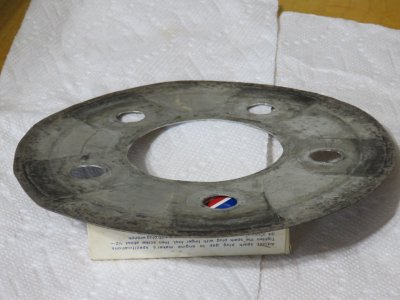

Now if all you need is less than 1 mm to go from a very light tire rub to none at all, the longer studs probably aren't going to be required. But anything that thin most likely means you're going to be making them up yourself (yes, this is entirely do-able; the one shown below is 0.025" thick / about 0.6 mm).

I really don't think you'll need any spacers - even if you're getting 1/8" lateral deflection at the tops of the tires, that's still not going to use up all the room I think you've got up there. However, that's assuming that you aren't using aftermarket "camber bolts" to get a little more negative camber.
Those pics were 18x11's with a different amount of positive offset than +45, and your setup's narrower width moves the inboard flange and tire sidewall outward by more than your bigger +offset pulls them back inward. It's another way of saying your 18x9.5's have less backspacing.
Lowering won't affect strut-side clearance at all.
I showed those tight-clearance pictures to show that you don't need anywhere near the ~10 mm of tire to strut clearances that Ford provided on the GT500. Even 5 mm clearance is more than necessary.
