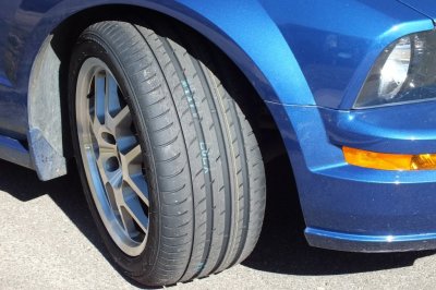

Ok thanks guys, fit just fine.look great! stuck my finger in between the strut and tire up to my first knuckle then matched it to and open end wrench and got 11mm snug. took for test drive sunny out, OAT 45 degrees, couple clover leafs and curvy off ramps. they a little greasy but it is chilly and these are summer tires. they'll do.
thanks again
Those 275/40's must run a bit small - in that picture the tire section width looks smaller than the 255/45's I used to run on the same wheels. You've still got a wider tread, though.
Go mostly easy on them for at least a couple hundred miles. There's probably some mold release stuff to scuff off, and a few mildly to moderately driven heat cycles seems to help with longevity and resistance to chunking on the track.
It'd take a particularly unhappy combination of larger strut diameter and serious chasing of negative camber with camber/crash bolts to get any rubbing against the strut with that wheel & tire combination.
