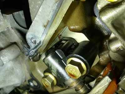

First of all, you need to replace timing chain tensioners, because they cause most of all problems at valvetrain at all. Specially at the passanger side head, because this head get starved from oil first.
Most of all problems with roller followers and lash adjuster are caused by bad tensioners (blown gasket). Yours probably will looks like mine:
