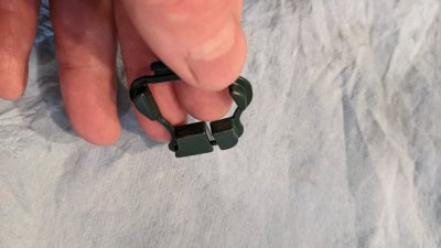

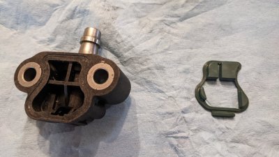

I bought a set of the fel-pro gaskets that they make for the stock plastic tensioners. They look a lot more robust than that thin seal around the stock ones. They fill in the unnecessary cavity in the stockers with solid rubber and are less than $10 from rockauto. PXL_20221021_182127507.jpg PXL_20221021_182107599.jpg PXL_20221021_182154987.jpg
