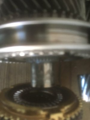

Lastly, that lock ring that holds the small fifth gear on the main shaft is a problem. If it is stretched even the slightest bit they are prone to coming off which allows the small fifth gear to slip down the main shaft. Once slipped, it will shred all the teeth off of both fifth gears and make a mess of your freshly built transmission. I recommend always replacing it once removed.

This started in the what has pissed you off today thread. Last week a .75 cent lock ring failed allowing 5th gears to float against each other and the pic below is the result. I have a spare 3650 I picked up years ago in the junkyard for about $350 bucks. I've been rebuilding and swapping them out ever since using knowledge from this forum. Saved a ton of money. So I scavenged 5th gear out of my spare 3650 and got them in. Still no luck. I'm guessing some metal chards got thrown around and damaged the other gears.

Looks like you are ell on your way! Yes, that clip will break and especially if it has been spread a bit when it was last removed.
