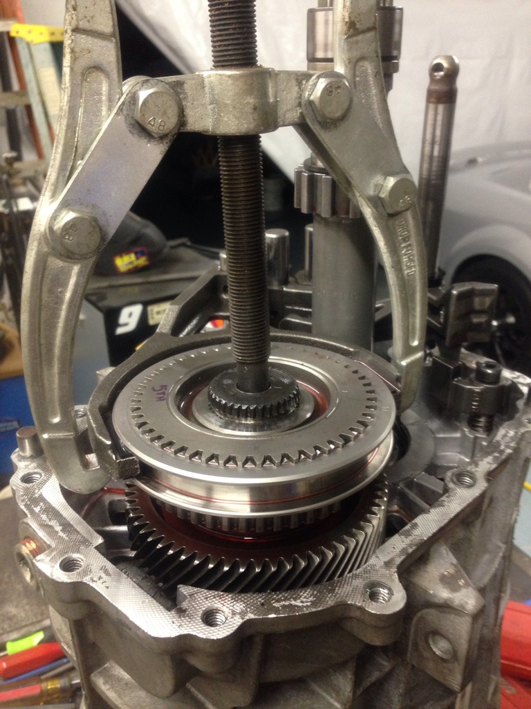

After the tailshaft housing off you have to remove the 5th gear synchronizer cone and assembly off. To do this you will need a 2 lever puller, place one arm on each side of the fork, I didn't want to mess up the threading of the counter shaft so I stuck a bolt and that's what the puller pried on as I tightened it up. While doing this be sure to lift the fork arm at the rail or you will bend a rail while removing this.
After the assembly is off 5th will slide right off and out of your way with the synchro.

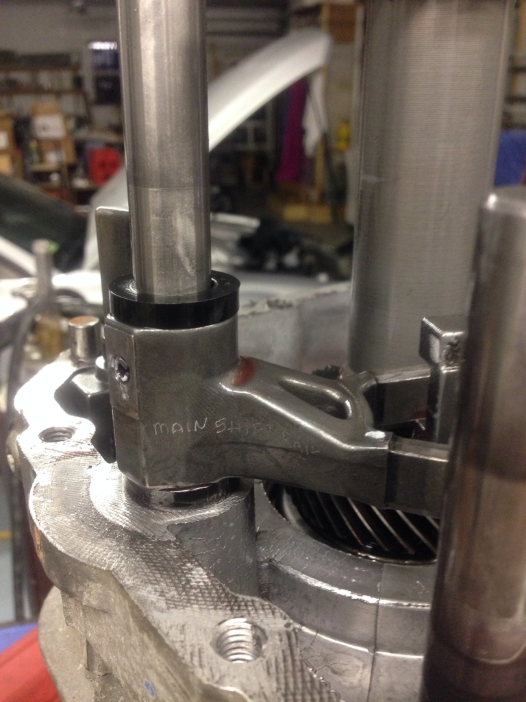

Next is to use a drift/punch to remove the pins holding the shift gates on the rails, remove 5th, 3rd & 4th, 1st & 2nd and then I went back and got the bottom gate off of reverse last.
After the gates are removed, remove the main shift gate, it will slide right out and there will be a plastic spacer/washer on each side as pictured.

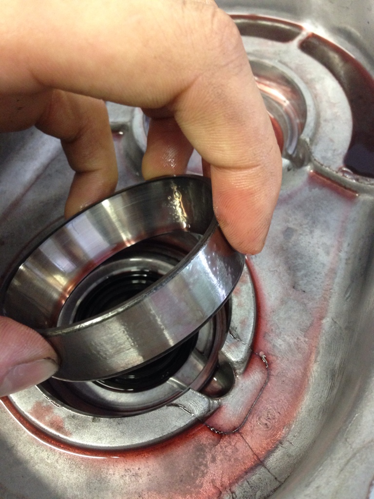

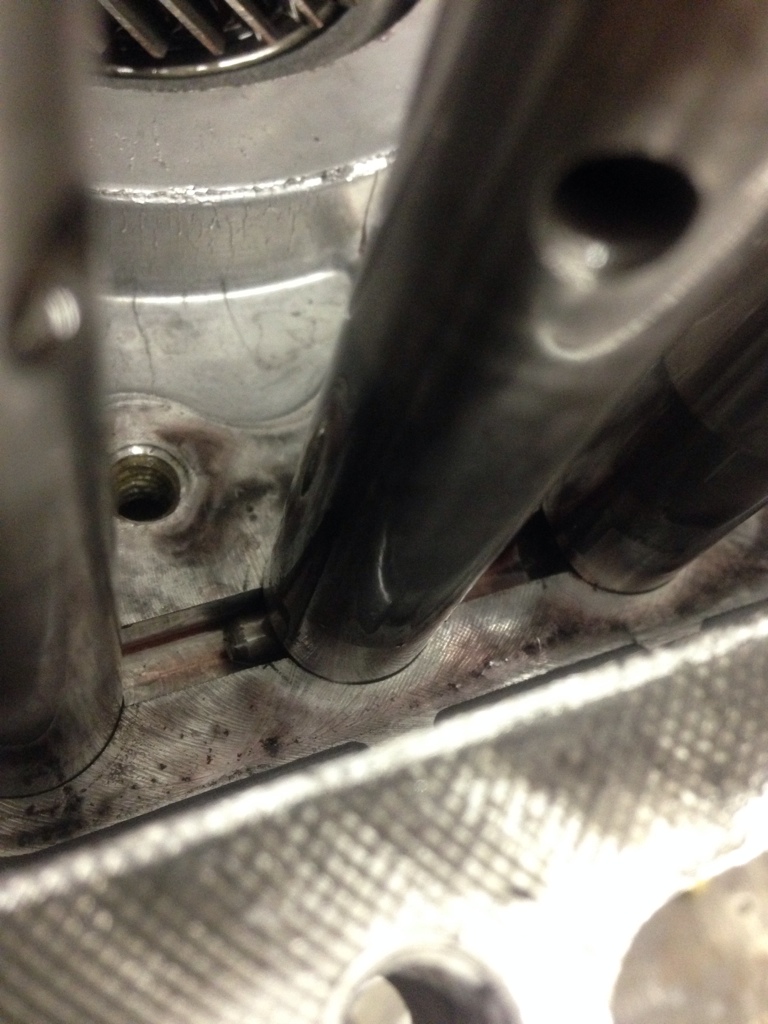

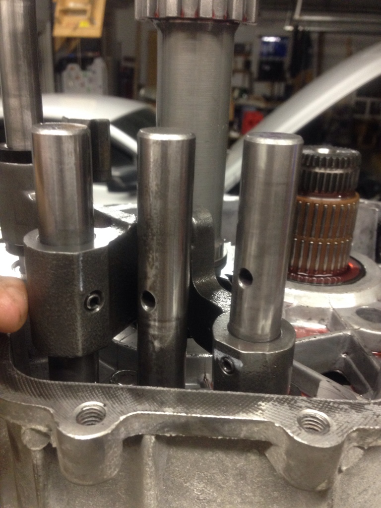

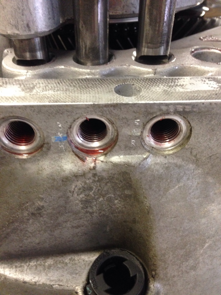

Well today I got to pick up where I left off yesterday in the aid of a buddy who had the correct torx plus bit/socket.
Next step: remove the 3 plugs, behind each plug will be a spring and then a decent. I did not get pictures of them before I bagged them up.
You can now remove the roll pins from the 1st & 2nd, 3rd & 4th and Reverse shift rails/forks.
Once that is complete pull the shift rails up and off the forks, you can now remove all 3 forks, the 1st & 2nd fork is a little tricky, it requires you to move the main shaft a little bit to remove. But everything at this point should move pretty freely.
The main shaft can now be removed, it will not come straight out as the counter shaft gears are in the way, tilt the counter shaft and you should be able to pull the main shaft straight out.
Now the counter shaft can be removed, it will slide straight out.

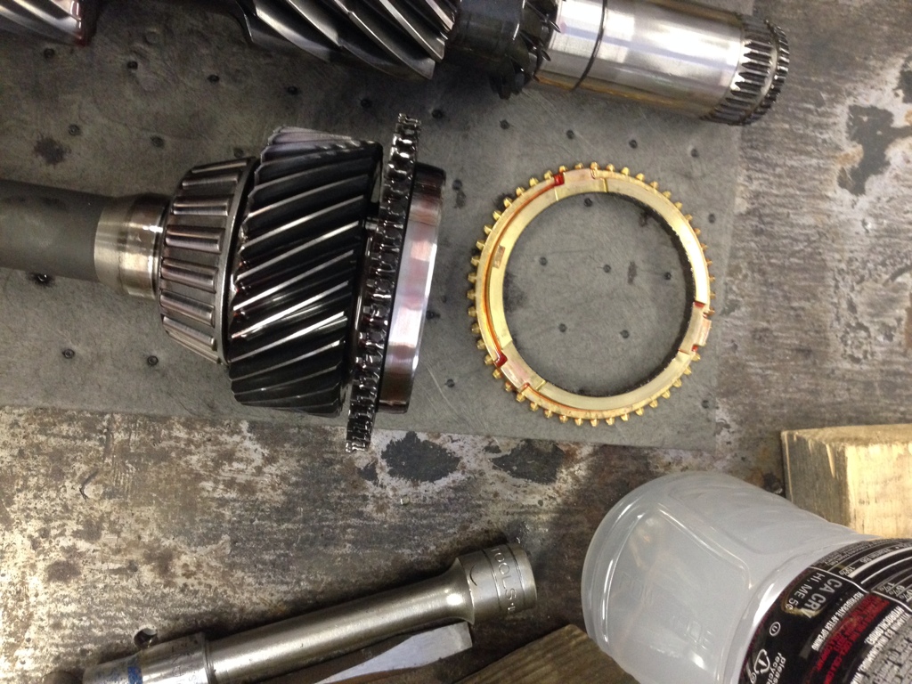

And finally the input shaft will come out and will have the 1st gear synchro blocker ring on it. remove it as well as the axial bearing and input shaft needle bearing.

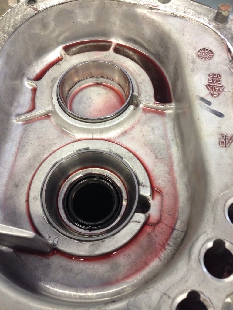

After that is finished, remove the bearing cups from the main shaft and counter shaft out and under neath will be the shims, if you're not replacing the input shaft or anything on the counter shaft record and mark these as they will need to go back into place. I am replacing the the input shaft so I will have to shim the main shaft, since my shim kit came with both sets and sizes I will check for both end plays while I am this far deep in the transmission.
And that completes the initial tear down, I am waiting to get seals before I go any further (as in removing them and then cleaning the bell housing and casing).

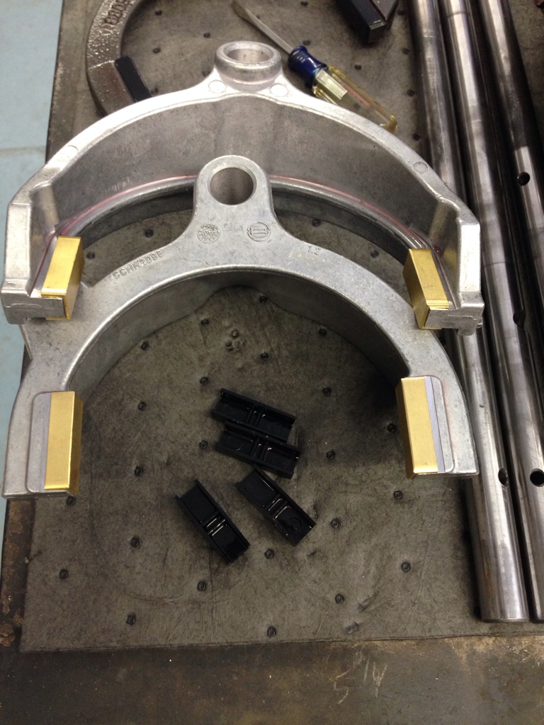

So in the mean time I removed the oem plastic fork pads (use a small flat headed screwdriver and pull up on one side and it will pop off) and replaced them with the bronze pads. This is on the 1st & 2nd and 3rd & 4th forks only. Press the bronze pad on by hand and then I used a delrin faced hammer to tap them into place easily.
