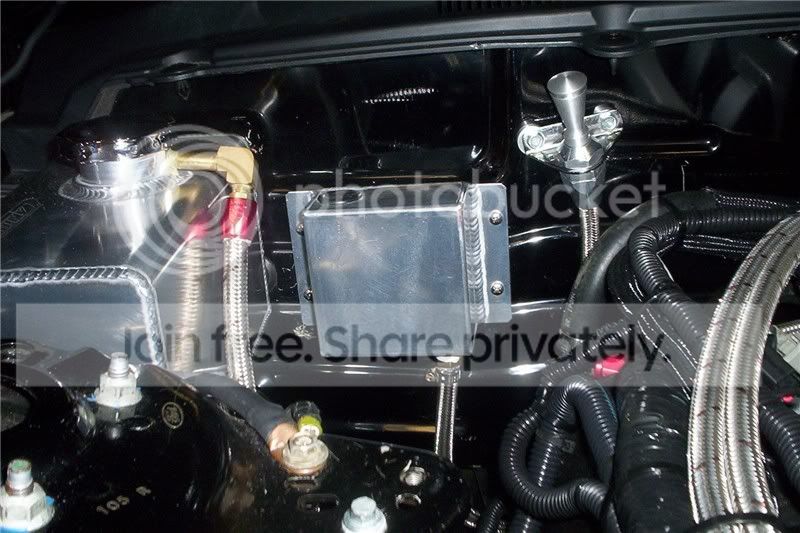

One other thing I chose to do before raising the transmission is to add a breather hose. The 4R70W has a built in breather but I removed the cap from it and added a line and an elbow and ran the line up to my JDM breather box. I had this on the previous setup and wanted to retain it to give lots of room for expansion. The line must be attached before raising the transmission.
Dave got a question for ya are these prone to burping oil out like the 5r's ? I will be doing a aode install in my cobra here soon and already have the jdm can . Basically did you do this because you already had it or because it is something needed ?
I have the stock vent cap on the tranny near the tail housing,it has never burped or farted oil at all out the vent & i drag race it alot.
+1
I have built several of these and have never done anything different. I actually pulled one to swap a converter after 50K hard miles and it had some light grime in a 2" area around the stock vent but was clean elsewhere. No issues.
+1
Sweet thanks fellas I had never heard of them doing it but haven't really talked to any major places like BC of FB etc. about it ....

If I had a can already, I would probably put a fitting with a 1/8" NPT and 1/4" barb in the vent's place, run some hose and use the can... It looks cool, it just really isn't necessary because the vent is tapped into the rear of the trans and the hole is actually in the tail shaft housing cavity, it would be hard for fluid to get out.

I happen to see this in updated threads so for some reason I am not getting updates to my own thread lol...I put a hose on the top vent tube with a clamp and ran it to the jdm can. Generally dont need a can BUT if you ever put a diaper on it then it can get real hot fast and on my 02 car pukes out so I put the can. The other thing is if you do not have a deep pan on a 55R5 you can use this pan to fill the tranny. Pull the lower plug and fill away. When it runs out its full. Works good for a stock pan which is when I originally put it on.
