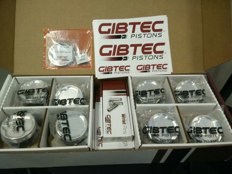

Contact Gibtec Pistons in Denver, CO. 303-243-3340 Ask for Nick. They can make you custom billet pistons in any CR you want, ANY size you want, any configuration you want, etc.... Just name it they can do it. For example, If your block only needs a hone they can build a piston to fit it exactly, down to . 001 increments, rather than you having to go 10, 20, or 30 over.
Set if 8 should run you about $1k... (including Total Seal rings and .200 wall pins) Could be higher as you start adding ceramic top coatings, coated skirts, offset pins, anti-flutter grooves, etc.

Those look nice, might have to weigh paying some extra money for a custom piece over an off the shelf piston
Havent gotten a block yet, would like to keep the stock bore but not sure what kinda shape a seasoned 5.4 iron block might be in
