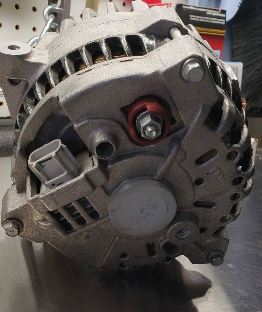

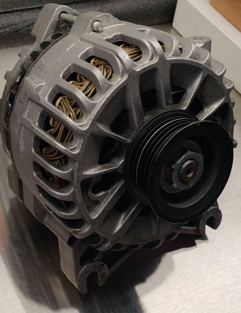

I bought mine at O'Reilly's auto parts store and haven't had an issue since ( Ultima brand). They carry a lifetime warranty, so if it craps out I get a brand new one ( not a rebuild)....easy enough to change, so I decided to go that route. Good luck.
This right here. Bought a warrantied alternator for a 2010 GT, drilled out the main post ring terminal and reclocked the housing to make it work, super easy.
