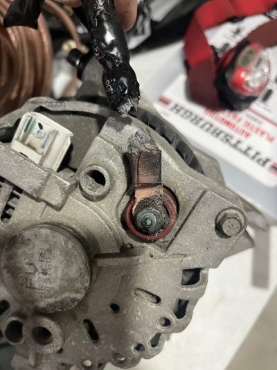

Looks like I’m gonna have to replace the alternator on my 2006 Roush….which one should I get? Prob need the 200amp….adding stereo system.

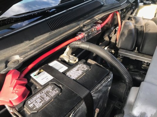

I have one in a box, ready to go on. Make sure you upgrade the alternator-to-battery wire, for a 200A. Engine bay fires are no joke. This is the one I went with:
Yeah I’ve been looking at that. I’ve already ran a 4awg from the alt to the batt when I had the motor out but noticed that ones fused. I didn’t fuse the one I did bcz it wasn’t fused from the factory. I don’t really understand the fuse location with that kit, I’d think it’d be closer to the Alt than the battery…? Still been thinking about it, used some power wire from my sound system install, dunno if it’s a different type of wire..?

I used a 4awg wire designed to power amplifiers. I’m assuming those little strands of copper couldn’t handle it. Maybe it was the heat and that type of wire. I reinstalled the factory wire with the stock alternator and am now getting 13v at idle. Figure I’ll order the wire upgrade kit from American Muscle and throw the new alternator in in a couple of weeks

Buy a new set of OEM battery cables. The fact that you're only seeing 13vdc at idle tells you they need to be replaced. You can still get them on feebay and perhaps some dealers but they're becoming scarce these days.

I use a custom 200AMP High Output Alternator with 4-gauge power wire with in-line 250AMP fuse.
