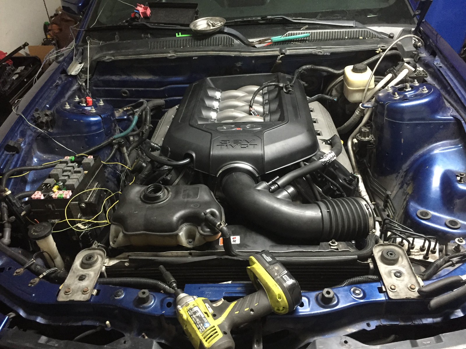

Got some more finished tonight. We will be hitting the wiring pretty hard tomorrow night. Just waiting for the clutch and a few odds and ends to show up to finish everything. Fuel system goes in next week, and will hopefully be running by this time next week. The Blowfish bracket is really a nice piece. Thanks again to Steve @ Blowfish for making such a cool piece!

Just need to finish:
-cooling system
-fuel system
-running PS lines
-clutch/reinstall trans
-finish up a little bit of wiring
The car should *hopefully* be running again before next weekend. Unfortunately, I won't be able to work on the car at all this weekend. Most things that need to be done are very quick and easy jobs. I'm hoping Monday I will be able to do the clutch and either cooling or PS. Maybe all 3, depending on how beat I am when I get home.

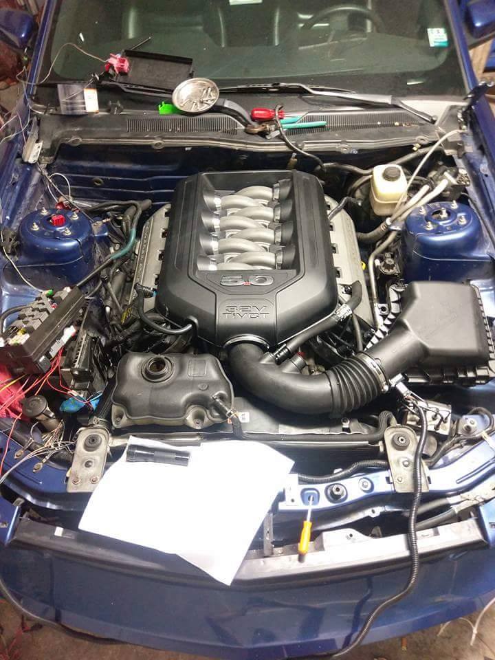

Transmission is in the car, most of the wiring is done. Fuel system goes in tomorrow, hopefully the wiring will be finished, PS lines will be run and the car should be ready to start.

PCM has it's own power and is communicating! I didn't get as much done last night as I hoped to, but I will definitely be knocking more out tonight. My drill bits were getting worked by the fuel hat, so it had to come into work today. The exhaust also had to come in for welding. O2 sensors need to be wired still, but I think thats it aside from double checking all the other wiring.

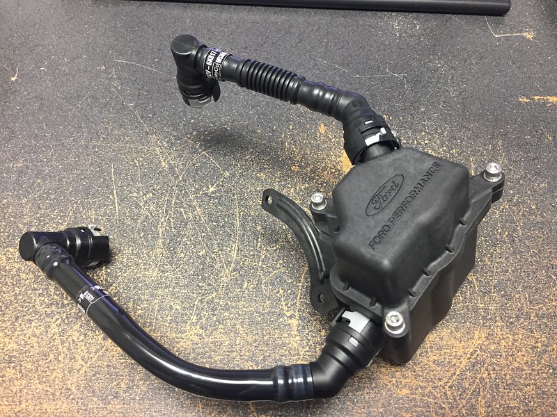

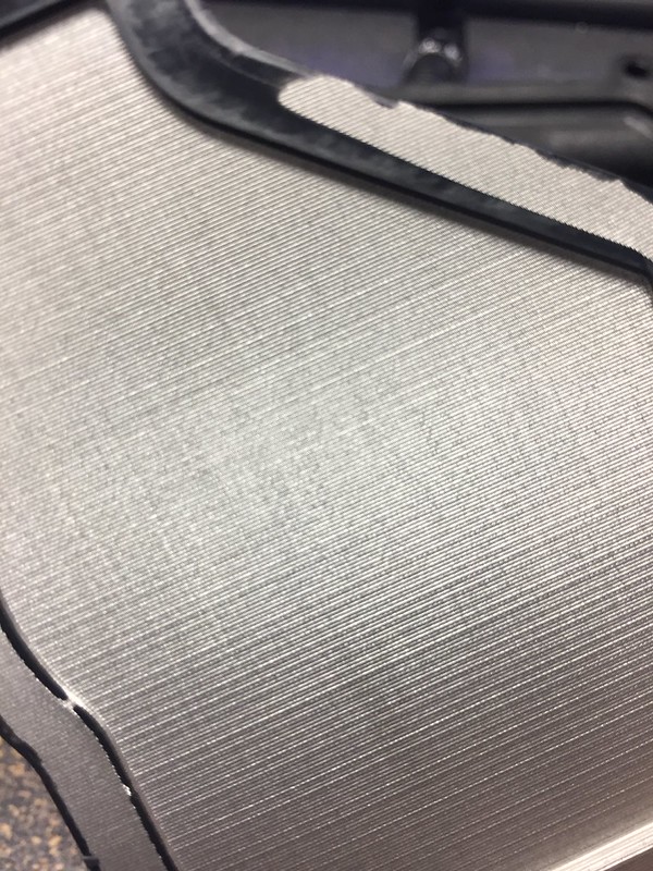

Fuel pump hat is done, exhaust is welded, and this showed up! Hopefully it will fit with all the other junk hanging off the Coyote. Alternator placement has me a little worried.
Dat filter media. I decided I wanted to give this a shot vs trying to find a place for my Bob's can. Even more parts are stacking up that will be going up for sale.
